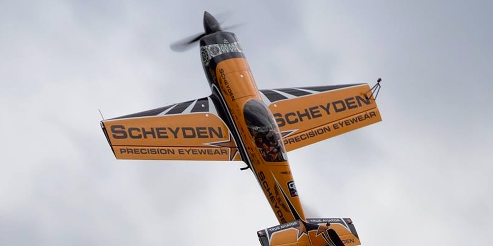

Cool! After you finish with this experiment you'll have to try the "offset" hinging like we talked about. This is the Sukhoi pic where you can see through the gap on the left wing with the aileron up. And the down aileron on the right wing clearly shows its leading edge protruding well above the wing.

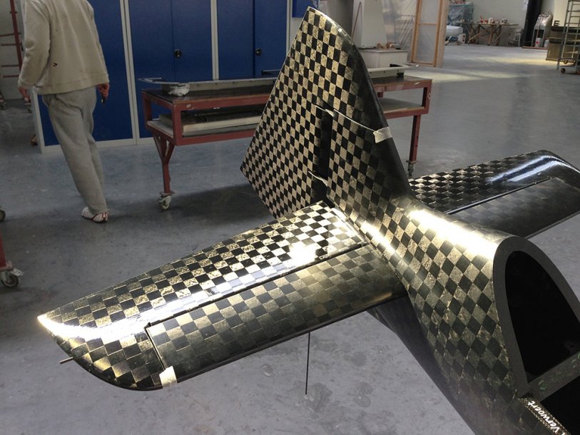

Absolutely and thanks again for the chat, very cool to get a full scale pilots perspective on this and I will absolutely pursue some experiments with this. Here are a couple of pics of the P3 Revolution that show the rudder offset for a "hinge-line counterbalance" effect you were talking about. I am super excited to try this out, but not on this particular plane since this is a production prototype.
