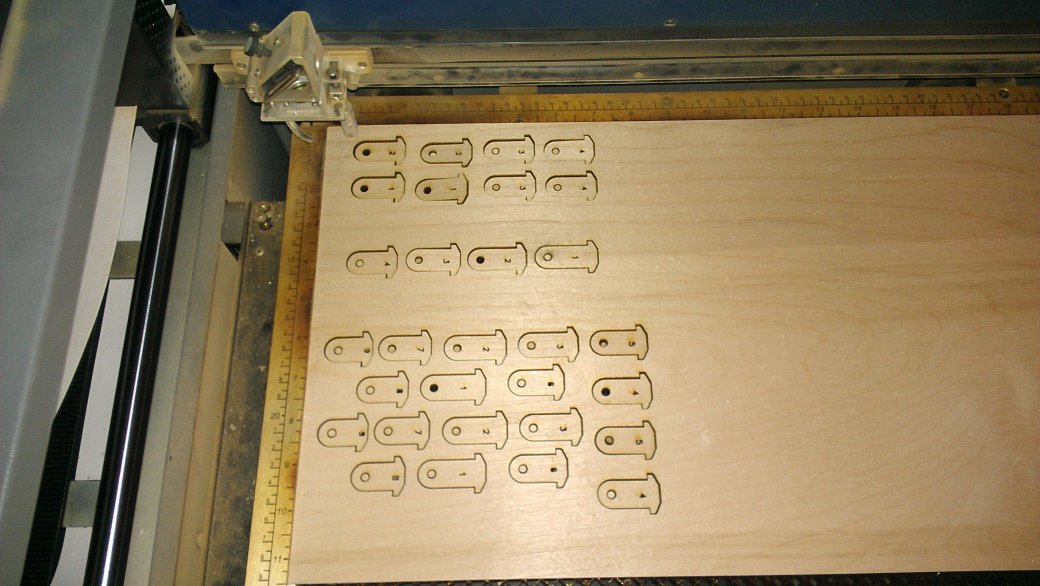

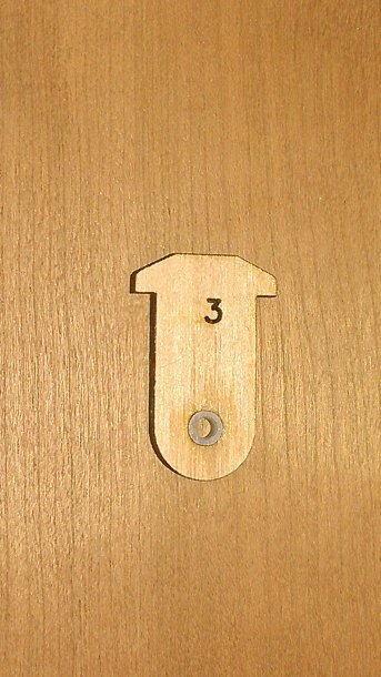

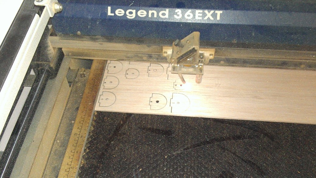

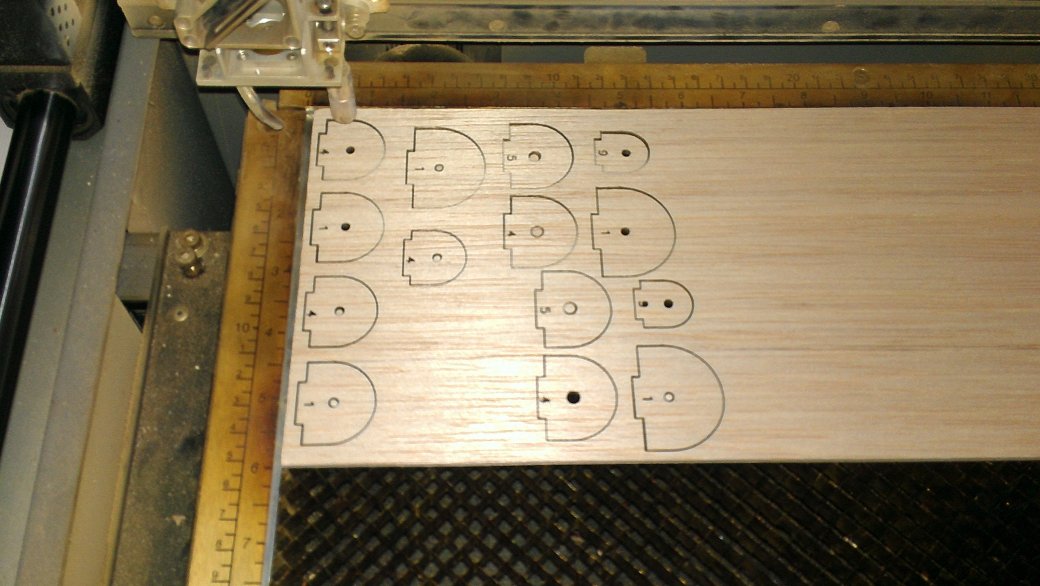

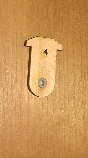

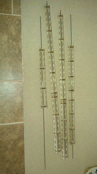

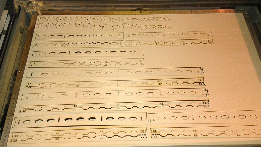

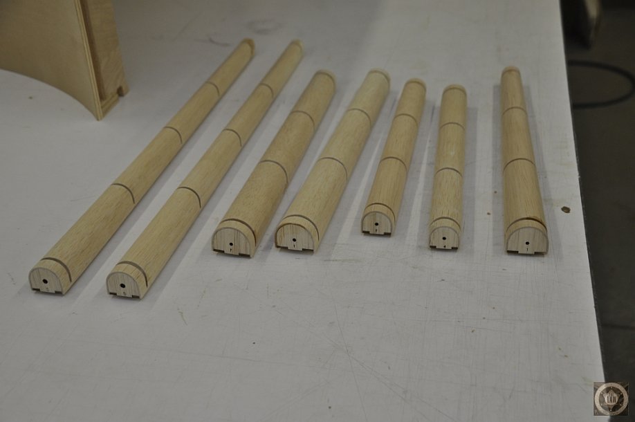

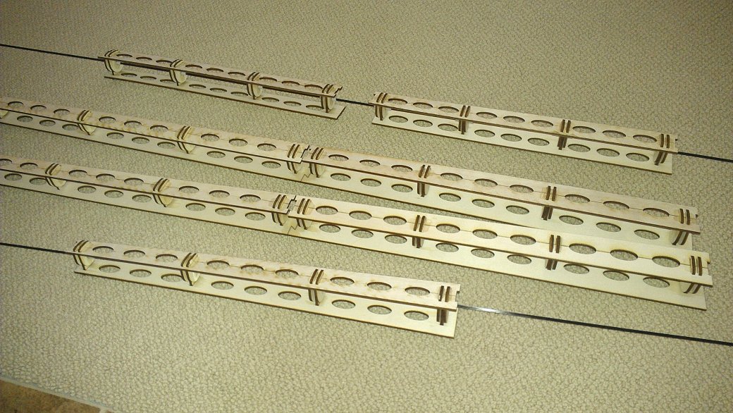

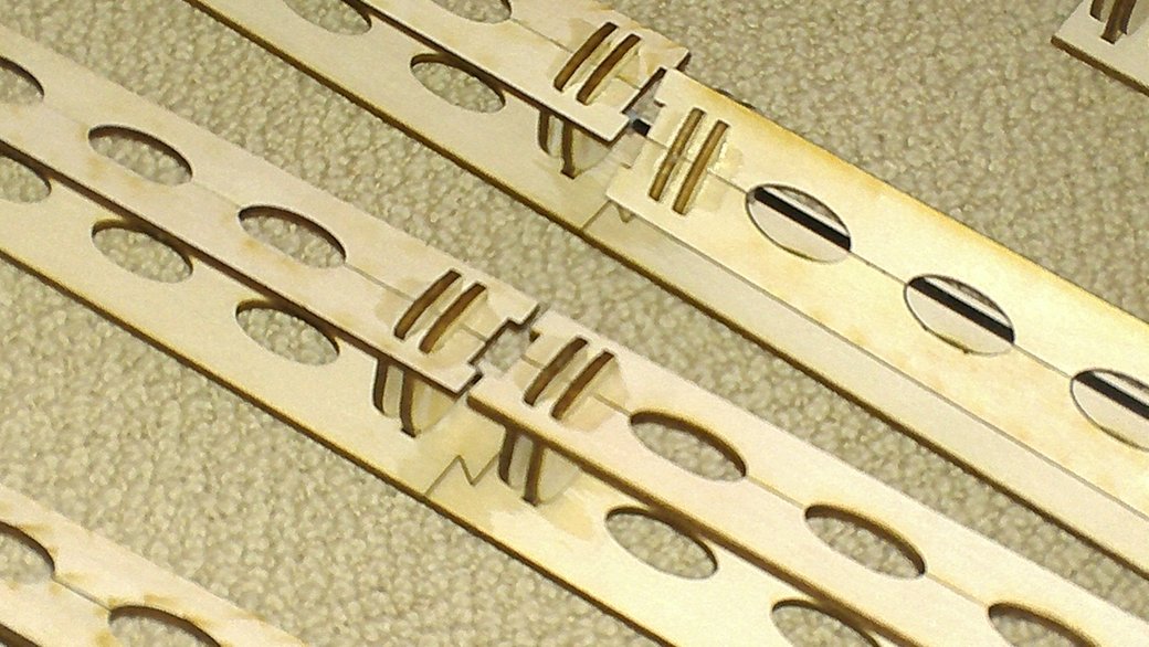

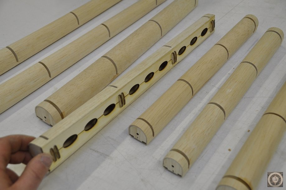

Sorry for the delay in pictures, I have made some progress in the last day after a super busy work week. Will post some more pics later today. I was able to get the leading and trailing edges installed, sanded and all surfaces sanded. All control surfaces cut and I spent about 6 hours with AutoCAD, caluclators, rulers etc. to draw up the hing assemblies. After all that a few minutes in the laser and an hour to glue and they are ready to install......complete with split ailerons:yesss: I think the Delrin bearings are absolutely the way to go, they are a little difficult to cut but are super super smooth. I can see these lasting for many years without getting sloppy.
Some crappy cell phone pics for your enjoyment:

Well got distracted with a beautiful day, skipped out on work and went flying so now I'm behind with work:(. But we had an awesome time!!!

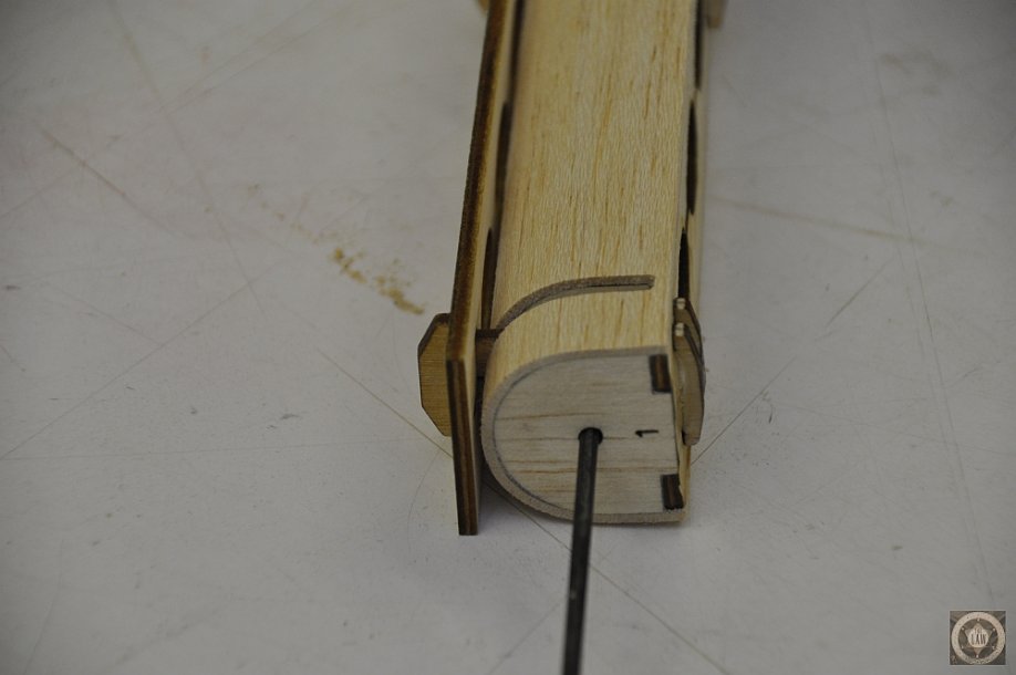

I spent about an hour before I left the shop tonight finishing up the hinge assemblies. They are wrapped with balsa, cut out and test fit with each other. Just maybe have time later tomorrow to get them installed so I can get back to work on the fuse.
