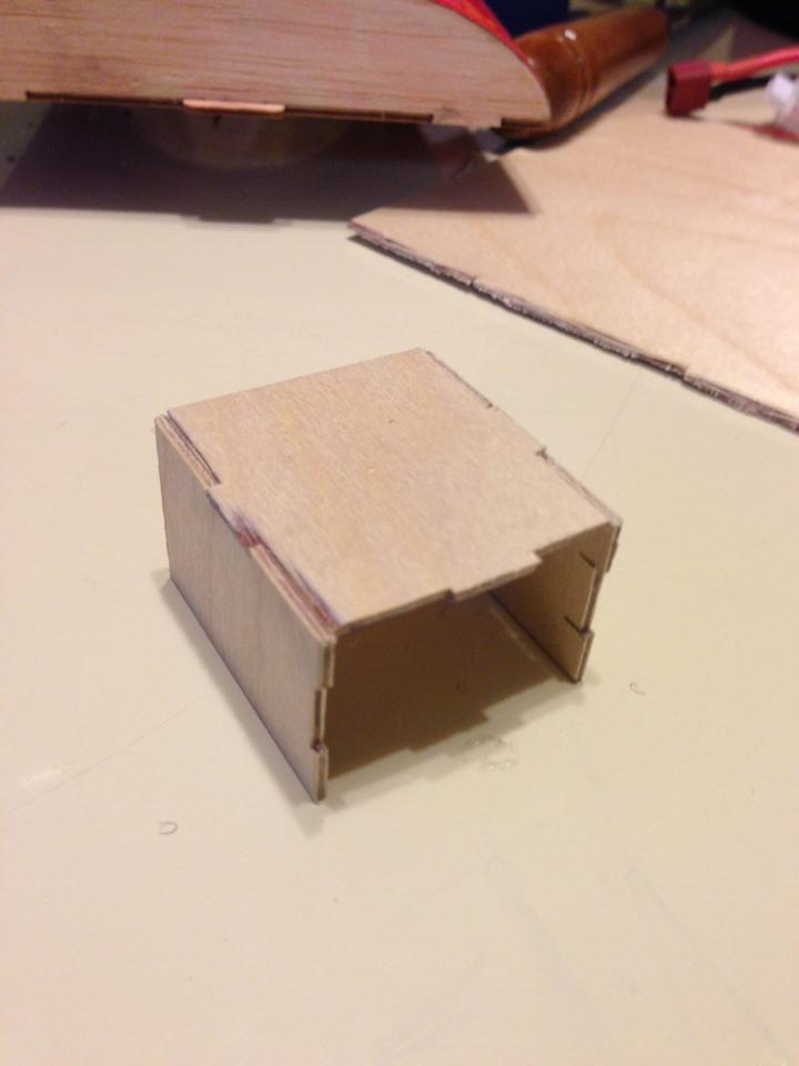

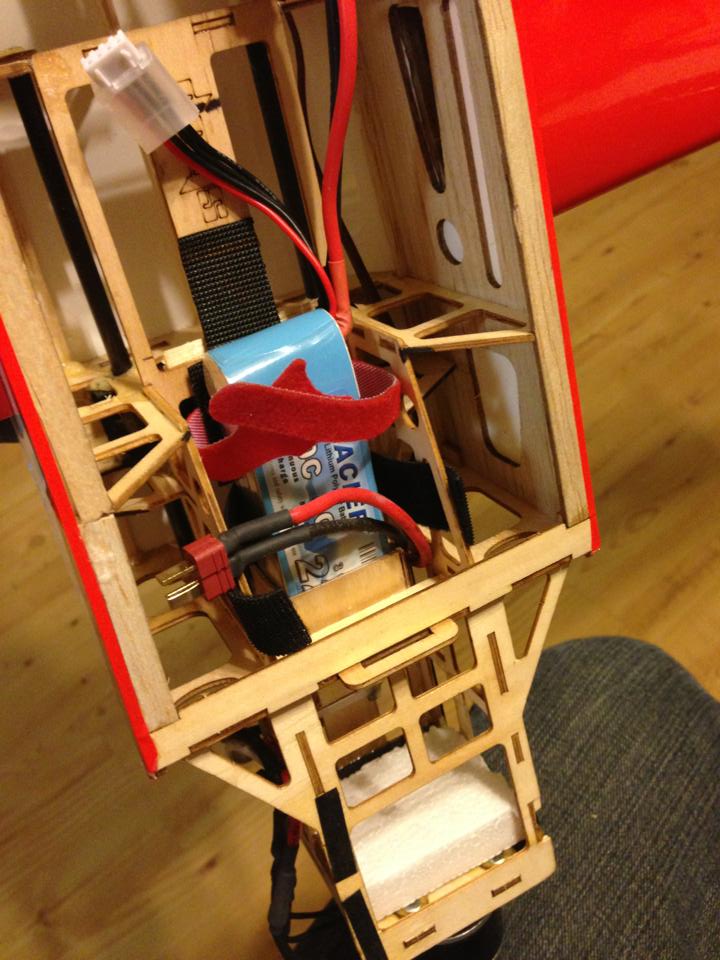

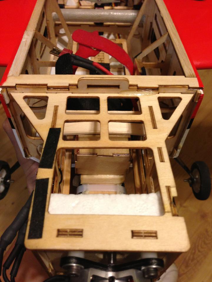

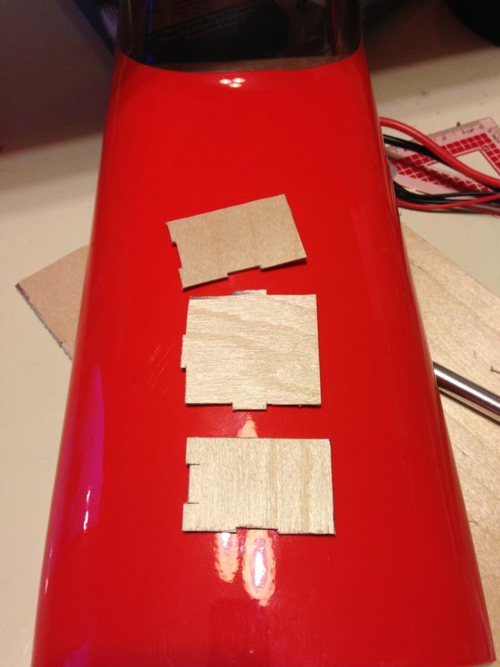

I made a little "doghouse" for my batteries. The Velox balances at a point that's hard to strap a battery in (3S 2200), so I made a little box out of 1/16" ply, and secured it inside the motorbox. Now, my CG will be the same every flight, unless I use a different weight battery.
