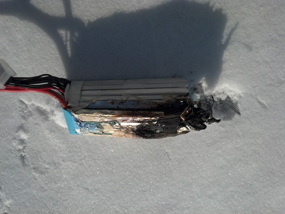

Anthony7820
Whoa!?!?! Maybe a bad pack? How did the other one do?
I was really pulling this one hard. 100mph hurricane maneuvers will really test out your batteries. If I did my calculations right, the pack should've bursted at 120amps(30*4000=120,000), but I couldn't have been pulling that many because my ESC is only rated for 90max and in normal flight I am pulling about 60amps.
I just know that I think I am going to just get some better batteries, obviously these weren't up for the challenge. I am just really lucky the battery just smoked and didn't catch on fire, if it would've my Goblin 500 would be destroyed.
Everything seems fine on the Goblin 500, before I left the field I put another battery in it and flew it around some. Just took apart the motor and cleaned off the helicopter some. That was scary:scaredchair:

That's not the proper way to add smoke to your flight:veryshocked:
Anthony, forgive me for saying this, but just because your ESC is "only rated for 90" amps doesn't mean that some magic switch is flipped at 90 and it goes no further. I flew a 70a ESC at 90a in the MXS for one flight and it did fine. An ESC's amp rating is partially about cooling ability. Also, with Castle specifically, I think I've read that they slightly under-rate their ESC's.
Now, if you fly with a logger and it says you didn't go about 90a, I'd believe that.
Either way, what is most important, is that your amazing new heli is safe on the ground, good job getting her down quickly and without further incident.
