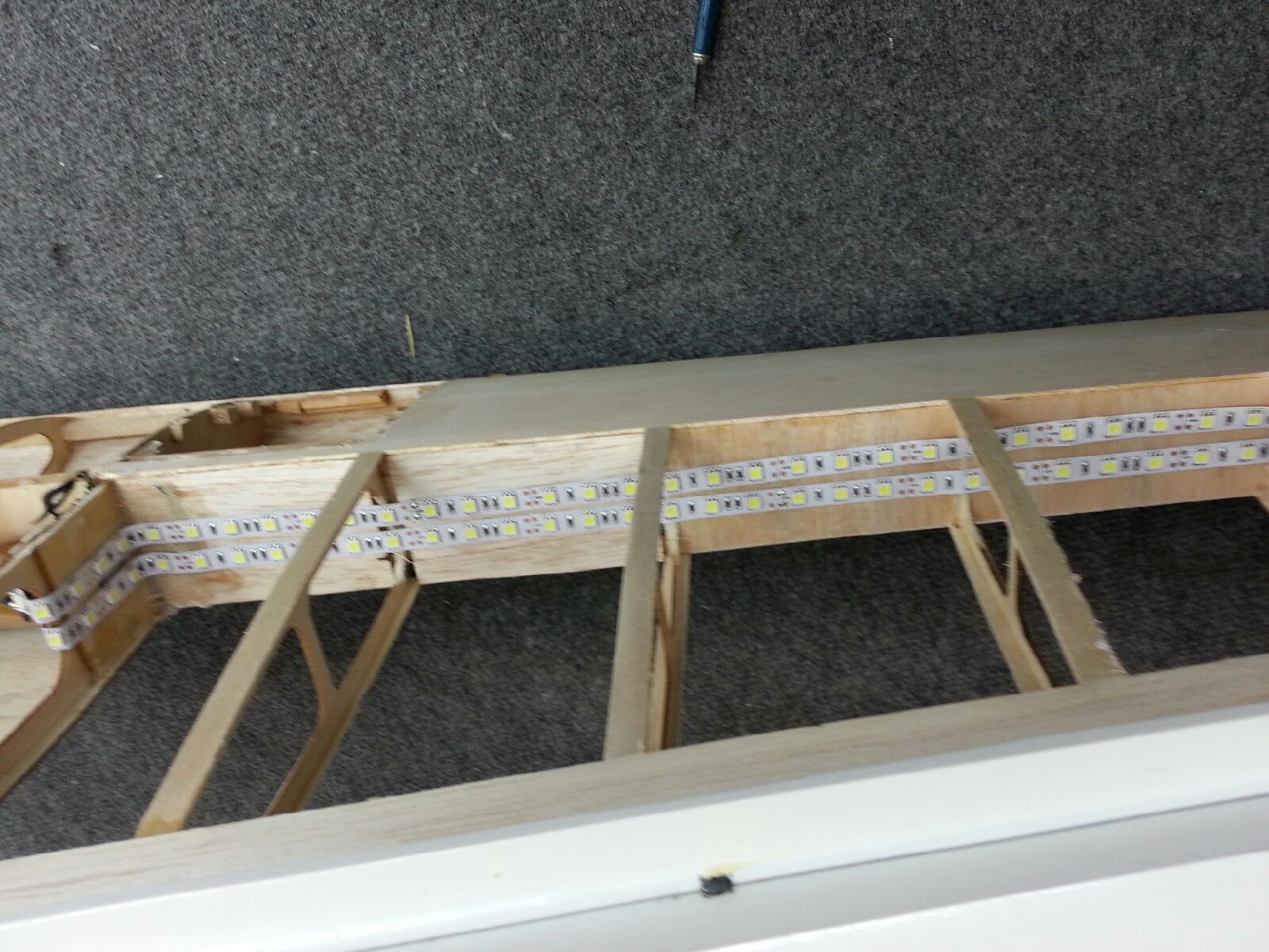

3dbandit
Sneak peak of my night flying rig!!!
