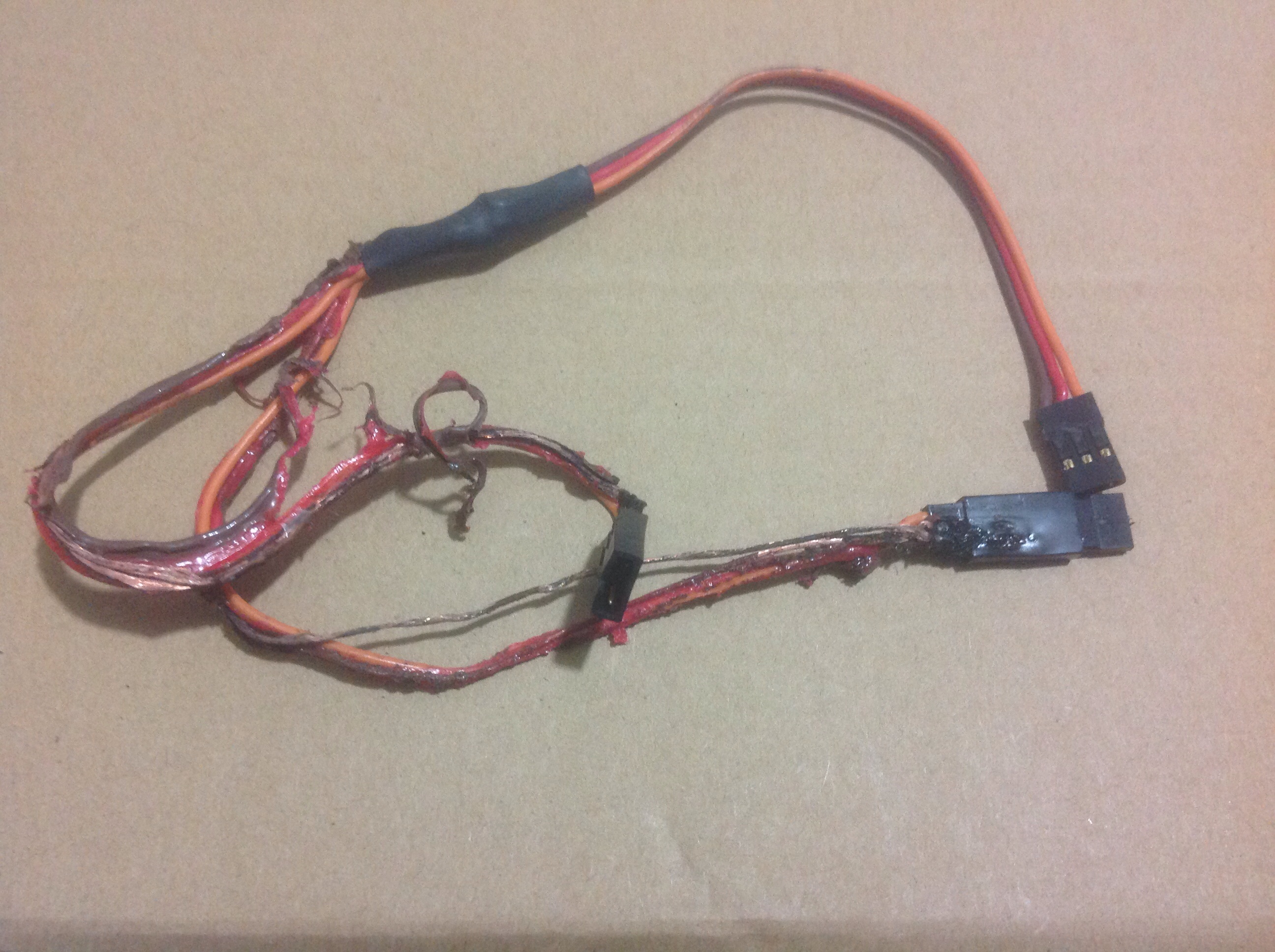

That's perfect, thank you kind sir! I was stupid, and did stupid things when speaking to a fellow flyer at the field yesterday. I almost lost my plane, but I didn't. I reached into the burning wires and ripped them out. My hand will heal, my plane wouldn't. On my 12S setup, there are 4 deans connectors. I use a Y-Harness to put two 6S packs in series. Above the 2 flight packs, are 2 LiFE packs for the rx and servos, which also have deans connectors.
After 50 flights, I became complacent during battery install. I am sure you can figure out what happened. At first I thought someone walked up behind me and was smoking. I soon realized it was coming from my plane and took action. It happened so fast, the it was over! I was extremely lucky, and will be changing all of my lipo packs to EC5 so this can never happen again.
If there is a lesson to me learned here, it's when setting up your plane, do not engage in any type of distraction. Don't talk to anyone, and concentrate on the task at hand. Disaster avoided, and I am extremely thankful.
I tested everything, and believe. It or not, no components besides a Y harness and the servo ends on my LiFE packs were damages. Besides some BB-Q'd finger tips, I am all good.
This is why I need the crimpers and ends. I want to fix my rx packs. Thanks for the link, I'll buy them today. AKf

so you plugged the 2 6s lipos into the deans where your life packs are normally plugged in?
yikes! glad you saved it! that can get out of hand very quickly.
glad you were not seriously injured.
distractions during setup == danger. I always try to set mine up as soon as I pull it out of the van instead of in the pits for exactly that reason.

It was the third flight of the day, I was networking packs and got distracted as I plugged in my series harness. 99% of the time I hook the series harness to both backs outside of the plane. This time I left the y harness on the bench and installed the back, velcroed them down and hooked it up in the plane. Now there are 4 deans connectors in a 4" sq area, while chatting I hooked a 6s lipo pack in series to a 2s life pack. When I plugged in the rx lead it shorted the packs and Poof, fire.
Bone head doesn't begin to describe how stupid I felt. It cost me a servo y harness, and 2 life pack servo connectors. It could of been a major disaster.
When I had Hitec RXs which have a SBC port to seperately power the RX and also get voltage telemetry (best design idea for RXs I have seen) I had a Stryker setup with a servo connector coming off the main leads to that port and another from the BEC for the servos. Well guess what I did one day when changing something out in the plane. I melted all 4 servo in the wings and almost had a little foamy fire in my basement.
So far for my big electrics, I have the BEC pro wired into my series harness so there is only the 2 leads to hookup. If I do a truly big electric I will have dual RX packs like you have, hopefully aft in the plane so I won't get them confused. Another thing I do is I have multiple colors of powerpole housings so for something that can be confusing like my anti spark I use a different color like yellow in this case. I might do my RXs in Orange and Brown and do the same on that set of RX batts for example.
