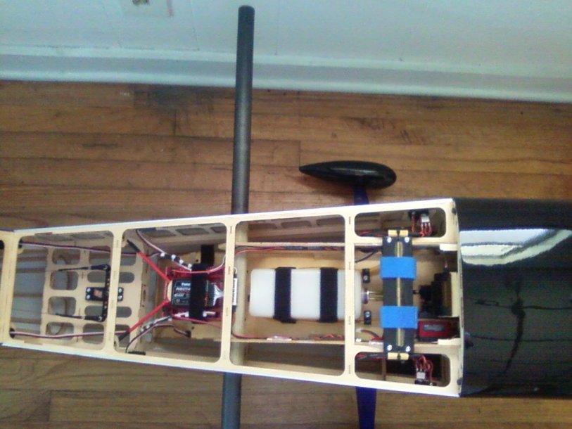

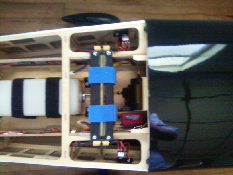

Hello Rob...I have been running 2 2200 Lipo's for everything in my "purple" ever since I converted it to HV 3 rears ago. I put 6 flights on it at different sessions (2 or 3 I think) and each flight was about 10-12 minutes. Had almost 2200 Mah left between the 2 packs! This of course is going through the "pro" Smart Fly board. The ignition is supplied through the board as well. No optical. Just a Rcexl cut off. Never had an issue. Of the two packs one is always about 250 Mah lower than the other. The packs are under the braced cross mount.
