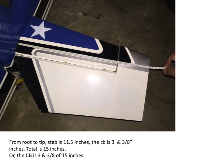

OK, here it is,
this is a picture of my 35 cc extreme flight, 78" extra.
Would it be wise to go based on these dimensions?
the ratio would be:
3.375 / 15 = x / length of root to tip of the stab in hinge line
x = will equal the length of the counterbalance from the root side to the tip side.
any one have any thoughts on this?

OK, here it is,
the ratio would be:

I think you will find better resolution (smaller travel needed) and less strain on your servos with counterbalance.
Correct, just don't need the EXP sized elevators as the EF has. To me the EXP stabs on the EF planes are just a hair too large, I liked the older one's better. I usually do about a 4" counterbalance on 40% planes and only about 3.5" on the rudder seems to be the ticket (for me).
