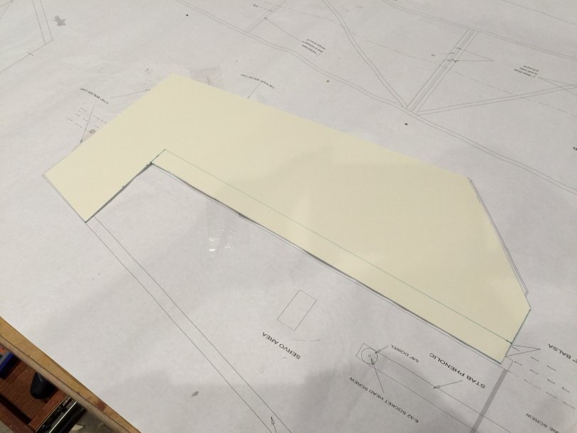

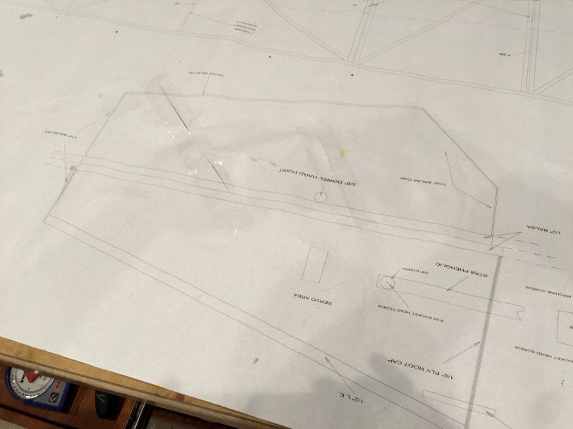

I began by using the plans, to make a decision on where to cut the stab.

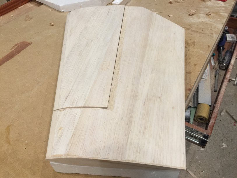

I then made a template of my counterbalanced stab:

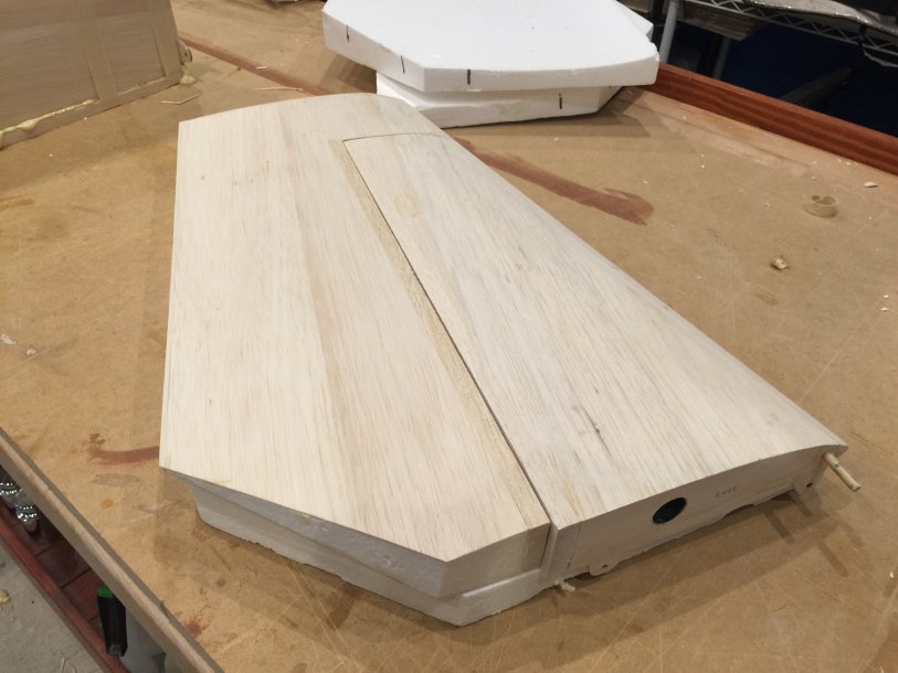

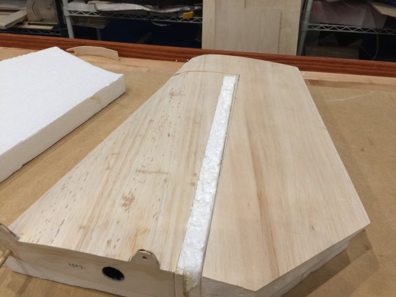

I then placed the template on both sides of the surface, and using a sharp knife, just cut through the sheeting.

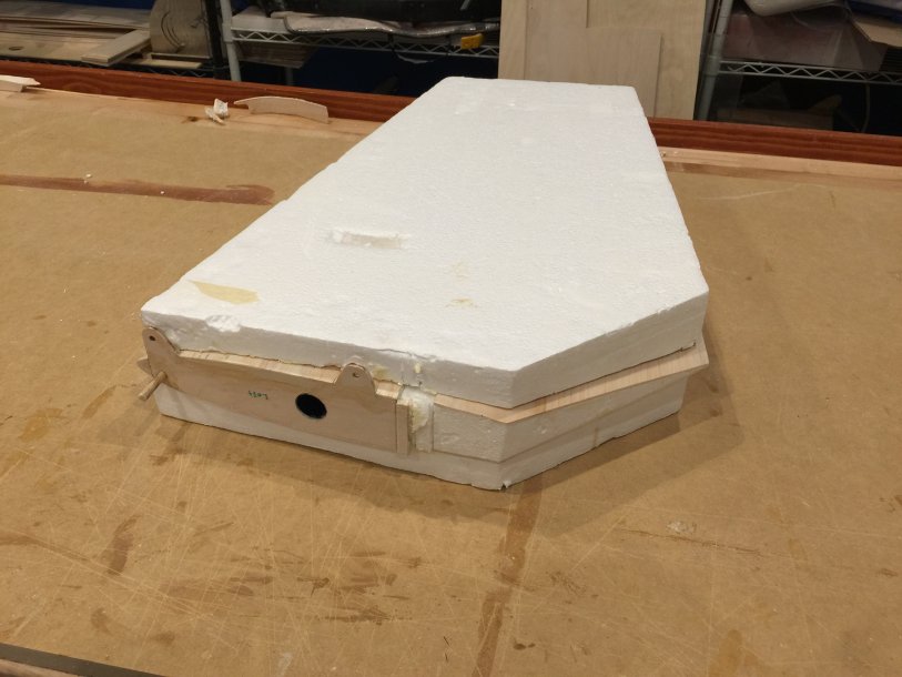

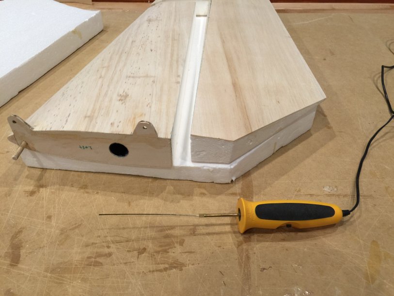

Then, I used a foam wire cutter, and did the rest.
I am demonstrating the shucks to prove, a band saw was not used:
once you cut the sheeting, I used a sharp wedge to remove the sheeting in the center (this is 1" strip)

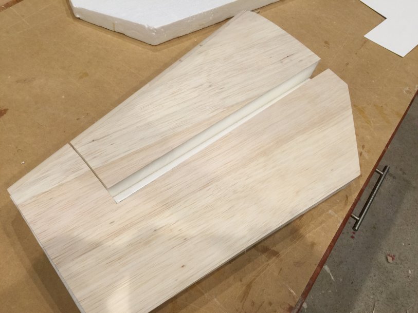

final result!
Came out great....

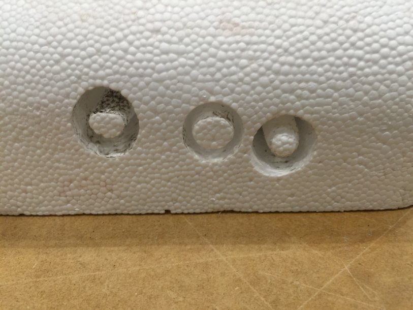

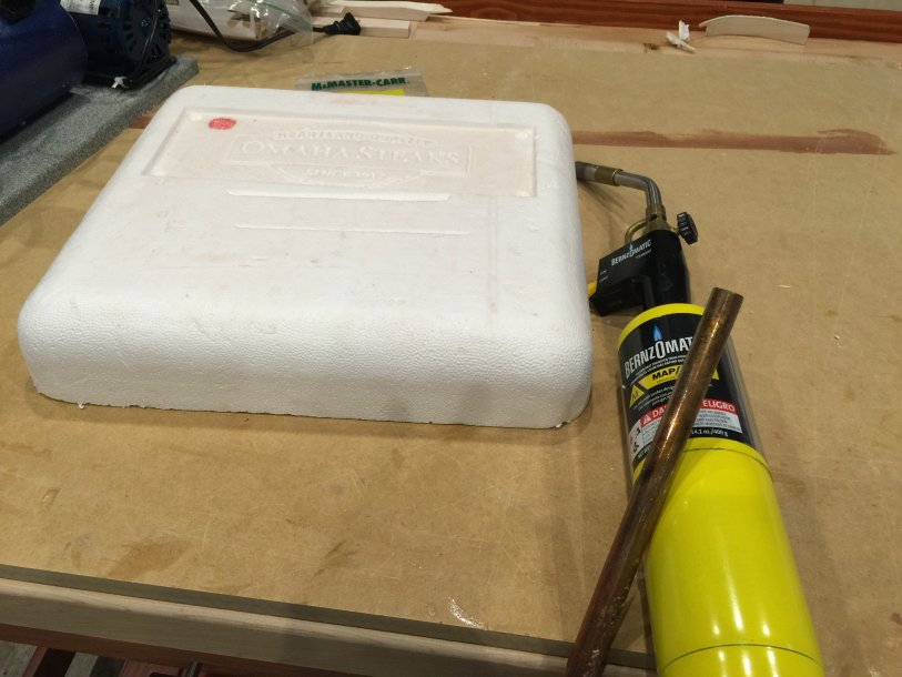

Snoopy had asked questions on, how do i melt a hole out in foam, so I took some pictures:

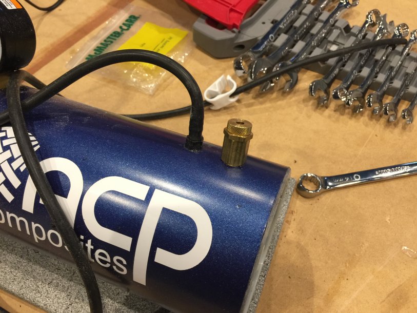

for demonstration purposes, I used a piece of foam, a copper tube, and a torch.
Take the torch and heat up the end of the copper tube:

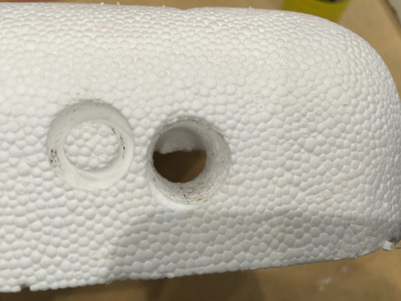

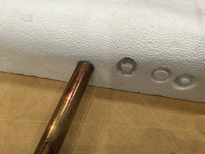

I made several passes in the foam, you can see how you can make a very round hole. the key is, stick the hot tube in and out quickly, and without much movement, other than directly in and out. as you can see, the hole on the left is eccentric.
just to demonstrate how a hot copper tube can "melt" away the foam easily and cleanly.
Here you go Snoopy, I finally posted it for you. Forgive me I did not do it sooner. I know you asked twice. Let me know if this answers your question, or If you want me to show you something else.
