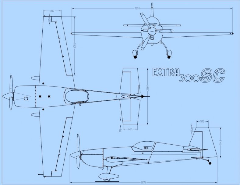

Here is a blueprint of the original 330 SC , again, from EXTRA website.
the blue print, has an error in it, as you can see, they call it a 300 SC, but we all know it is a 330 SC.

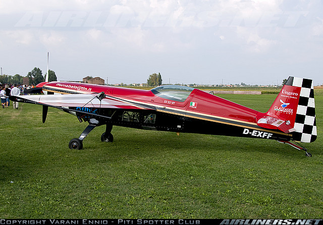

Ok where is the picture of the plane can find the link.
Have a question looking at the drawing of the extra the alerons have counter balance on the end. We have them on the elevator and rudder but not on the alerons why.

As for using full scale aileron, constant or slightly wider chord at tip with counter balances....don't do it. This is another case where full scale and scale don't work. This could be ok if you mainly were flying 3D, but since you and I are flying IMAC, the wider or constant aileron chord with counter balances will induce adverse yaw in our rolling elements. So for us flying precision aerobatics, tapered ailerons work best.
