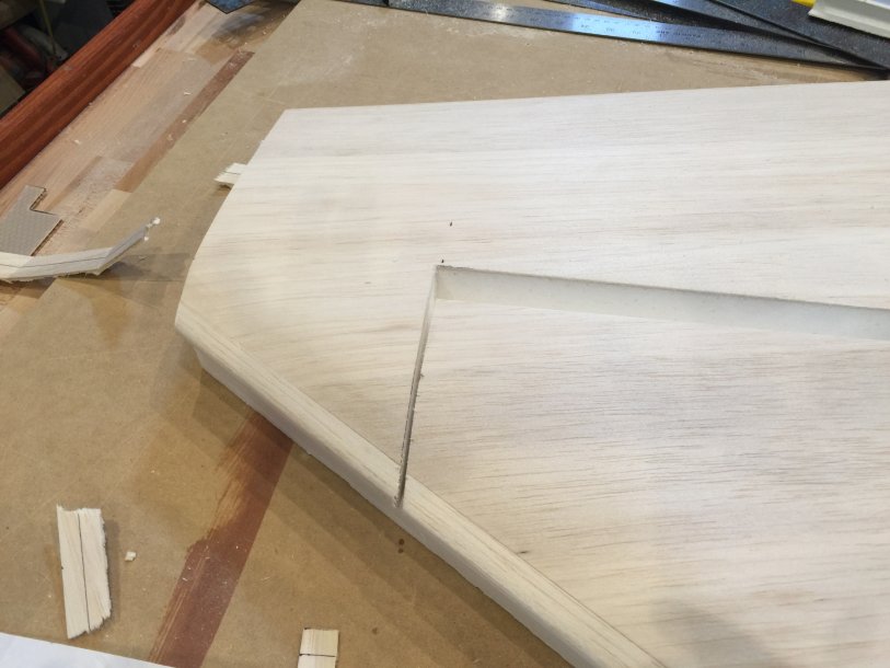

Thank you Cam! I am using a similar method, and would still appreciate the photos! Being my first GS airplane, it appears I am at the same point you were - dreading it... LOL! Any refinements and advice you could provide, I will most certainly take!!! Further, looking forward to the easy part as this definitely will not be my last GS build. Still dreaming about how to get that wing mounted in the milling machine! LOL

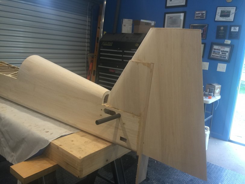

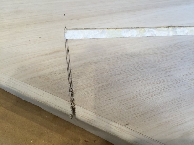

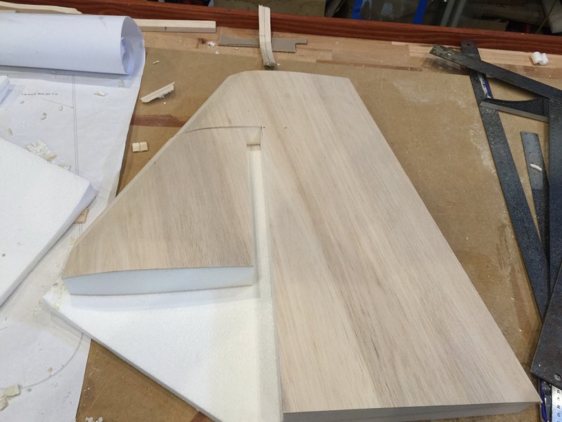

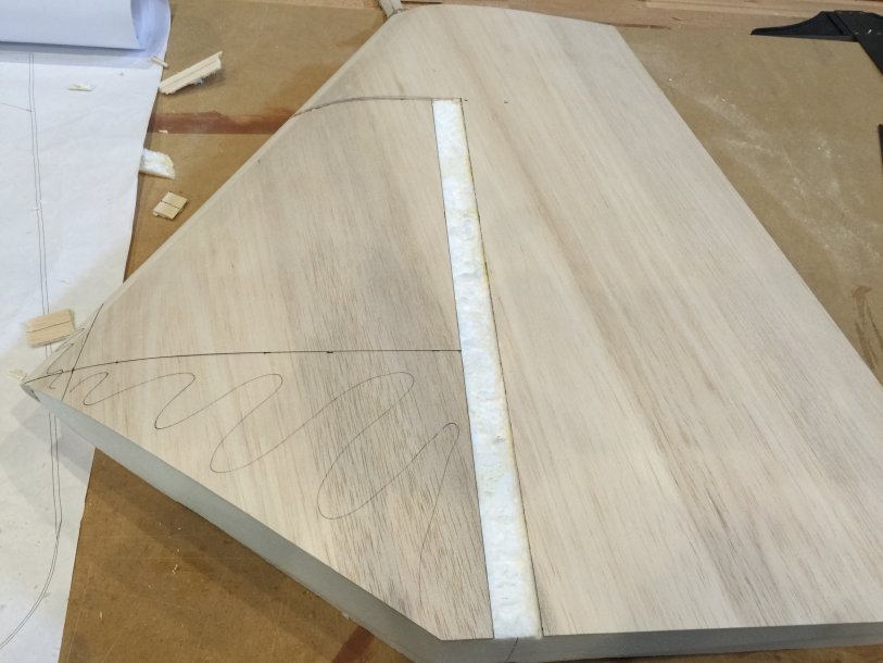

Was able to cut out the fin, using the technique by Tom Wheeler.
