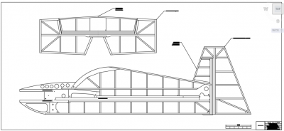

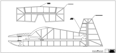

@Snoopy1 and @AKNick here are some images of the edge profile plans. I forgot to bring my laptop home and have today off. I will get the pdf plans to both of you tomorrow. I drew the fuse two different ways. I personally think the first way will be a bit stronger but probably ever so slightly heavier as well.

Thanks that is very nice of you to do. Looking forward to receiving the drawings. It is sized for a 20cc gas engine.

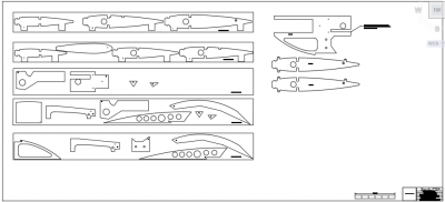

SO cool! I would love to have a slab again. I was dead set on making a 20cc version of the MOASS MOJO60/65, I'm sure you have had the privilege of flying that machine/setup before? Can you compare the two? I would have a lot of fun building something of your design. I would be curious if someone could laser/router cut that fourth picture of yours. I know @GSNadmin offered laser/router cutting.... Curious about that option, maybe a few of us would like that done????? I like the easy route.

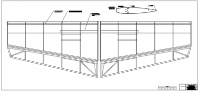

Please ask away. What questions do you have about the wing.
For a 20cc size plane the wing span could be as much as 64 inches or around there is it a two piece wing or one. What do you believe it should be. The reason I ask is will I be able to transport to the field in one piece. Well a better question would be what is the length and wingspan then I can do some measurements and see if I can live with a one piece wing.
62" wingspan
55-1/2" length
950 sq in of wing area
Yes its two piece wing using a 3/4" wing tube
