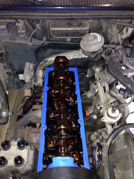

After digging in I went ahead and replaced the valve cover gasket. Thought it was leaking but upon remove the bolts that hold the valve cover down three of the four on the passenger side where only finger tight. Prolly could have just tightened them and fixed it but I already the gasket and was already there so in it went. Now to pull the front of the motor off to replace the timing belt and water pump. Stay tuned I'm automotiving this airplane forum up LOL

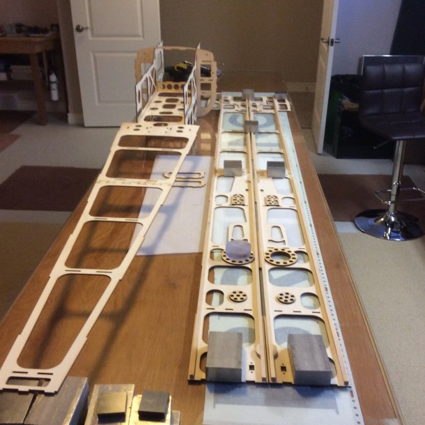

Well gentleman just received the last few parts required to build the Viper ST kit. It took a long time to get the carbon tubes. I belive I have everything now so the build will start. Well it started yesterday day morning and is going well.

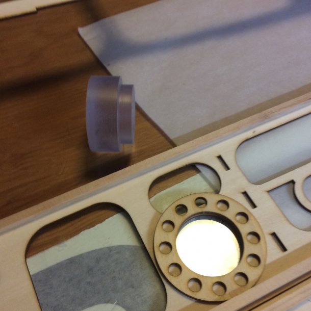

Well got the sides done and started the fuse the first part was fun but the second not so much. Installing section between the two sides was difficult to say the least. Did not break anything but came real close. Man was that a tight fit. The second picture is a small bushing I made that fits the hole for the main tube. Glued up the ring put it on the bushing and then slide the bushing into the fuse sides this guaranteed me the alignment for the wing tube this is one thing that I needed to be perfect.
