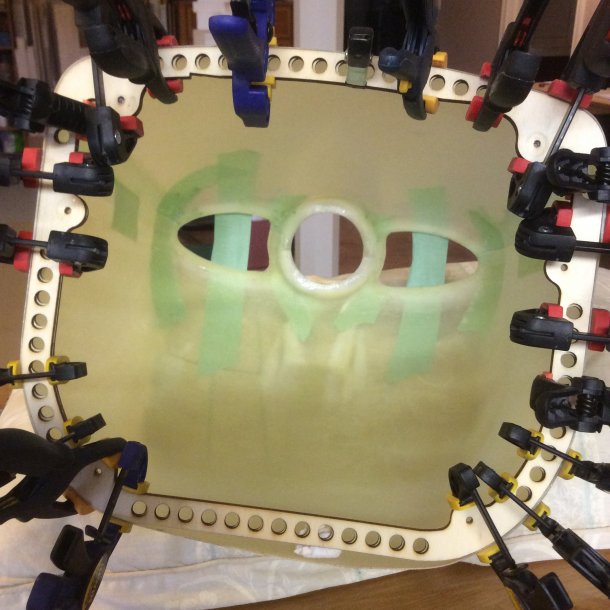

@ericrs hi, got the cowl fitted to engine and the fuse but when I went to clamp the cowl to the ring ended up with a little extra cowl. Did that happen to you. Got to solve this first now. The split it as tight as it will go. Really do not want to cut a wedge out of the cowl to get rid of the extra glass. Added a small piece of paper behind it so that you can see the gap.
No I didn't have any extra. Mine fit perfectly.

Hi @ericrs well got the problem resolved worked out the extra cowl that needed to be tightened up. Need a 0.0045 inch shim cut one warped it around the cowl ring and everything was tight. Glued it all up will see in a few hours how it all came out.

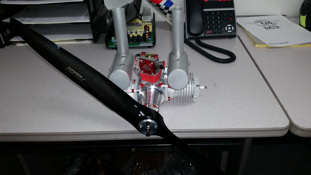

Yes it is nice to look at a new motor I do it all the time. And then we take this beautiful looking engine and stick it in to a cowl. Best we can do is stick a big sticker on the cowl to tell everybody that there a nice looking motor in there.
