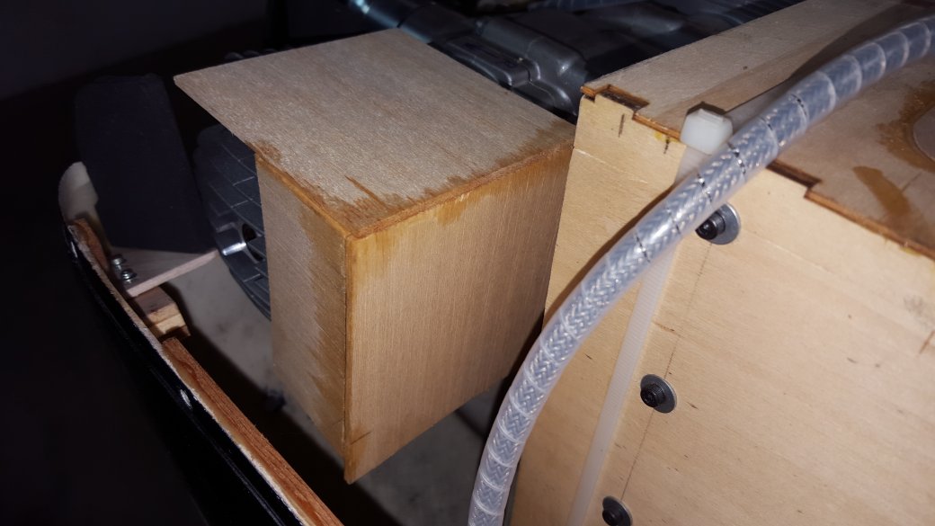

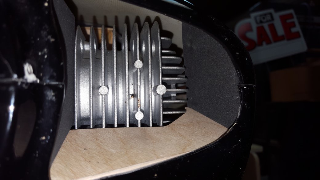

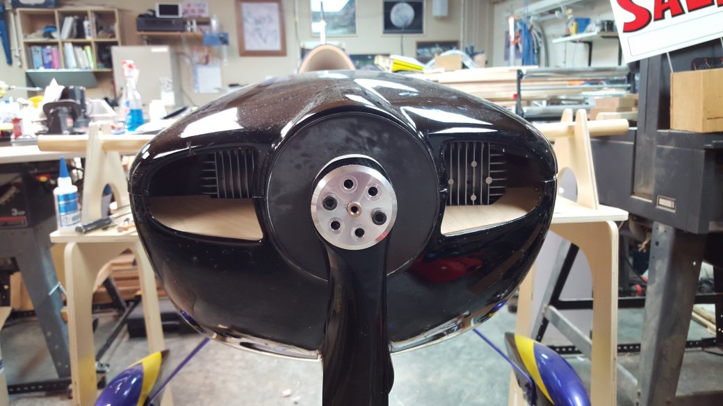

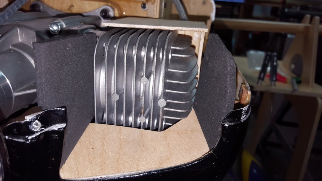

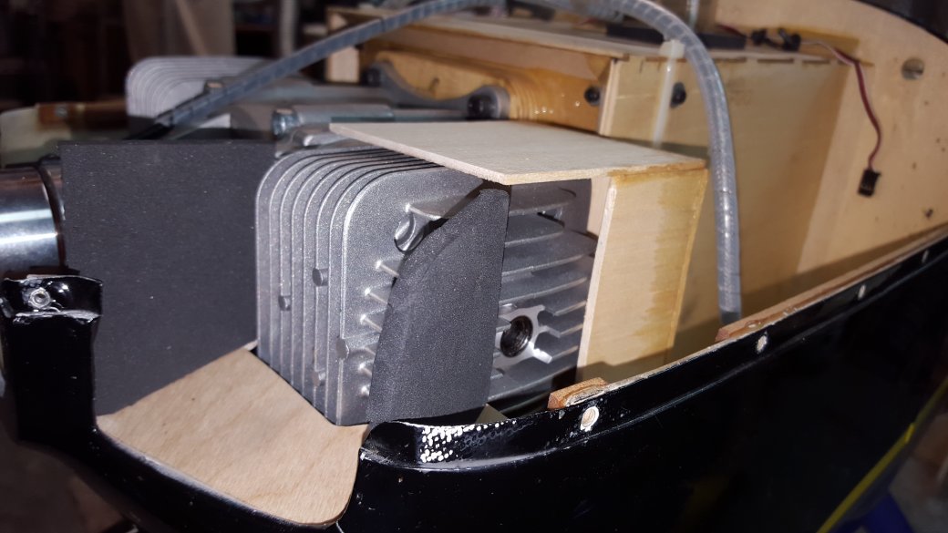

You do realize I know you been peeking under the hood of my 260 right? Your baffling is pretty much to a letter how I did mine on the 157. It runs quite cool with no overheating issues. Good job Mark!!Well I worked on the baffling of the Edge some more. The engine sits real high in the cowl so I had to angle the bottom of the inlets to get the air a least midway on the cylinders. Also prototyped a semi-boxed in rear baffling. Any input would be greatly appreciated
View attachment 51281 View attachment 51282 View attachment 51283 View attachment 51284 View attachment 51285

Great minds think alikeYou do realize I know you been peeking under the hood of my 260 right? Your baffling is pretty much to a letter how I did mine on the 157. It runs quite cool with no overheating issues. Good job Mark!!![]()
