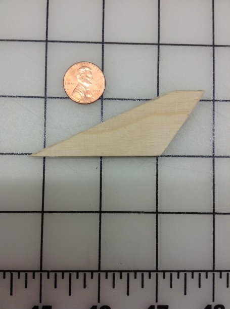

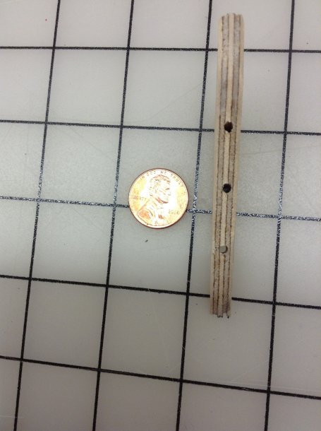

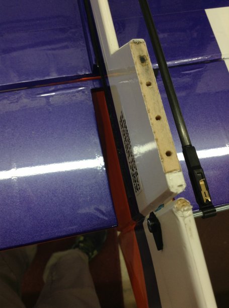

I installed a new gear set in the rudder servo on my Wild Tiger profile. It stripped when the carbon rod I installed for a tail skid broke. And I didn't notice till I taxied quite a ways dragging the rudder. Now I just have to figure out something different for a tail skid.
Hey Mike, May I make a suggestion for a tail skid? Remember those Dubro Wing Tip Skids from a few years ago that were made for all those guys that always brought their plane in on approach with one wing low? LOL..... anyway, after doing the repaired rudder on the Edge from all the tail dragging...hee hee, I put one of those on the bottom of the rudder. If I grind that off? No worries. Simply remove and replace. Would something like that work for ya?
Thanks and yes that crossed my mind. I actually have those in stock at the shop. But I don't think it will be quite tall enough on its own. Maybe I can build up a ramp with some lite-ply and cap it off with one of those skids.
I'll post a pic or two what ever I come up with.

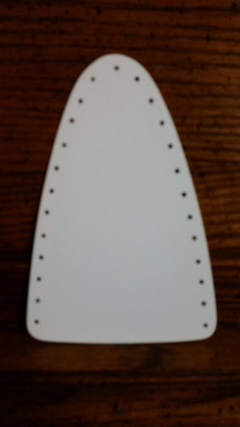

As a side note: If any of you with the H-9 Sukhoi would like to have one of the snazzy "full scale looking" tail gear fairings.... let me know. I would be happy to duplicate one for ya'll. Free of charge of course. Maybe @Robotech would like one for his brand new recovered Sukhoi huh?
Really like your tail cover it does look good. And hides the mounting brackets nicely done, what screws are you using .
Here ya go @Robotech. Will send it out to you tomorrow.
Pretty easy to put on. Place on your fuse in general location. Mark and drill "crown" hole with 5/64" bit. Install that attachment fastener. Fold gently to match contour of bottom of fuse. Hold in place with hand or tape while drilling the remaining holes. Harden the holes with thin CA. Paint fairing. When cured, install with fasteners of your choice. Done. Lookin' awesome on that bitchin' red Sukhoi.
