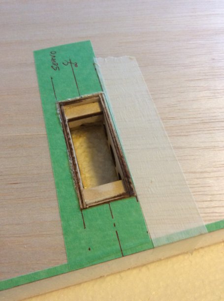

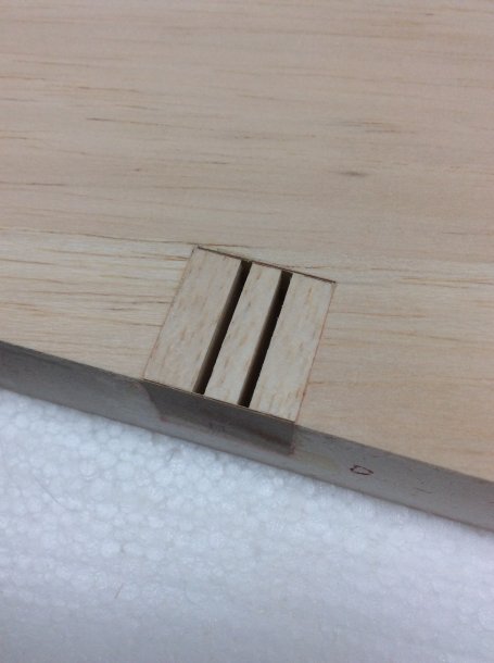

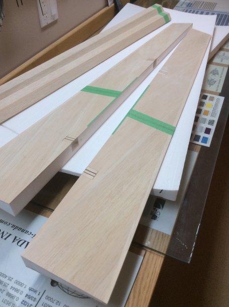

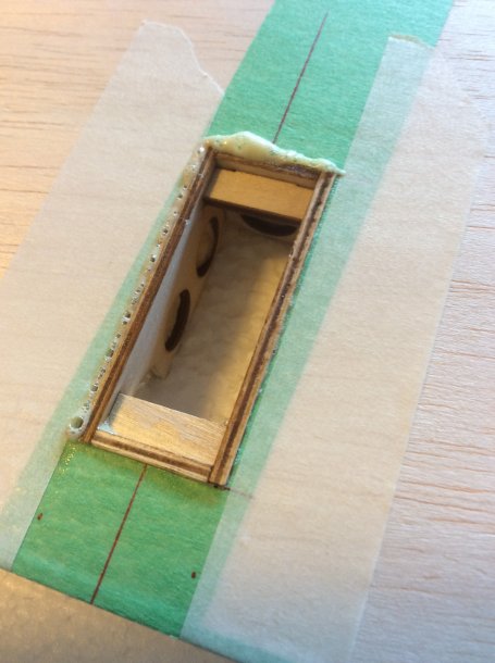

Ok started finishing the wings it is sheeted and that's all. have to cut out the alerons and add the hard points, servo boxes and all the bevelling. That should keep me busy for a couple of days. Must say this is my first styrofoam wing it sure is a learning experience and slow sure my next one will be a lot quicker. How many of you guys cut your own styrofoam wings.

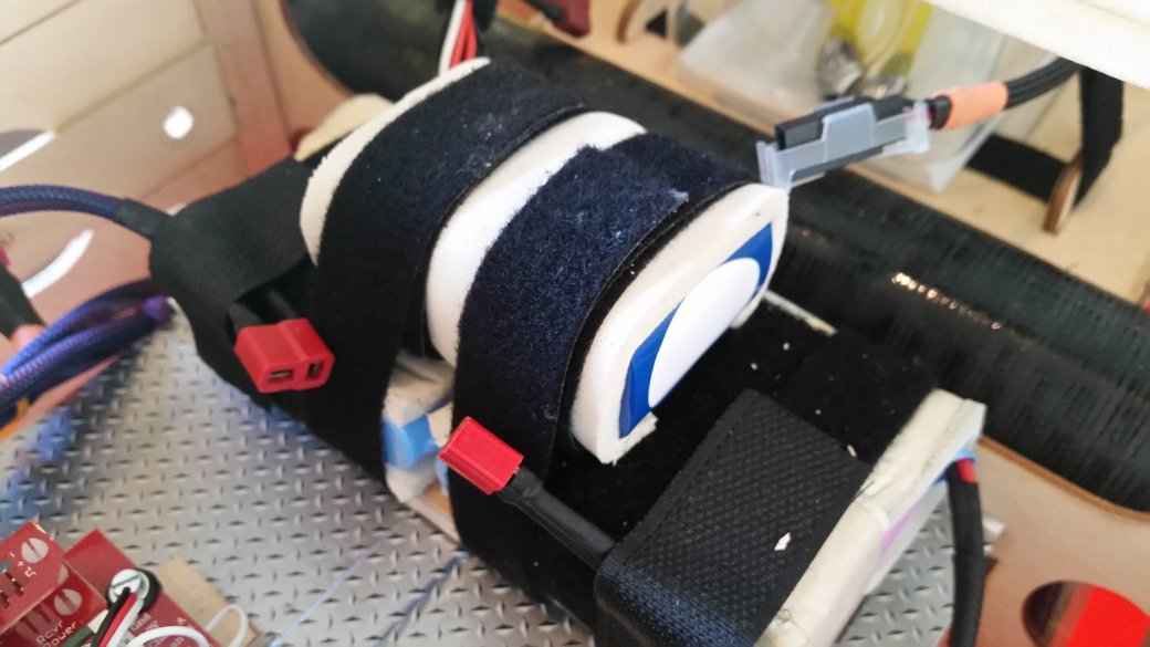

I did do a little maintenance and upkeep/updates on a couple of the planes in the Epley hanger. The big Sukhoi was in need of a few nice little touches. Replaced the ignition battery with a 7.4 Lipo. The LiIon was doing great, but I figured if some is good, more is better....right? Mah speaking of course.

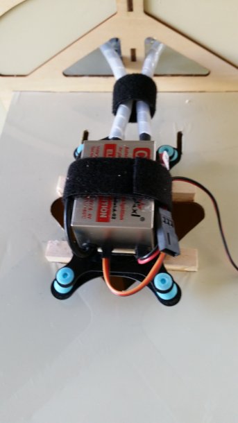

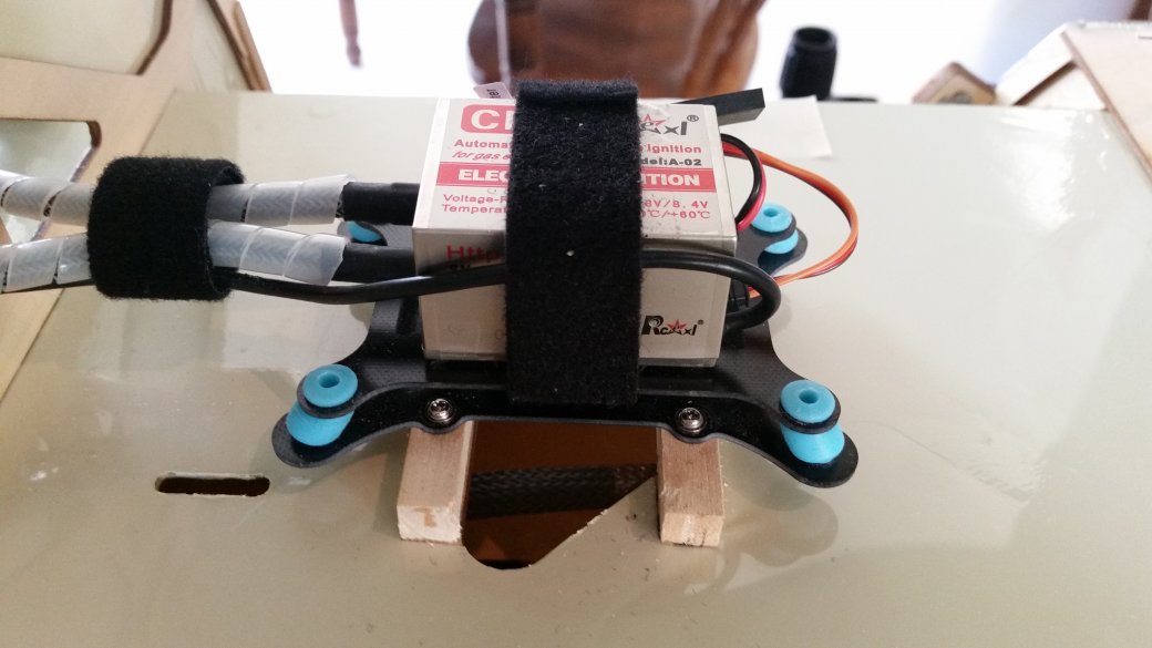

I also had one more TDRC Vibramount for the ignition module, so I figured "why not"? Installed that and re-attached everything. I've come to really like those guys.

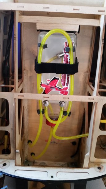

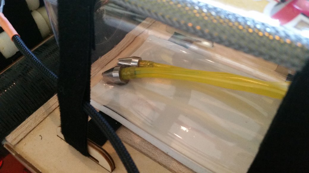

Lets see.... Oh yeah, I also replaced the klunks in my tank. Haven't had any issues, but realized I was not getting all the fuel out when I drained the tank. I figured I would put the "snorkel" tip klunks on as replacements. I have had superb success with these.

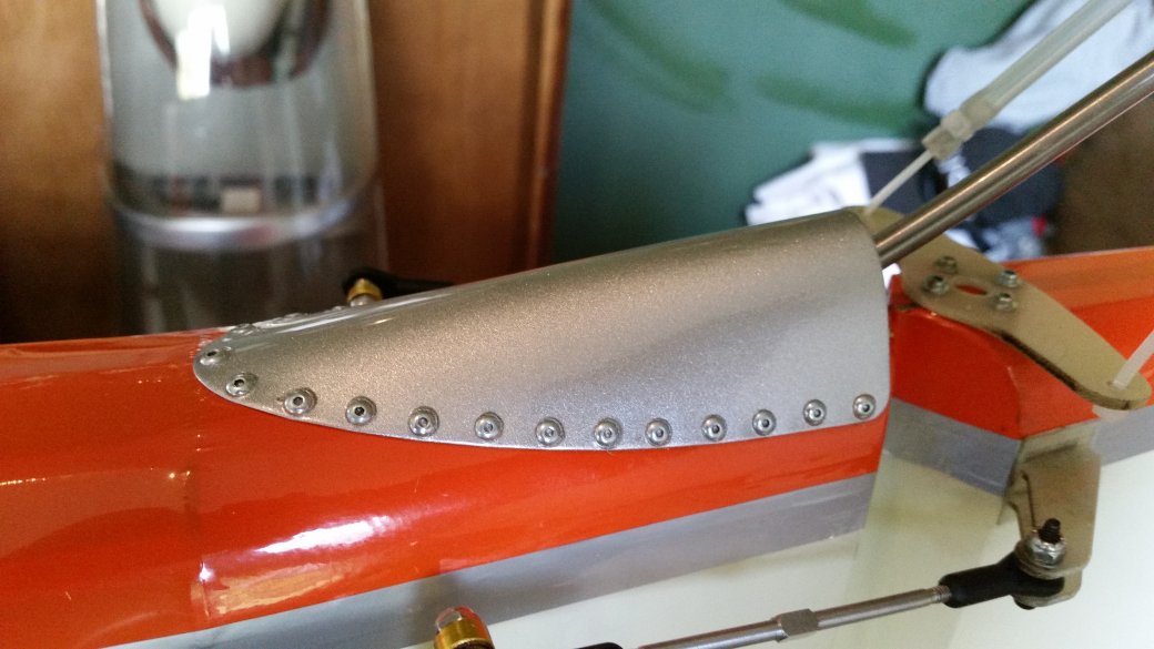

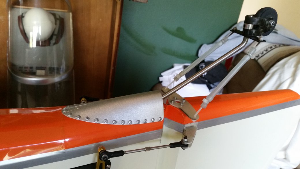

I noticed also that my custom tail gear fairing was getting a little ragged, so I removed it, cleaned it and repainted it. Originally it was painted the same color as the covering. Orange paint didn't hold up too well so I switched it up for some good looking Silver to match the pinstripe on the airframe. It kind of breaks things up a bit now. Not quite so "Orange" on the bottom. LOL

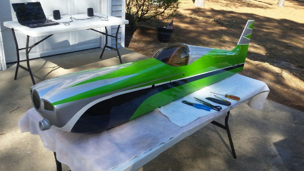

I've put a bunch of gas through the Pilot Edge so I decided before she gets retrofitted with the red headed CS twin, I would replace all the fuel tubing. After a year of flying her, the tubing was still in great shape. Just not shiny and fresh looking. We just can't be having no sexy red head hangin' out and depending on stale tubing now can we?:laughing:
