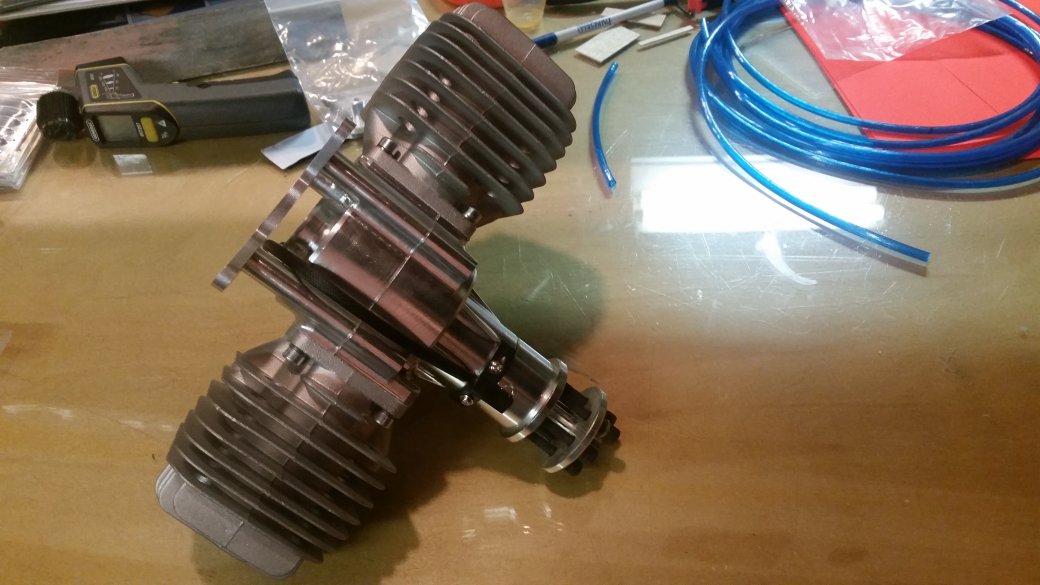

Its mounted up. Fortunately for me, I dont have to be up at 5a for work.
But Im gonna be busting my hump tomorrow. New entry door for my garage, edging the walks, and 2 new kitchen light fixtures, then take the one out of the kitchen and put it in the hallway. Doubt I get that all done by 4p tomorrow.
I dont have much planned for Sat, so I can finish things up. :)

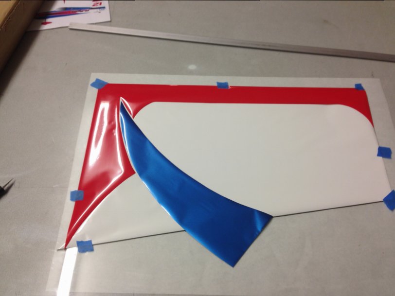

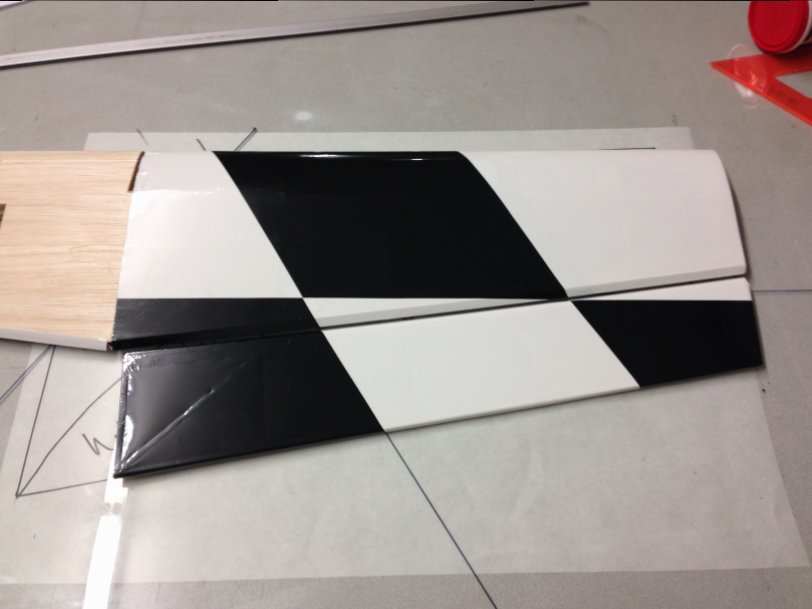

. . . . Started working on the covering for the next slab in the line up to be covered. Angled checkers are a royal PIA to get everything lined up right but man the results are worth it.
Hey Chris, I watched my buddy cover one of the wings on his Pitts M12 that had a checkerboard pattern on the bottom. He put down two layers of blue tape along the line he wanted the squares on. That gave him an edge to put the black square up against. Then he marked the tape to locate the squares in the other direction. Of course it isn't much help on a small wing like your profile. I just thought I'd throw that out there.

That's the way I do it when I do small Chex. But on big one like this I like to save weight. So insted of covering the whole th get in white and then laying the black Chex down over top of it they are all individual pieces that are put together over glass then moved to the wing. Here is a video of how I do it of course this isn't Chex in the video but it gives you the idea.
