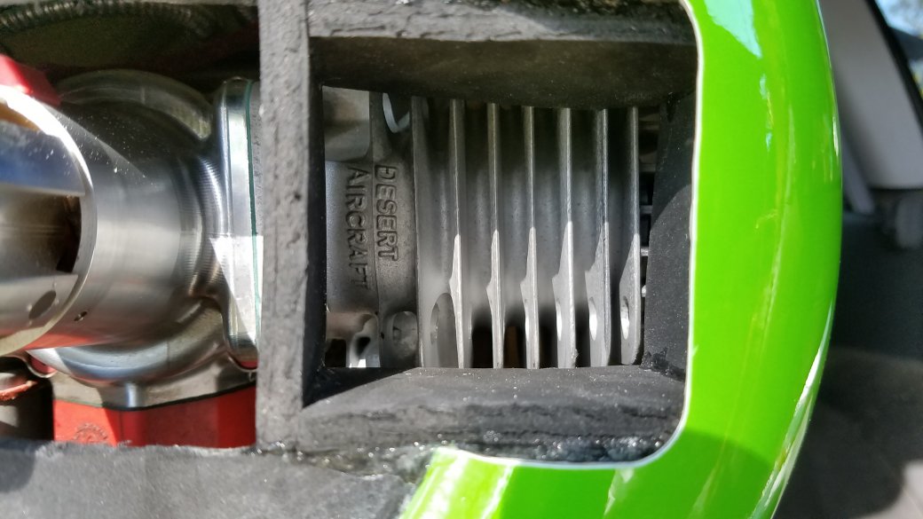

Felt that my baffling wasn't sufficient enough to get enough air flowing over the engine on the Yak, so I did a little more trimming on the cowl, widened up the baffles, and widened up the exit on the bottom of the cowl. Also blocked off the pipe tunnel to keep air from rushing in there. Hoping I got my needles very close today.

Looks good Tanner. Only just one thing I noticed. It doesn't have a redhead.jpg inside.:laughing: I'm sure it does just fine though, right? :way_to_go:

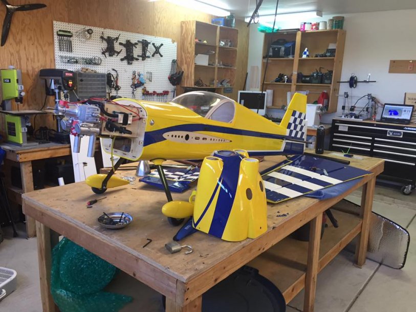

Doing some monthly maintenance and cleaning her up. Also adding some 3d printed baffles! Loving the new workshop
