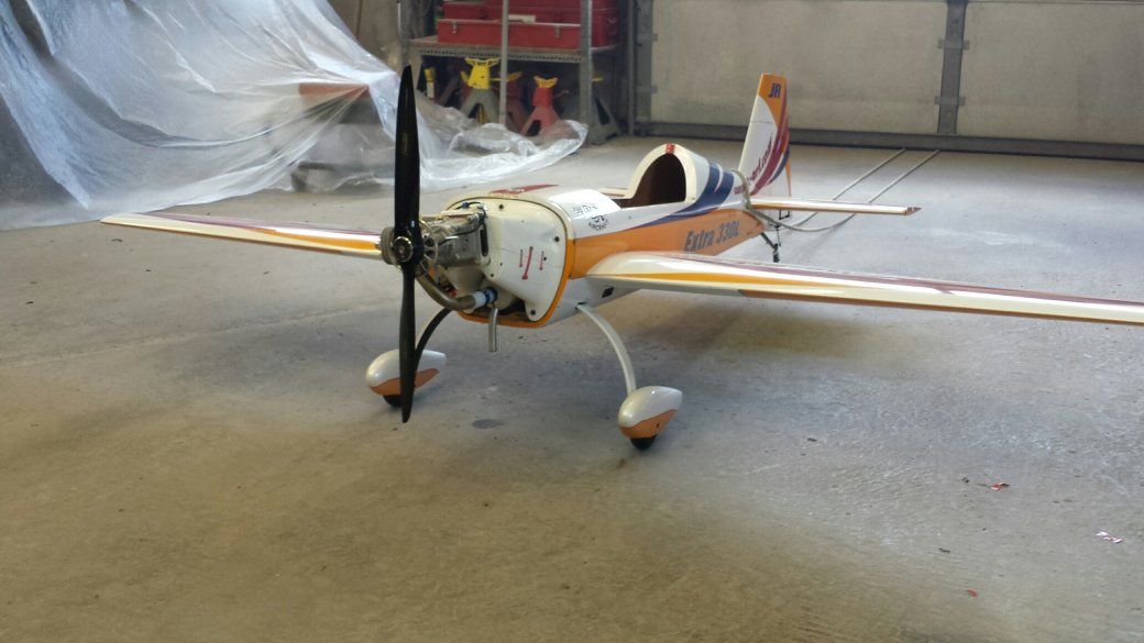

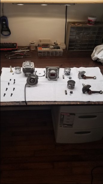

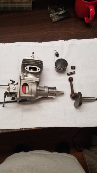

I took my GP61 powered Carf Extra to my shop yesterday to tune on it a little since I just went through the carb. I started with the needles at 1 1/2 for both high and low. By the time I was done I was right back where I started before going through the carb at 2 3/8 on the low and a little over one on the high. It seems to run pretty well, but I'll find out when I get to fly it.
One issue I had yesterday is the restarts when it's hot are pretty miserable, but at least the carb isn't leaking anymore.;)

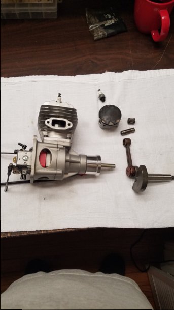

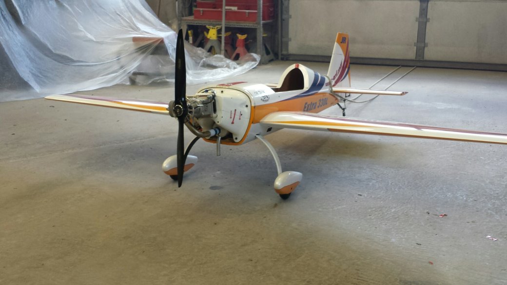

Hi @Jetpainter looking at the plane you have a 61 mounted at 90 degrees. Often though of doing that but never did. Did you any difficulty balance side to side. And cowl clearance. Use to do that with all my glow four strokes they ran much better. Why did you do it.

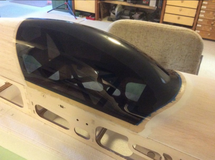

Well it has been bad weather for the last week got all my maintenance done and the ViperSt was just steering at me, so I decided to glue the canopy on, not a job I enjoy doing. If the weather continues like this the next thing to do is to do the final fit of the cowl with the engine just received the muffler from JTec.
