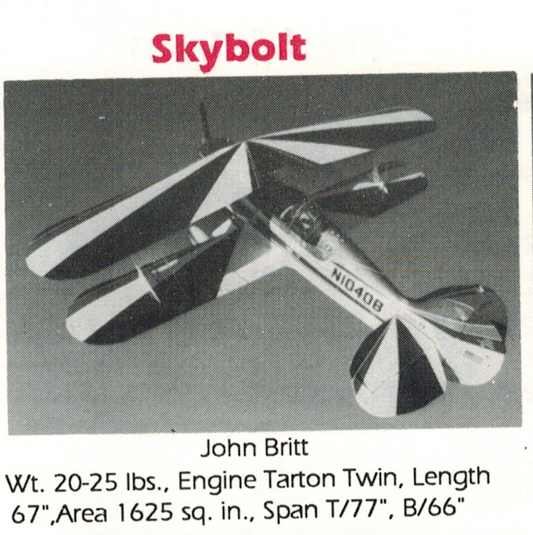

Your Skybolt looks AWESOME ! ! ! ! Thanks for posting the pics. I bet your YS pulls that Bad Boy around very well. The largest Skybolt kit I have found is the one listed in the PCK Catalog at 1/4 scale. Something makes me want to say it's a Wendell Hostettler kit, but don't quote me on that. The issue now is that, from what I've read elsewhere, Larry Katona has not been in good health for a while so I don't know if you can even get one.
I wonder if Leo got the molds for the one RC City used to sell when he bought up all their stuff.

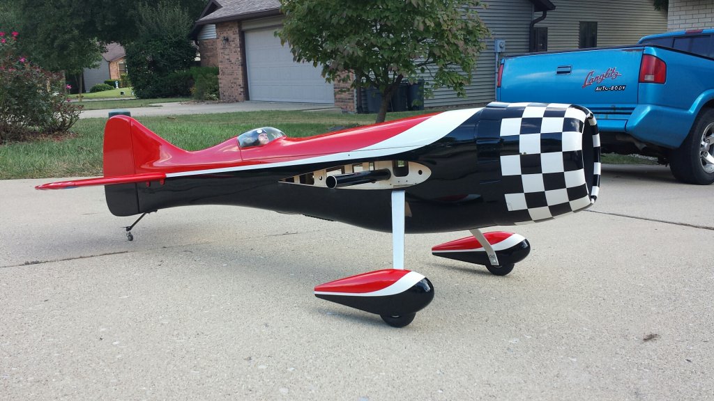

So worked on the sukhoi some. When I put it together I didn't have any aluminum standoffs for it so I just used the ones I had made from steel on my scratch built cap232. Well I sold my Carden cap as just an airframe leaving me with a DLE 55 sitting on the shelf so I decided to pull the aluminum stand offs of of it and move to the sukhoi. Weighed it all first. Steel ones weighed 13.7oz for all of them and the aluminum ones where only 3.2oz. So 10.5 oz removed from the nose. Prolly gonna be able to feel that in the air and should move my CG rearward as it seemed pretty nose heavy to start with. 45 up line roll inverted and the nose drops instantly. Will rebalance it in the next few days to see how I need to rearrange my flight batteries.
