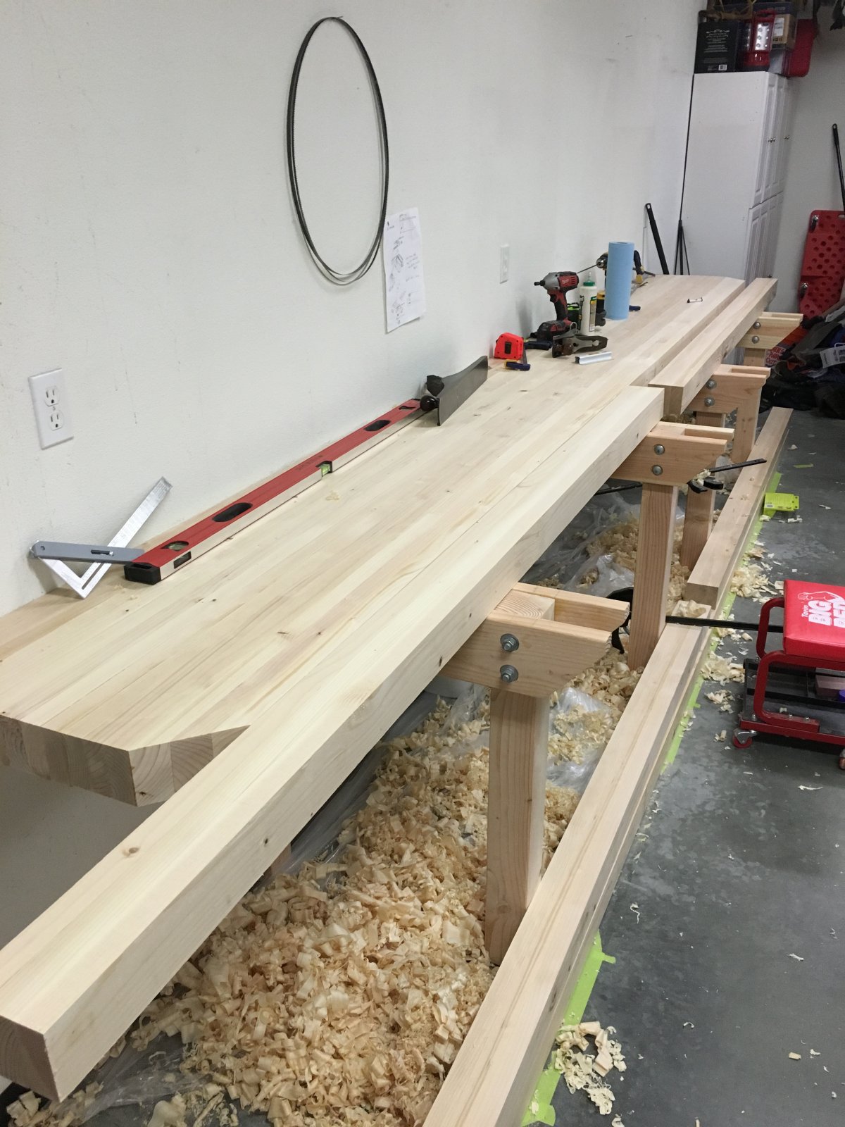

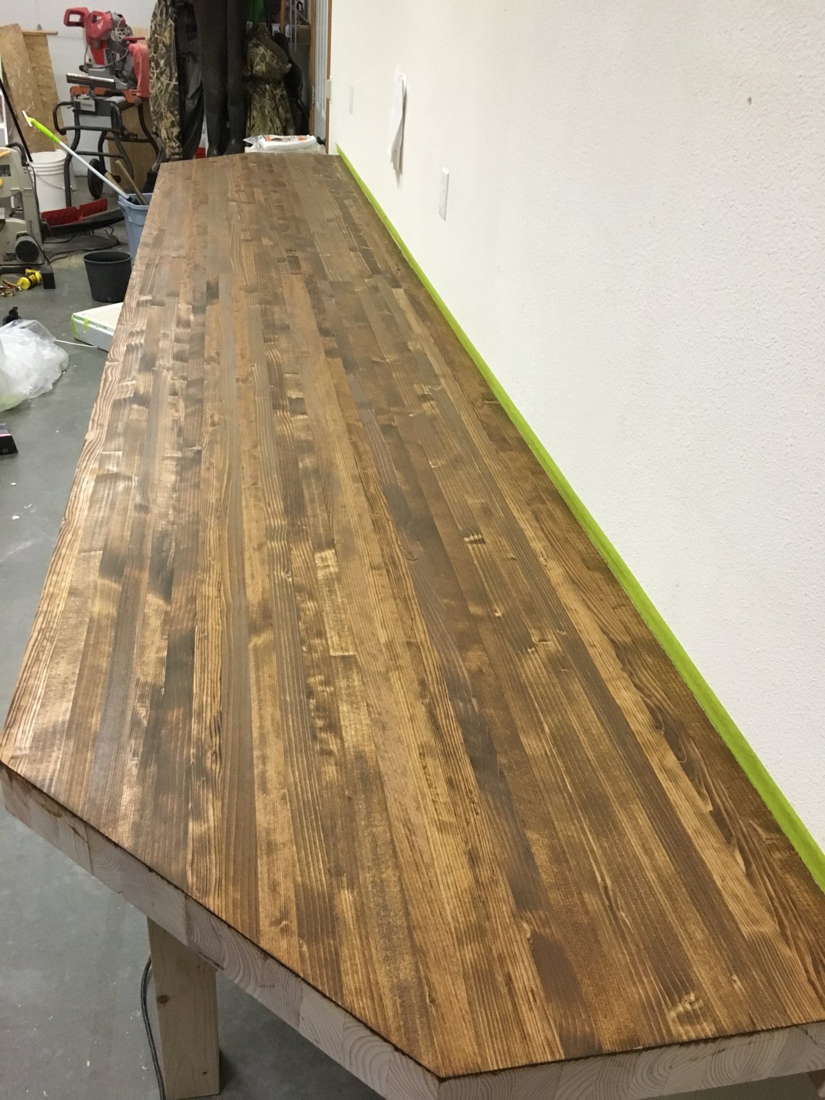

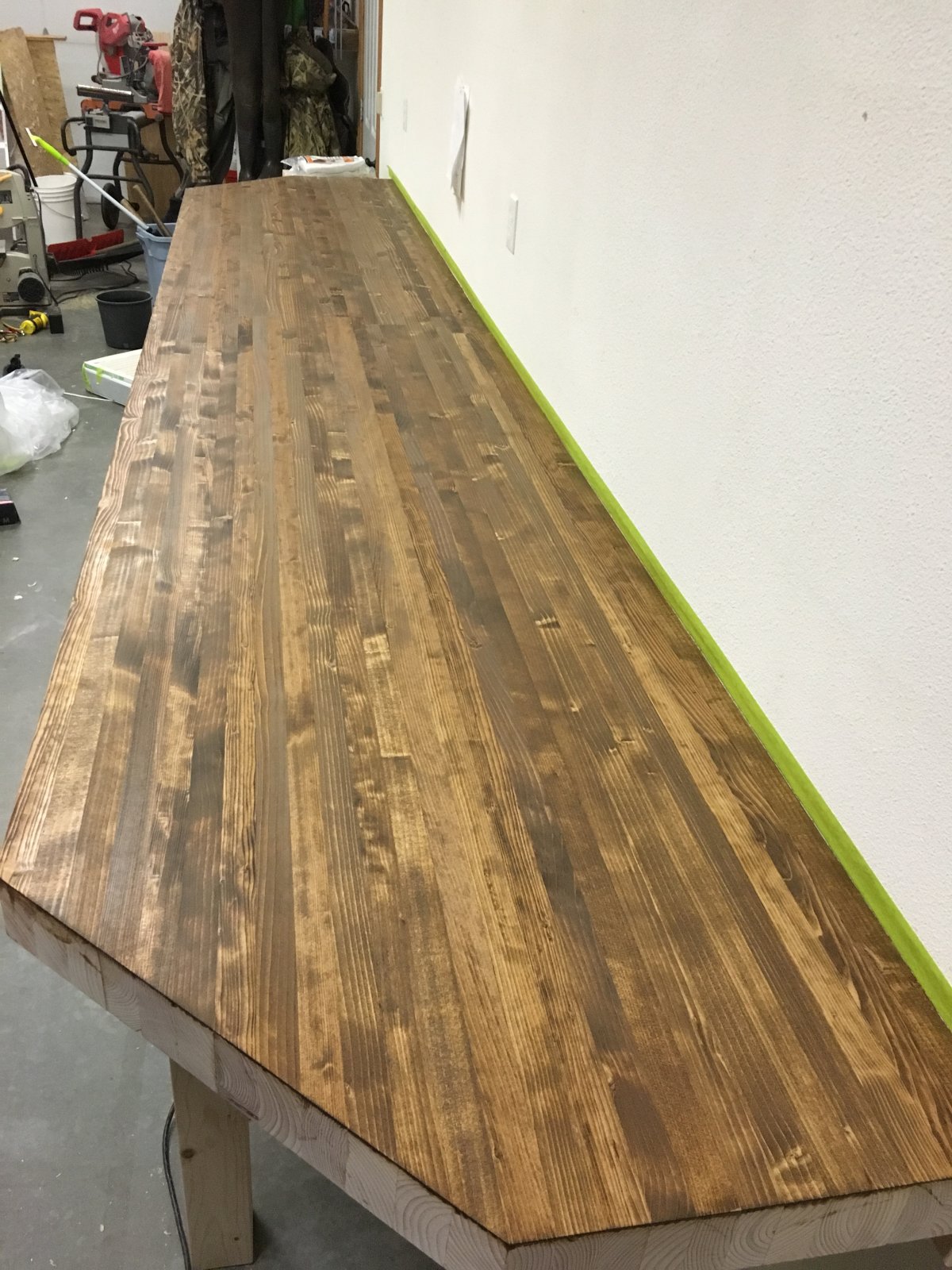

View attachment 88644 My workshop project... Is... Well... My workshop bench! 2x4's glued together, plained, sanded, and finished with Danish oil. This bench is overkill but designed to a 50cc tail won't hang over the edge.
Did you put any long threaded rods across the bench. Built a similar table some time back it was out of white ash. It was made from 2 by 5 wood and glued and clamped together. But after about 10 years it split. Not happy after speaking to a wood experts he said you should have drilled holes across the table and bolted it.
AKNick
I glued sets of three 2x4x8's, plained them, then used 8" timber locks to tie them together. They are then pocket holed from the lower support to the 2x4's then hand plained on the top... A lot of work
