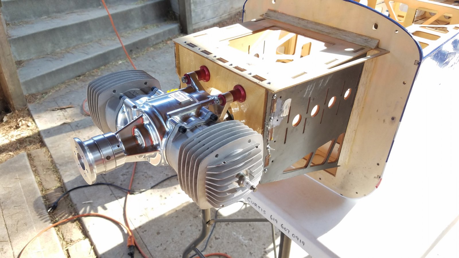

What engine did you end up with? ZDZ 180? I have a a couple of unused props, switches, batteries and an ignition kill switch. How about some pics of that bad boy?

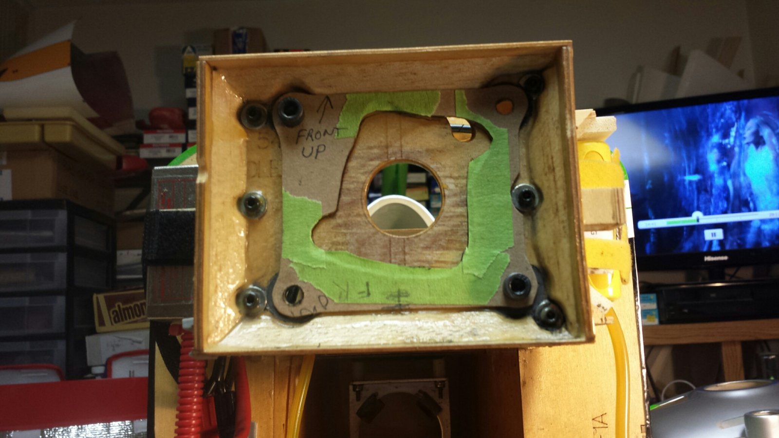

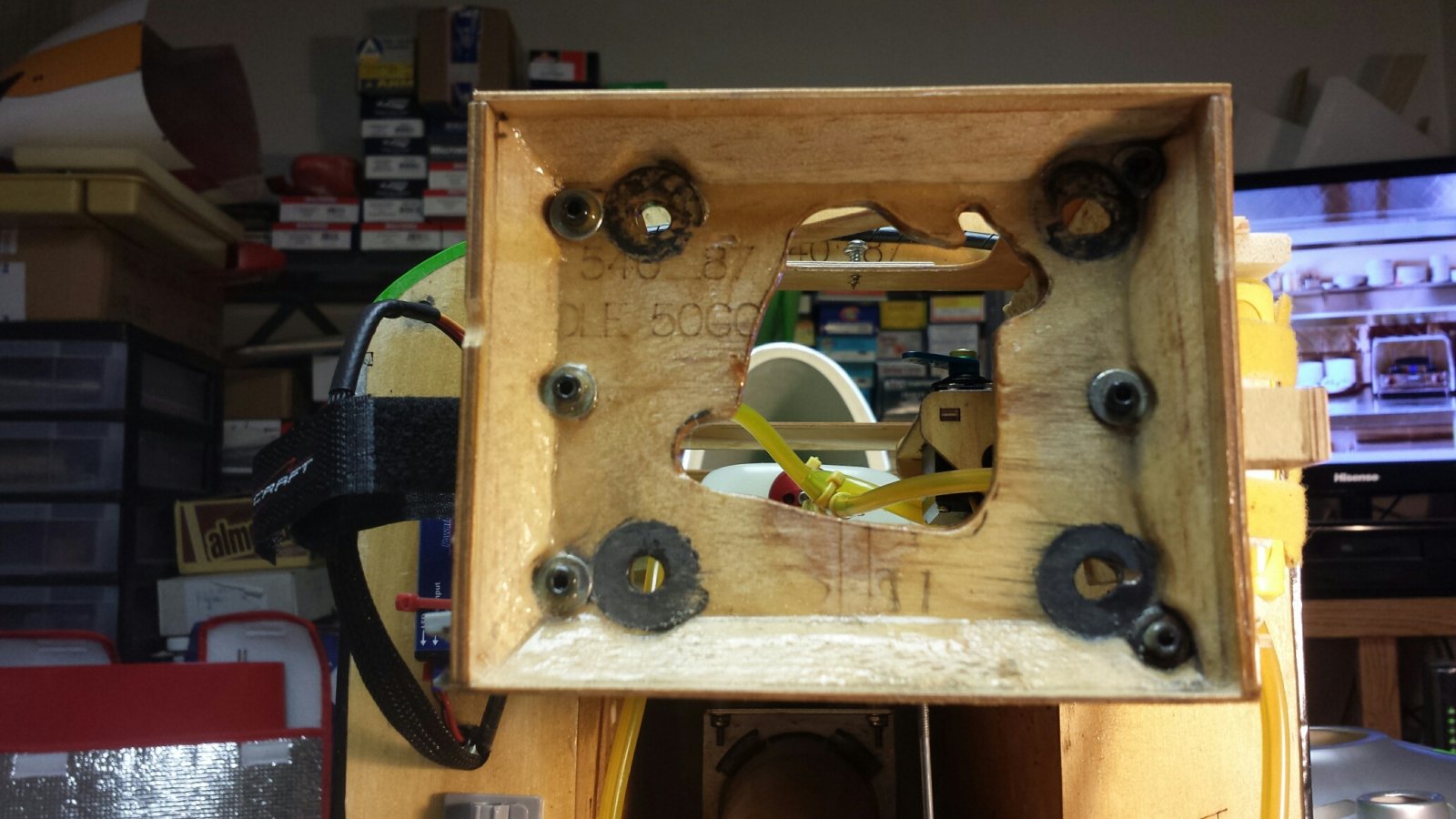

I've been working on swapping the DA50 in my Pilot Edge for a GP61. The DA has been absolutely the most reliable engine I've ever owned, but the plane needs more power and the GP61 can certainly provide that.
For something that is basically a bolt in swap, this is taking forever. I needed to cut a much larger hole in the firewall so I made a template to make it as small as possible, but still fit.

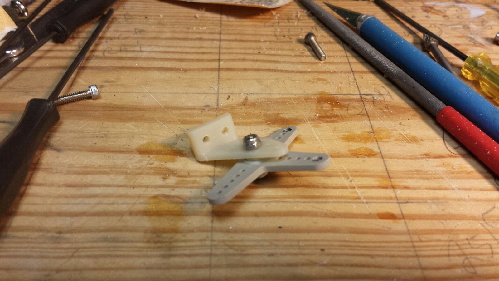

The choke linkage has been a pain. I've spent more time looking at it trying to figure a good way to do it than working on it. When I had the GP in a Carf Extra it was mounted at 90 degrees and I was able to run the choke rod through the housing and out the cowl opening in the front. In this airplane it would have been too long with lots of bends and would have been nothing but trouble. The way the GP is setup the choke really needs to go out the rear, so my options are add a servo, or use a bell crank and take it out the side or the bottom. I decided on the bell crank and going out the bottom. I made a bell crank out of spare parts that should work fine. This afternoon I hope to get it all finished so I can fly it tomorrow.
