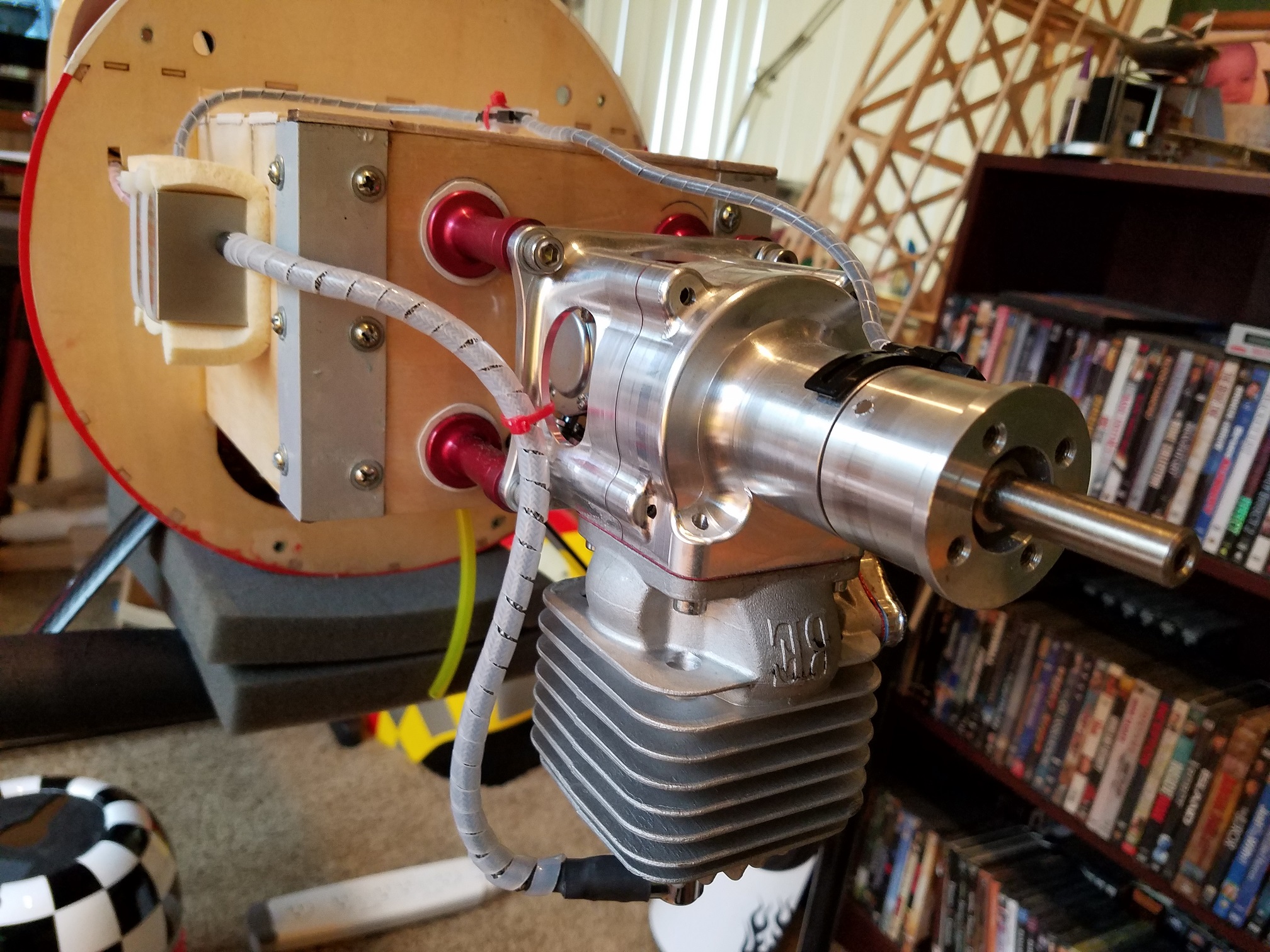

First, off with the spinner, prop and cowl. Nice to see things just as they were when I put the cowl on. Nice and clean and organized.
Well except for this....!!! Ugh!!!

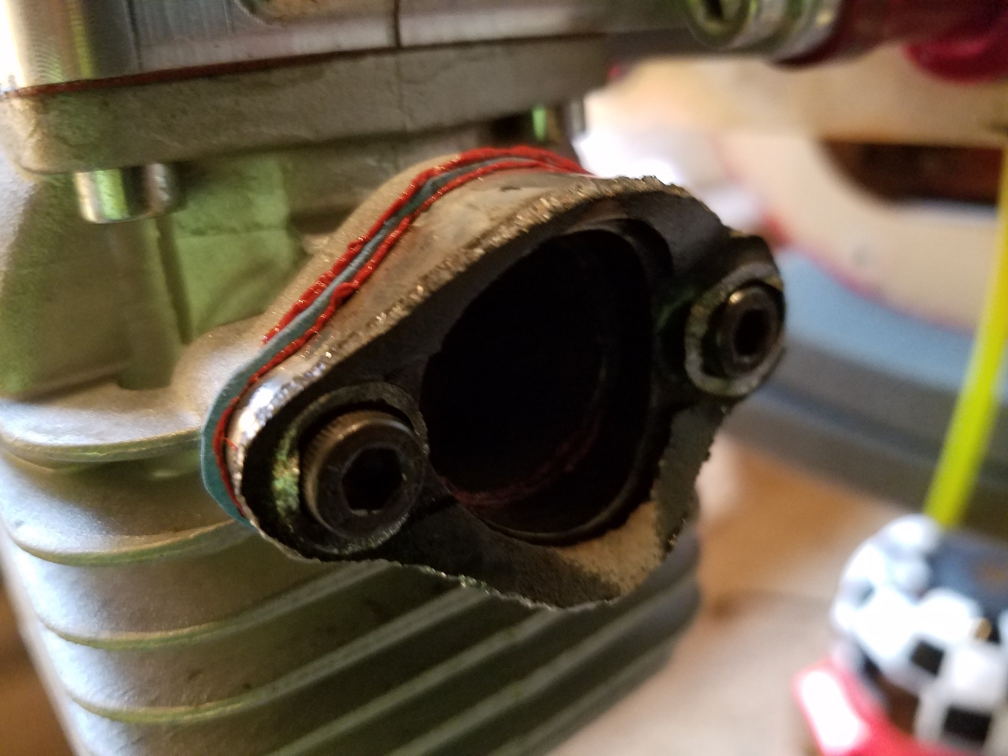

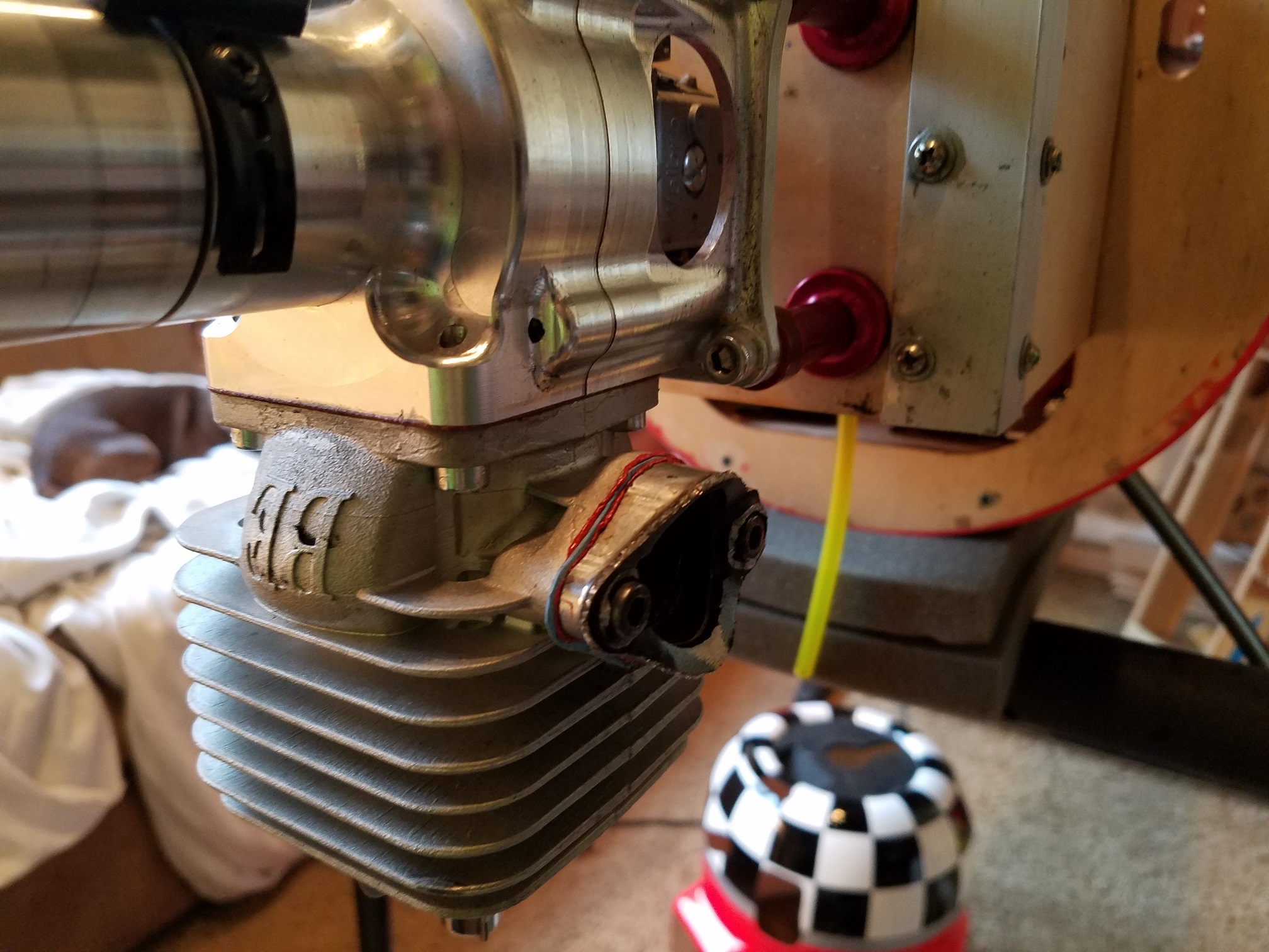

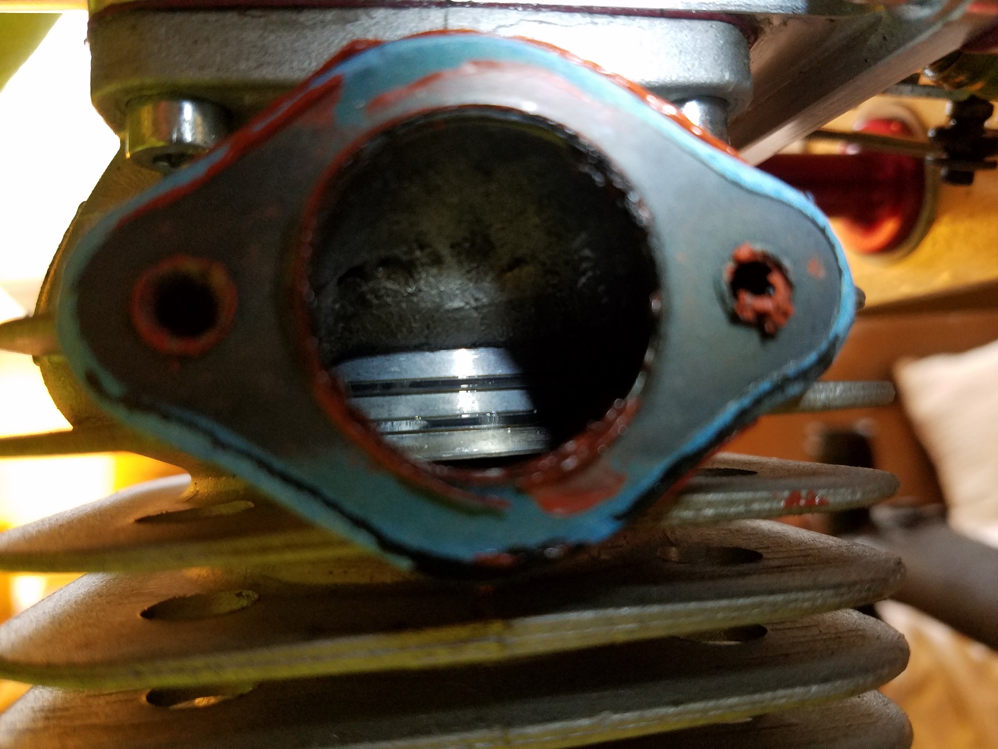

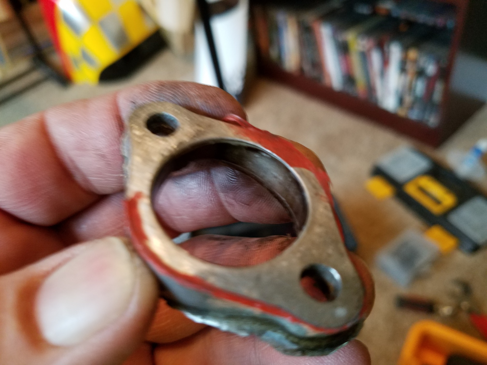

Goofy as it may be, apparently the aluminum muffler just was too weak at the flange joint. Oh well, we're gonna rectify this. First though, a quick looksy at the double ringed piston. Clean and well lubed. Gotta love that Redline.

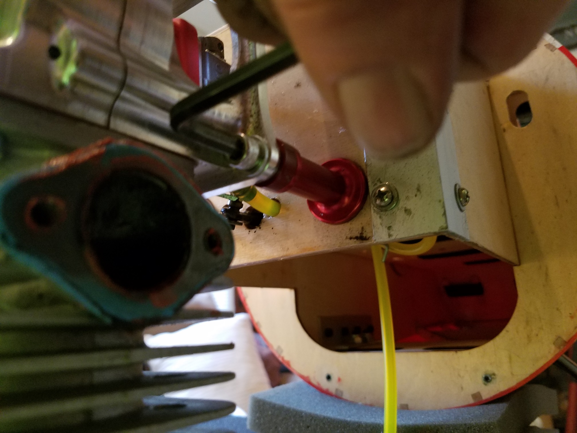

Also took a minute to double check the torque on all mounting hardware and bolts.

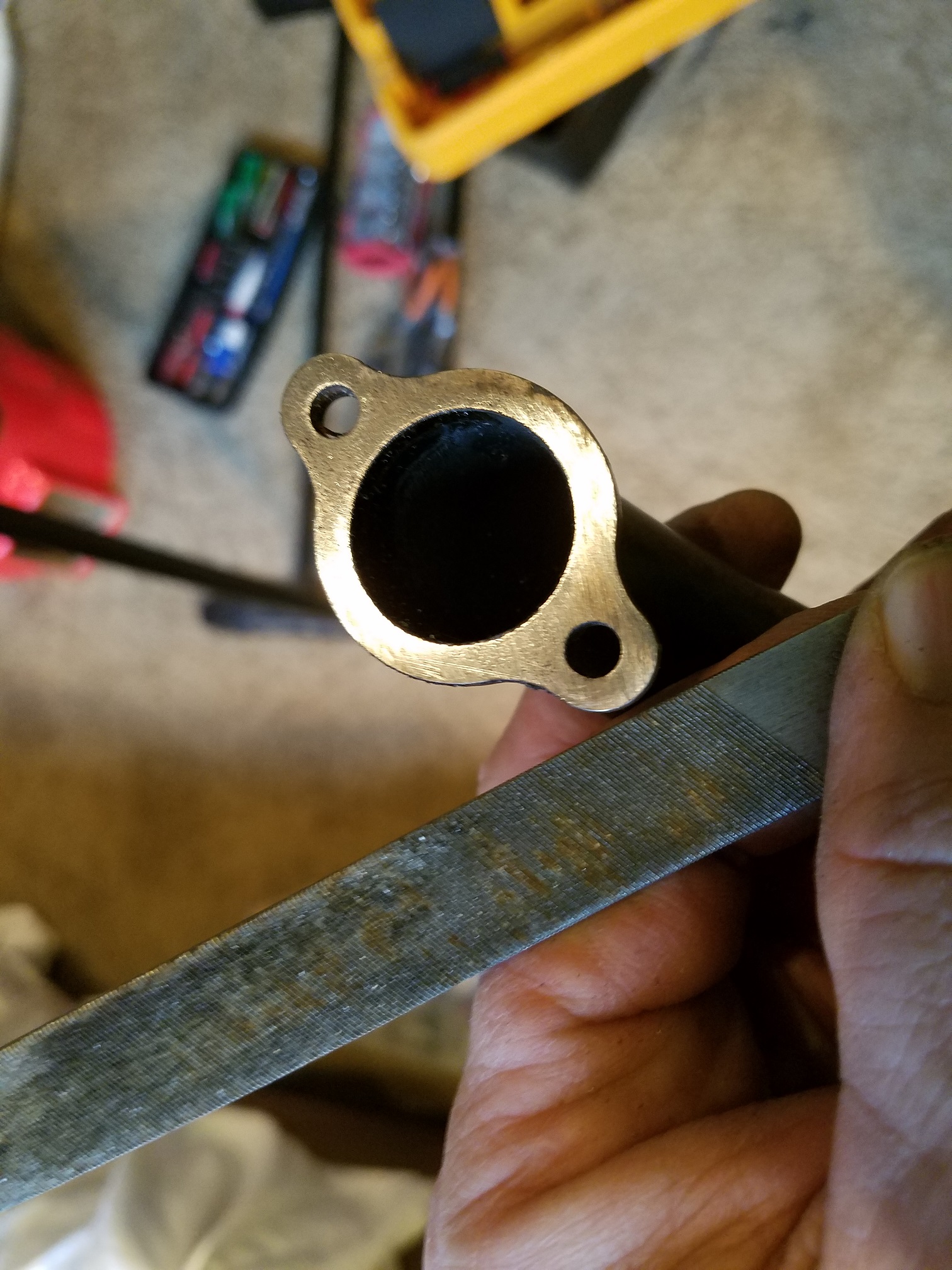

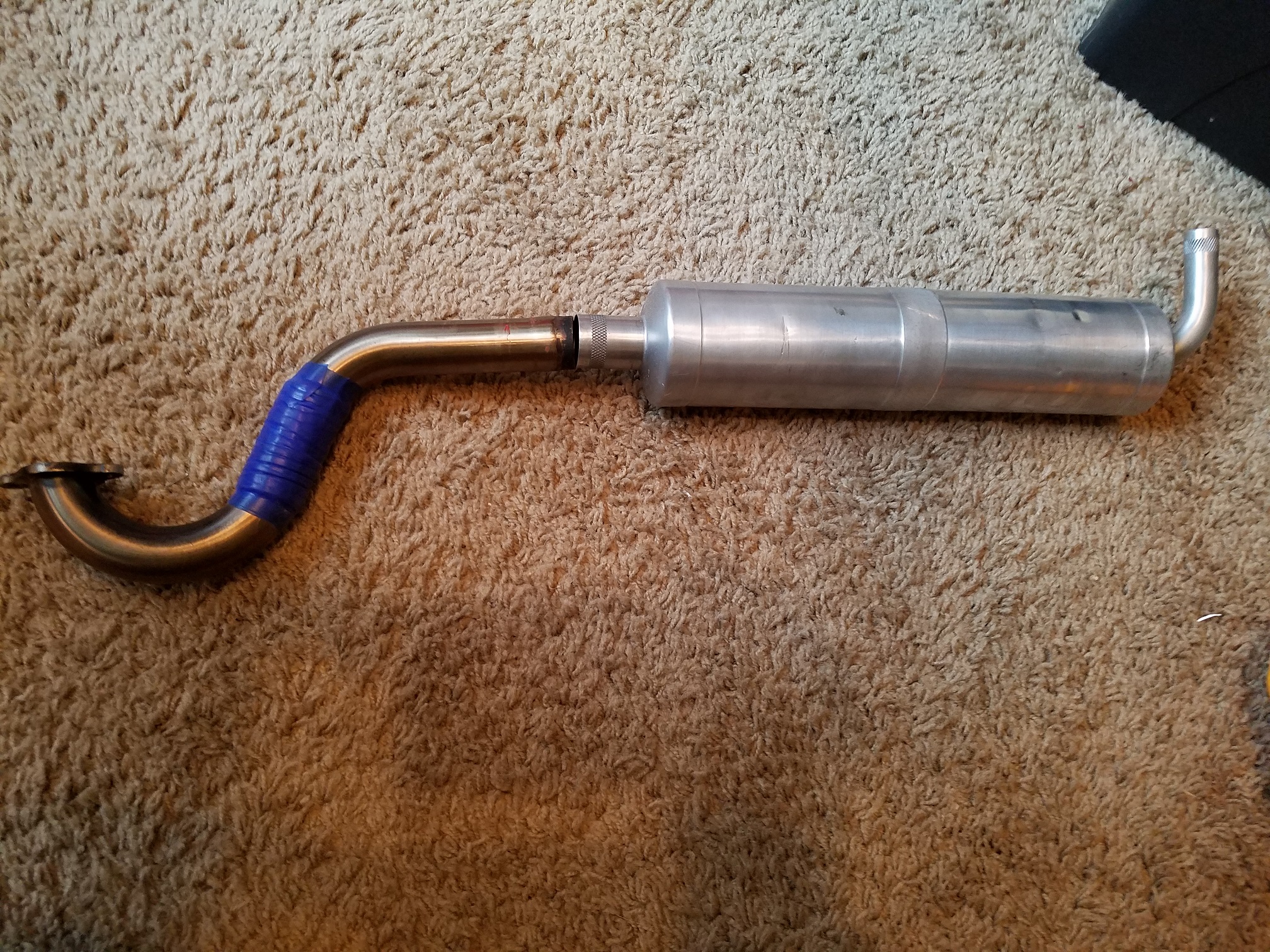

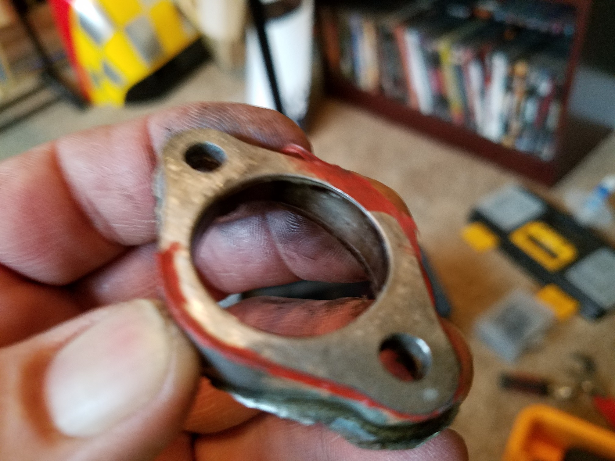

Ok, on to the header and canister install. First, a little clean up of the mounting flange on the DA 60 flex header with a flat file. Just making sure the surface is clean.
This is the intended replacement exhaust setup. DA 60 Flex Header and KS 60 canister. I may have to go to an MTW 75 for better flow, but I am going to try the KS 60 first.

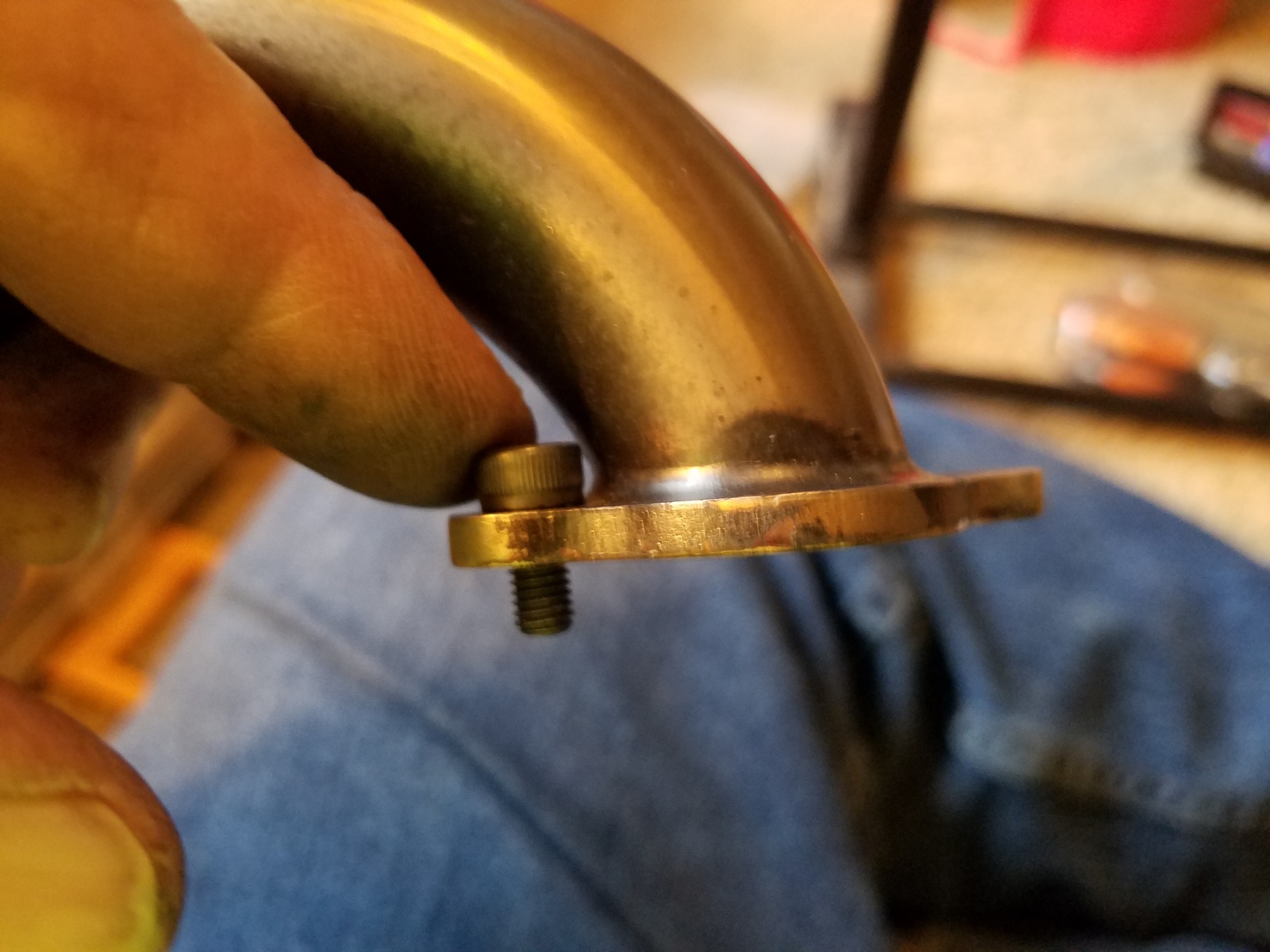

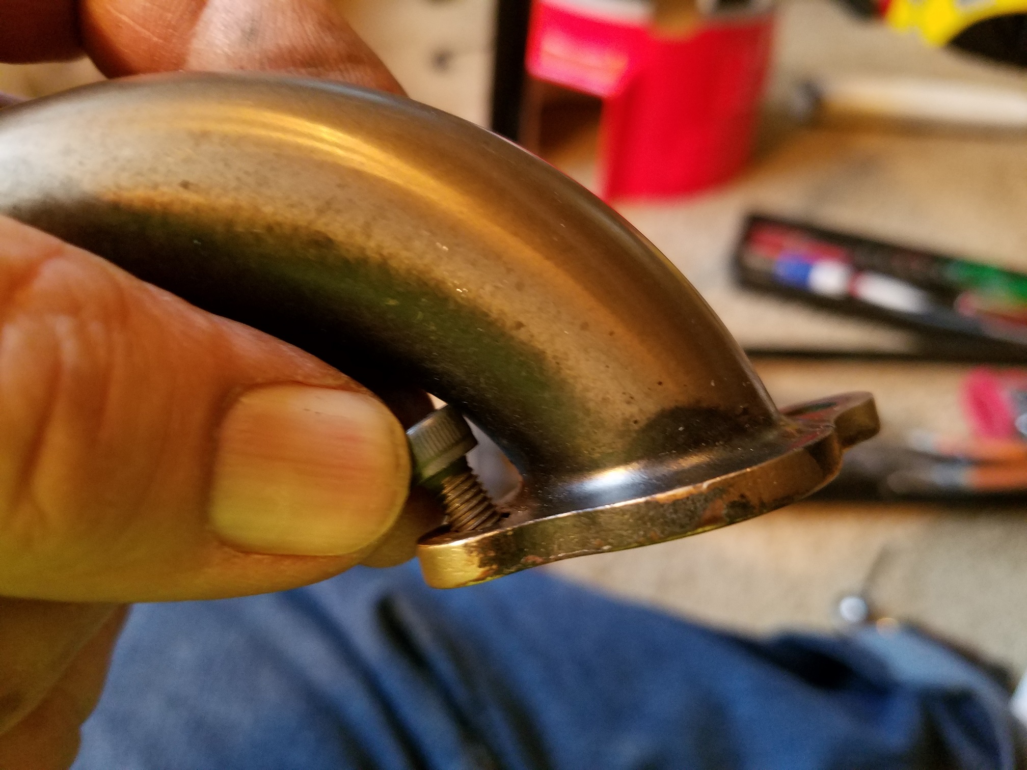

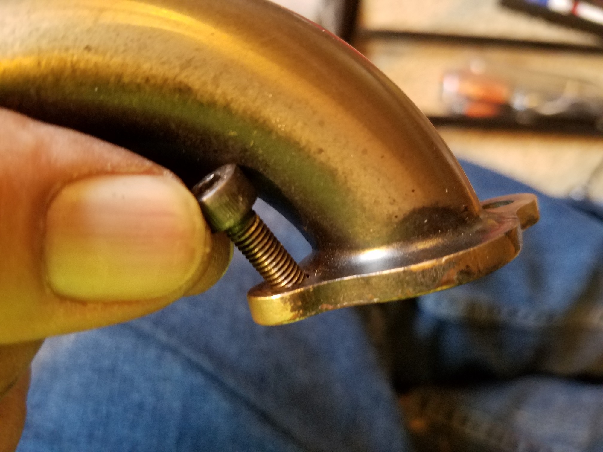

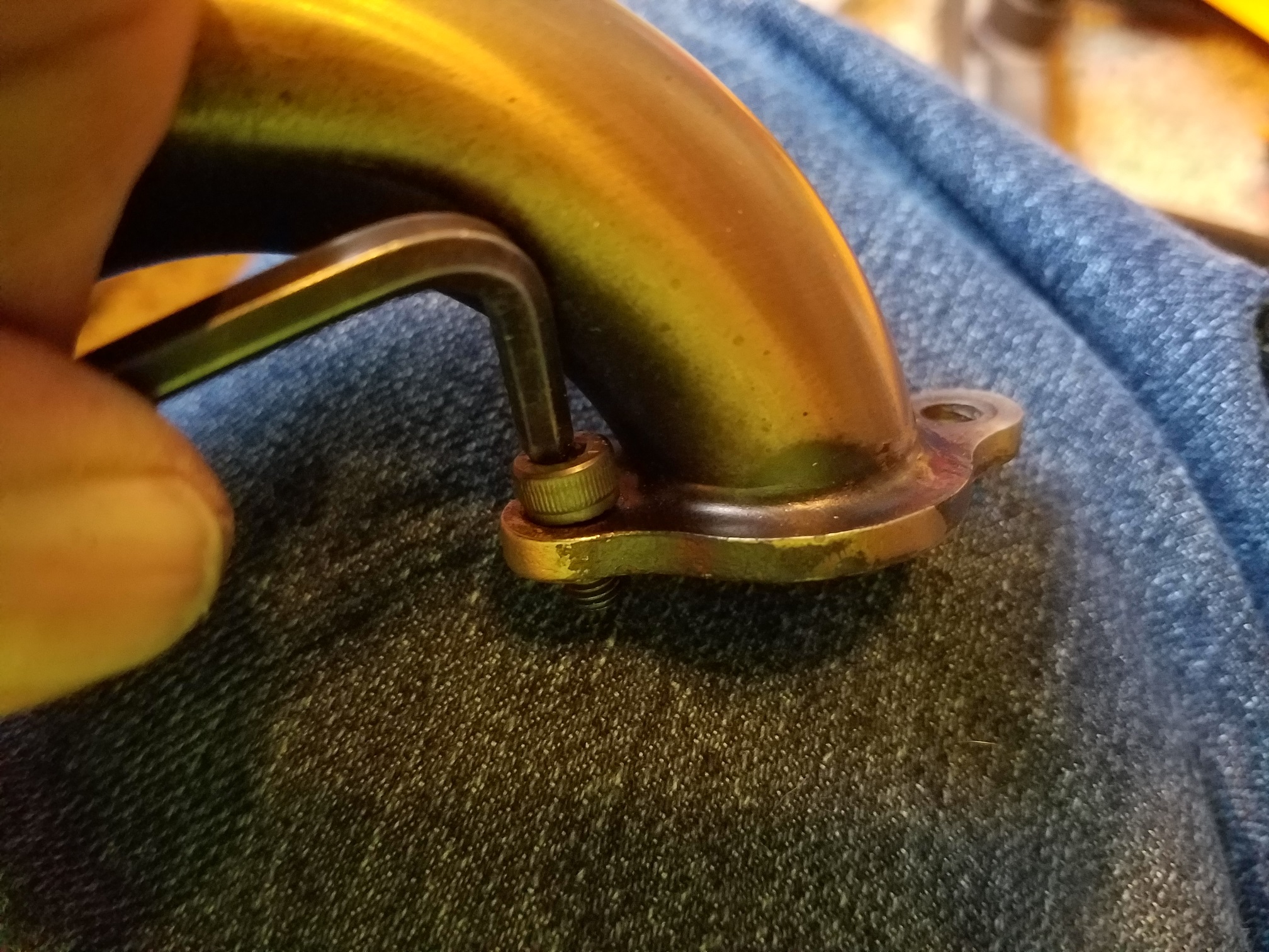

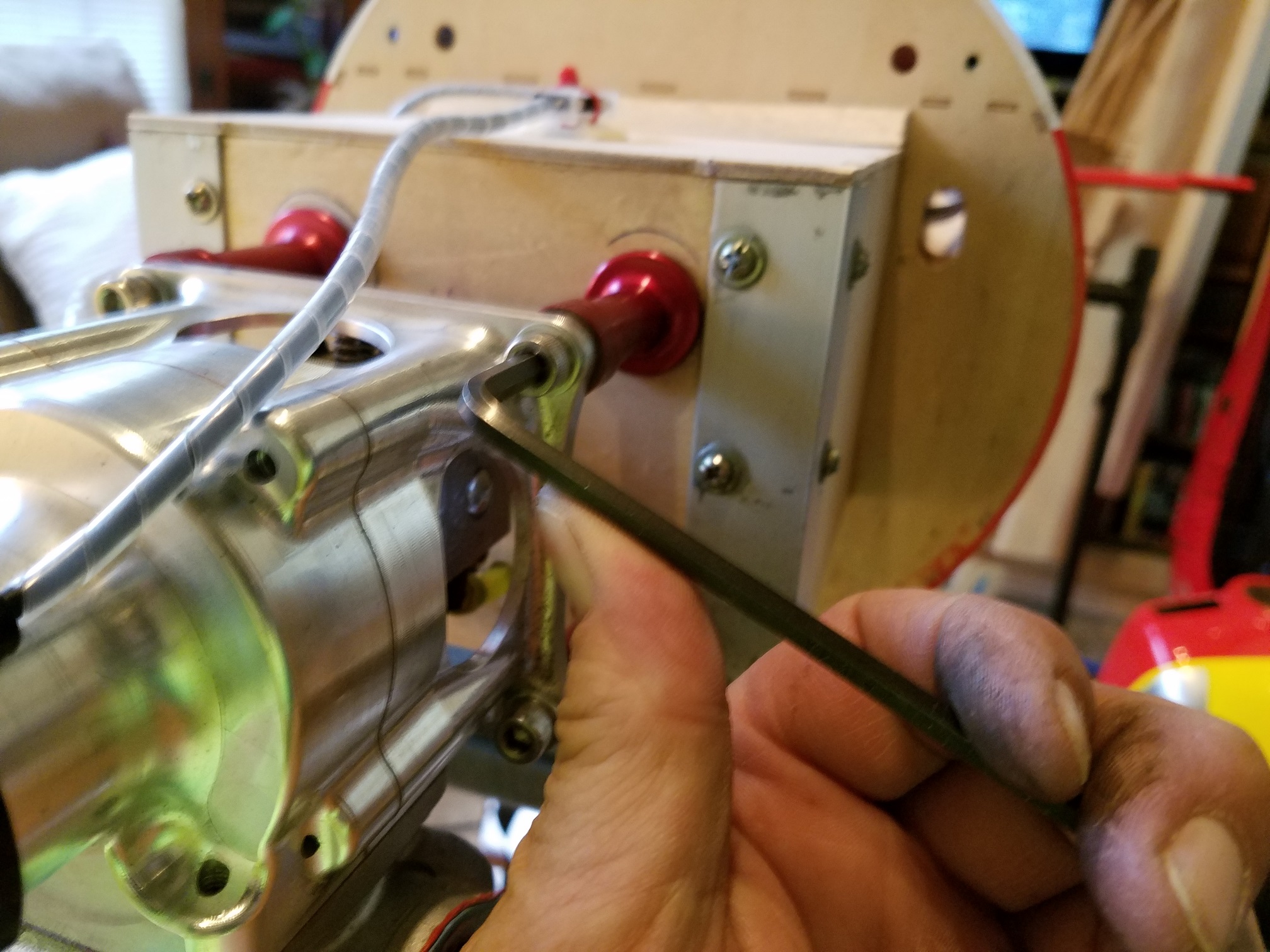

The first and only real hurdle in this setup is going to be the header mounting flange. The bend of the header as it exits the flange is just too sharp of a bend that it is next to impossible to get a bolt in there. Perhaps this is why the gent I bought the nearly new header from sold it so inexpensively? At any rate, even the shortest bolt I have is difficult to get in the flange. And even that will not facilitate inserting a hex wrench to tighten it. Not to mention, just way too few threads to feel comfortable with. I certainly don't want to strip the cylinder threads out.
