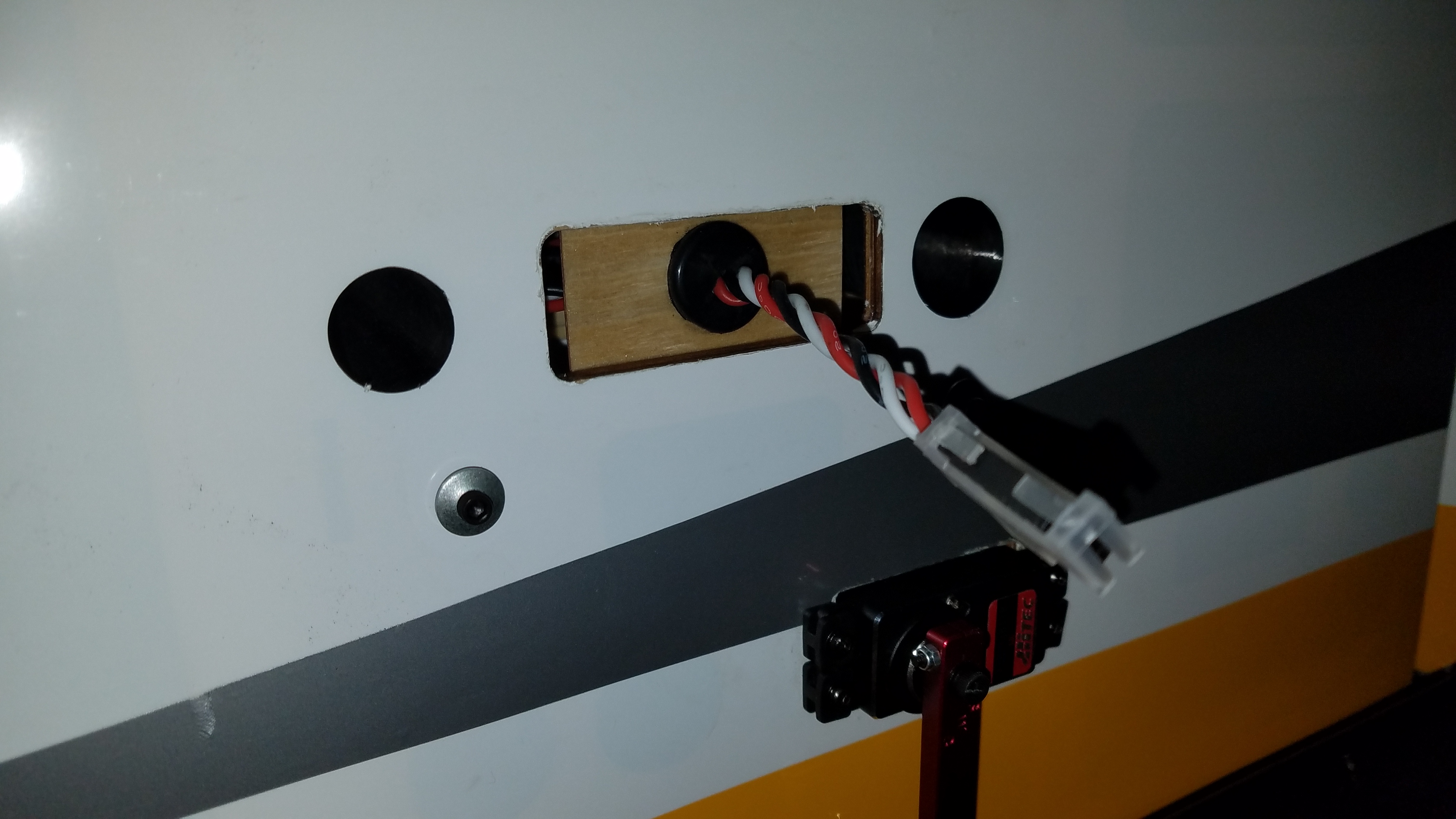

Finished repairing one wing. I just so happened to have all the covering for this repair which was a bonus.

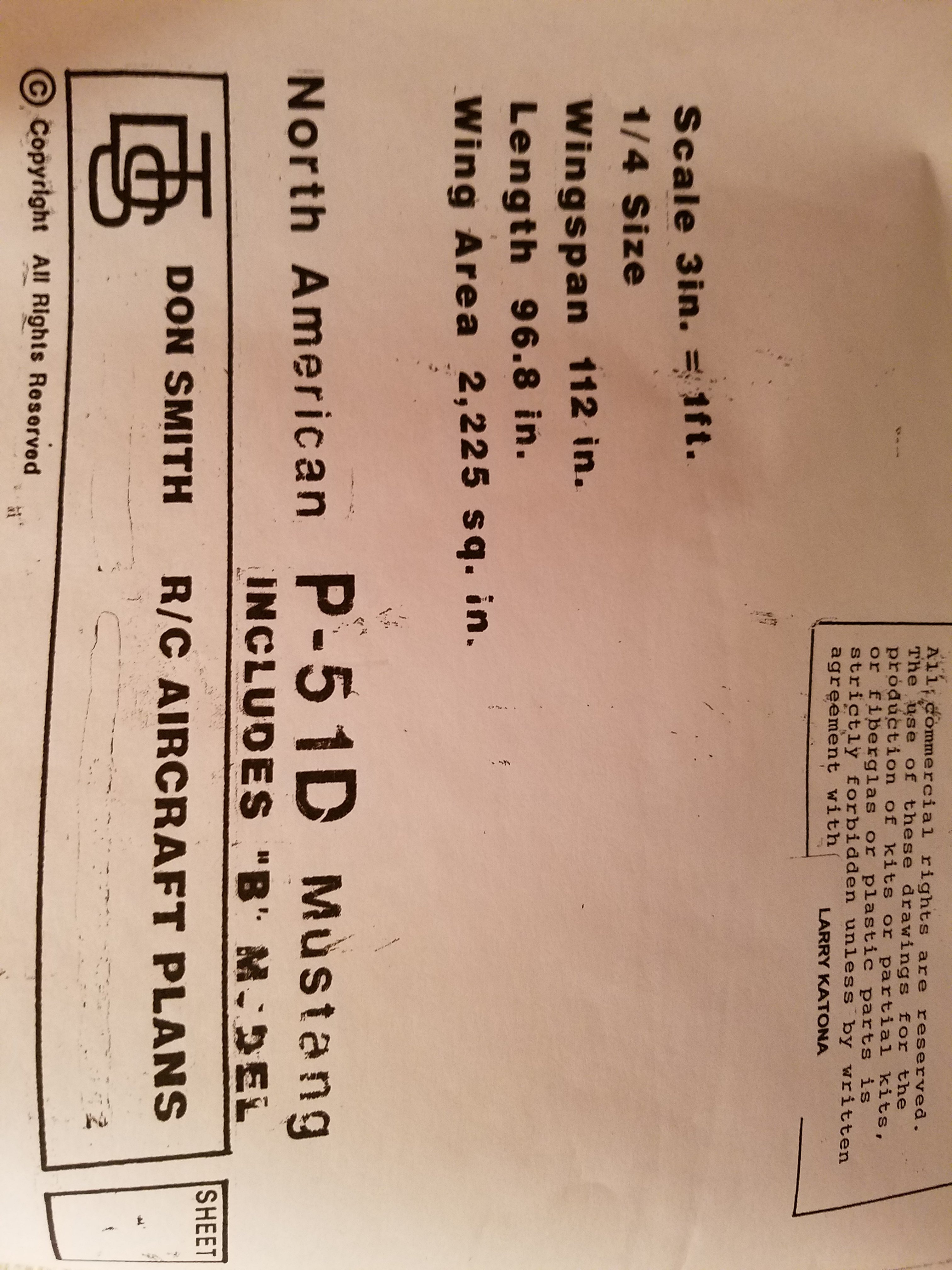

A little break from the 330 for a couple of days. But I promise to get back on it. In the meantime I decided last evening to take another gander at the 112" Don Smith Stang plans.

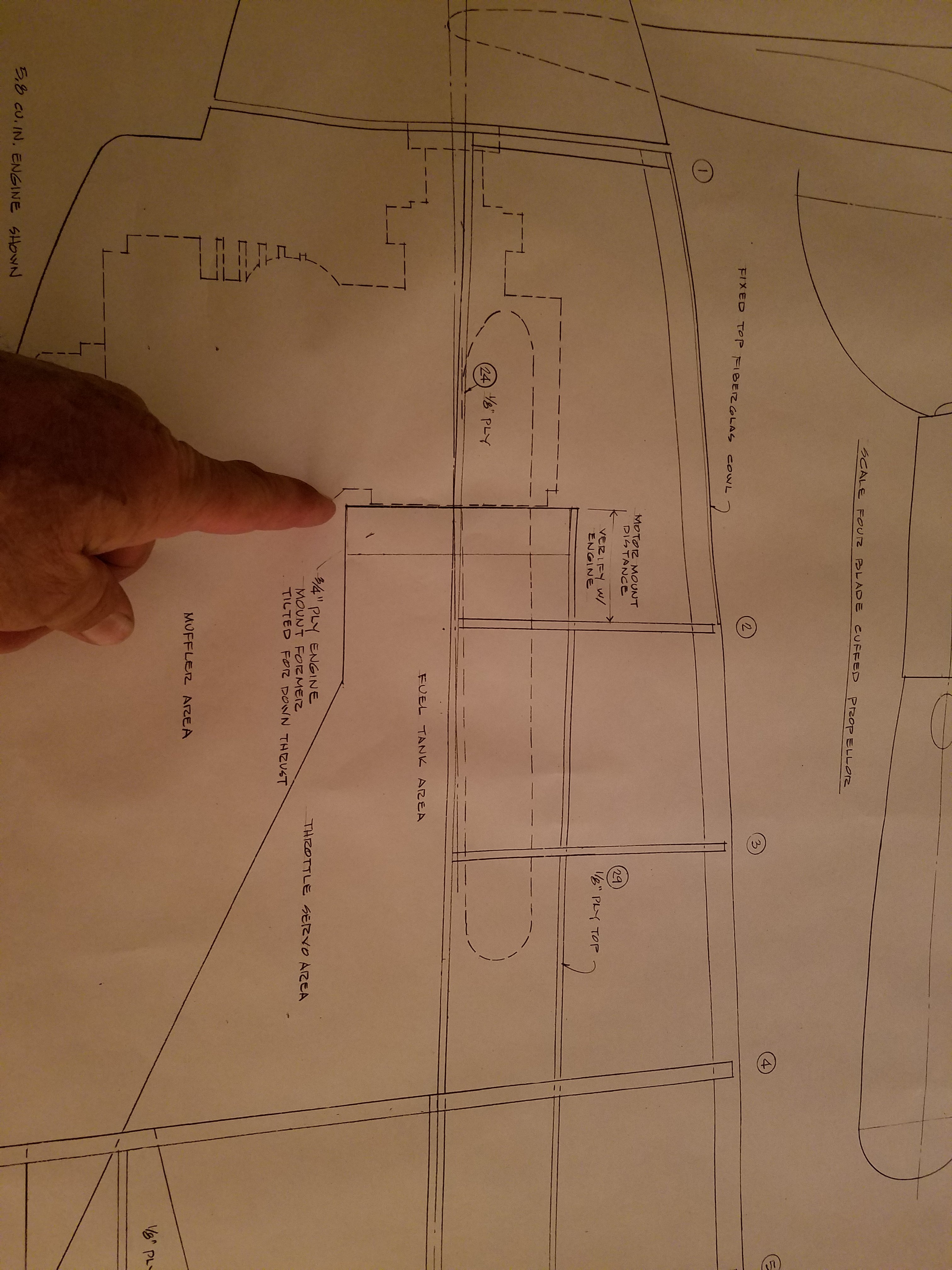

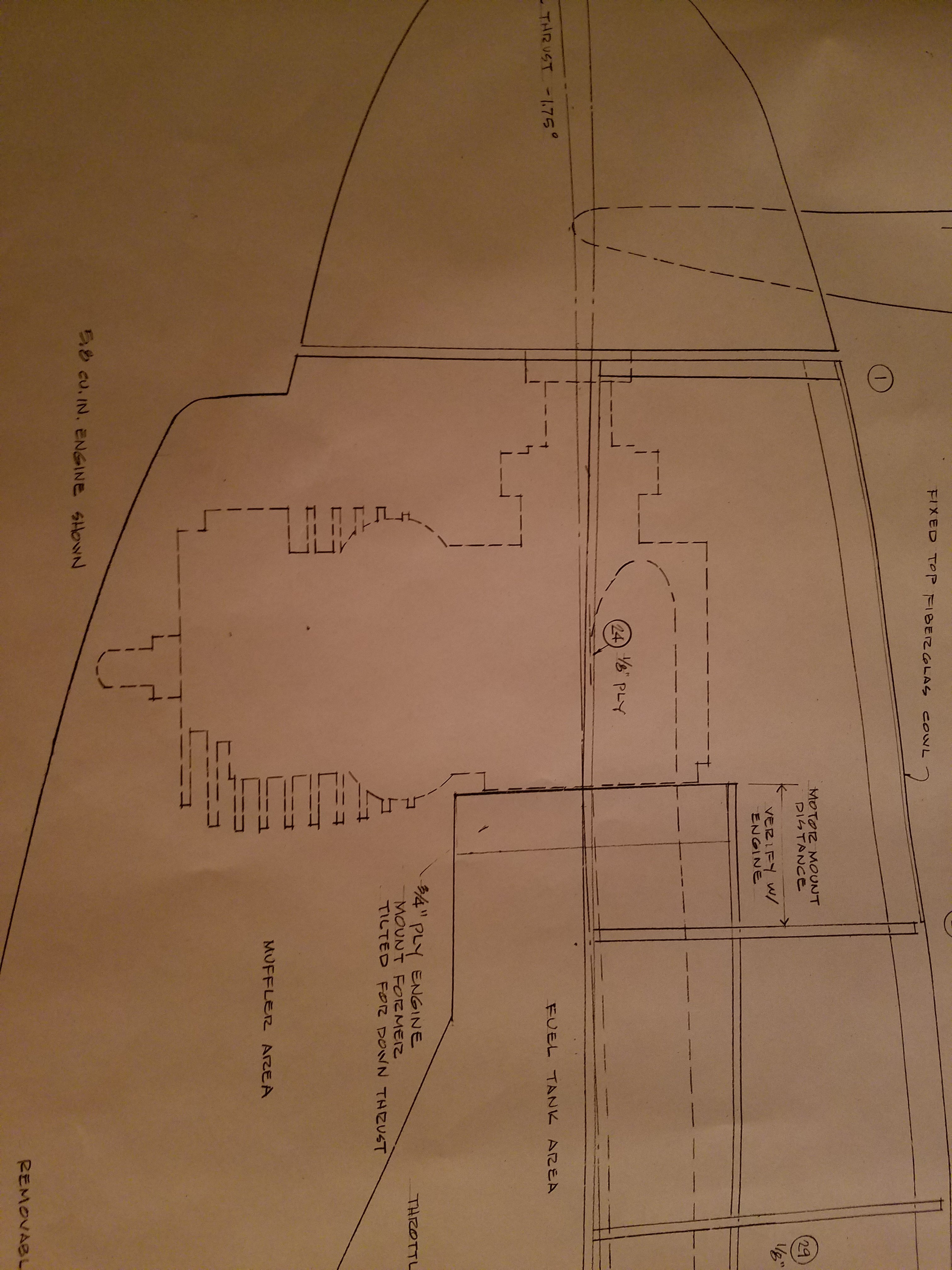

When i first committed myself on this bird, I wasn't sure of the engine I would be using. That was "YEARS" before I made the discovery of my love/lust for the red headed beasties. Let's fast forward to present day. Unless I win the lottery... (or marry a filthy rich red head) I highly doubt anything other than a dub 110cs inline twin will be the power plant for this project. And even that will be half a months wages. Sheesh...!! But that is set in stone, so let's take a look at a minor modification. The plans show and the plane was designed around a 5.8 gas engine. At roughly 95cc, the 5.8 would do fine. Except, I want the 110cs for the emergency power. Lol. Clearly the 5.8 fits very nicely in the nose.

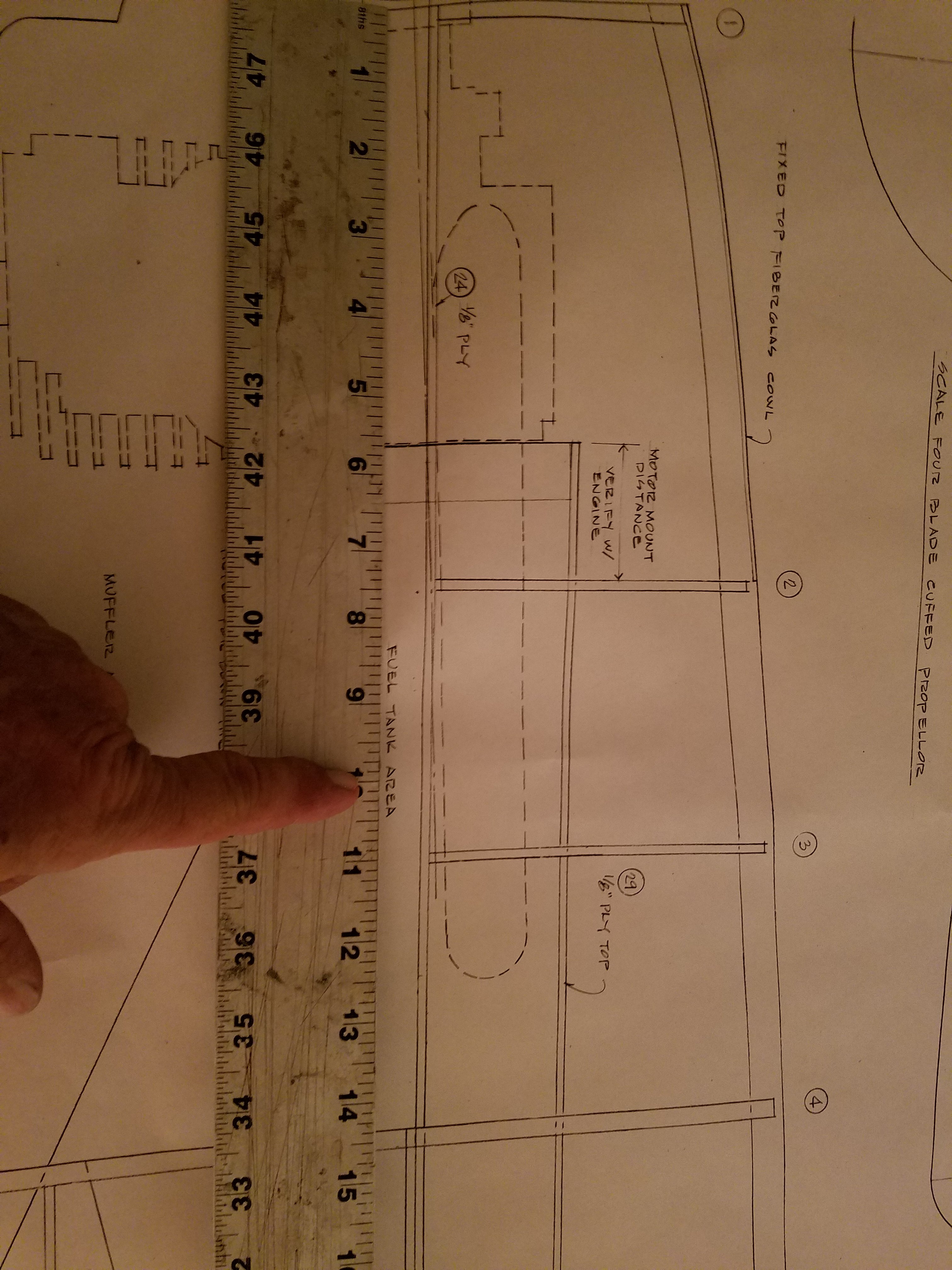

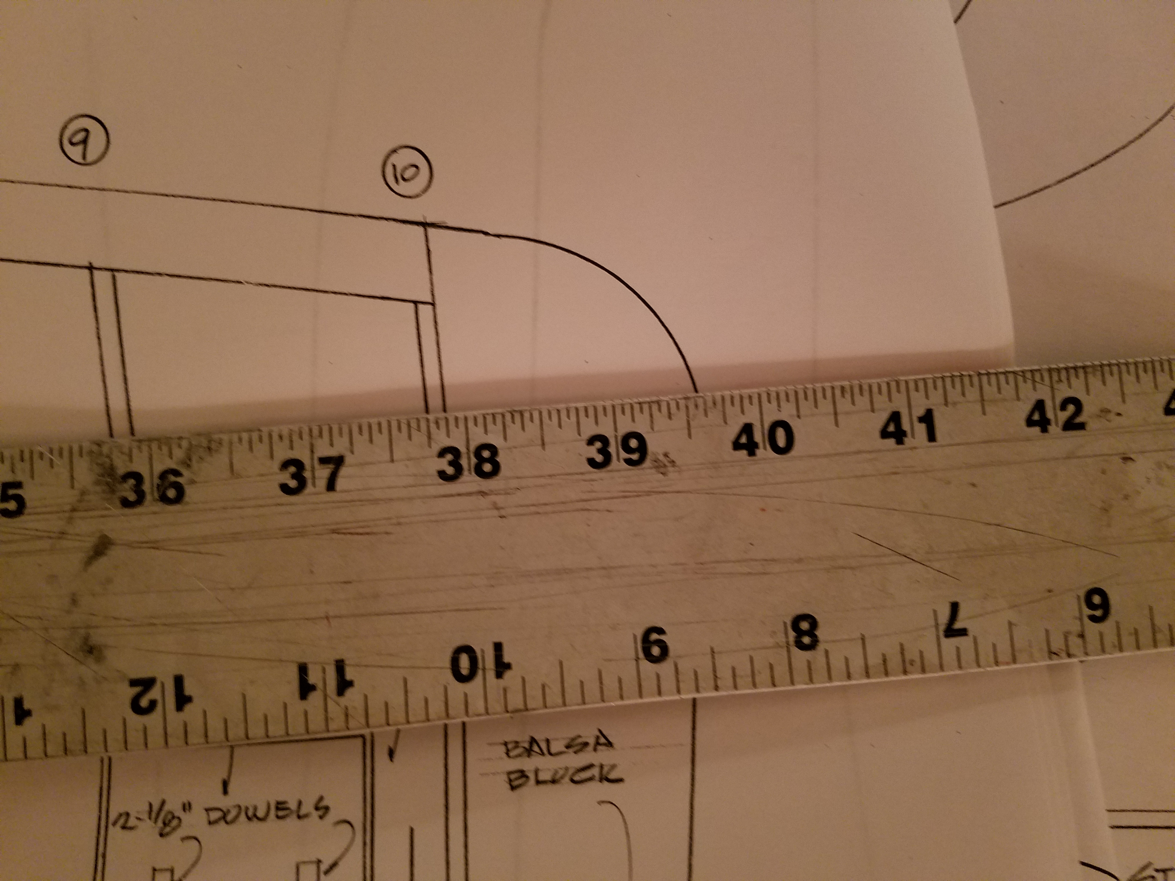

The modification I will need to make is setting the firewall back far enough to accommodate the length of the inline red headed beast dub. At 249.5 mm, (9.8 inches=9-3/16") it will be necessary to allow for the extra length.
Simple task, right? Guess we'll find out.

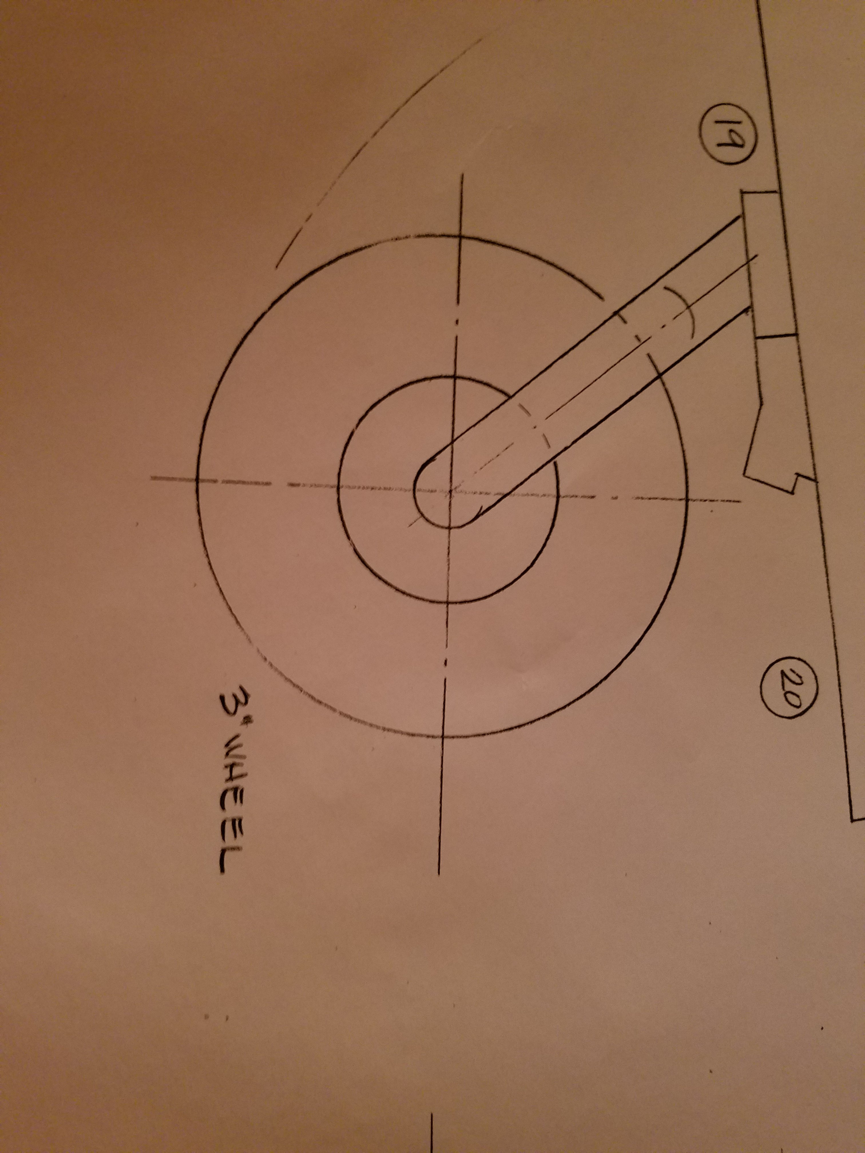

I'd forgotten just how big this bird will be. A 3" tailwheel and a stab at nearly 40" tells me right quick she won't be no glow (shudder) sized warbird.

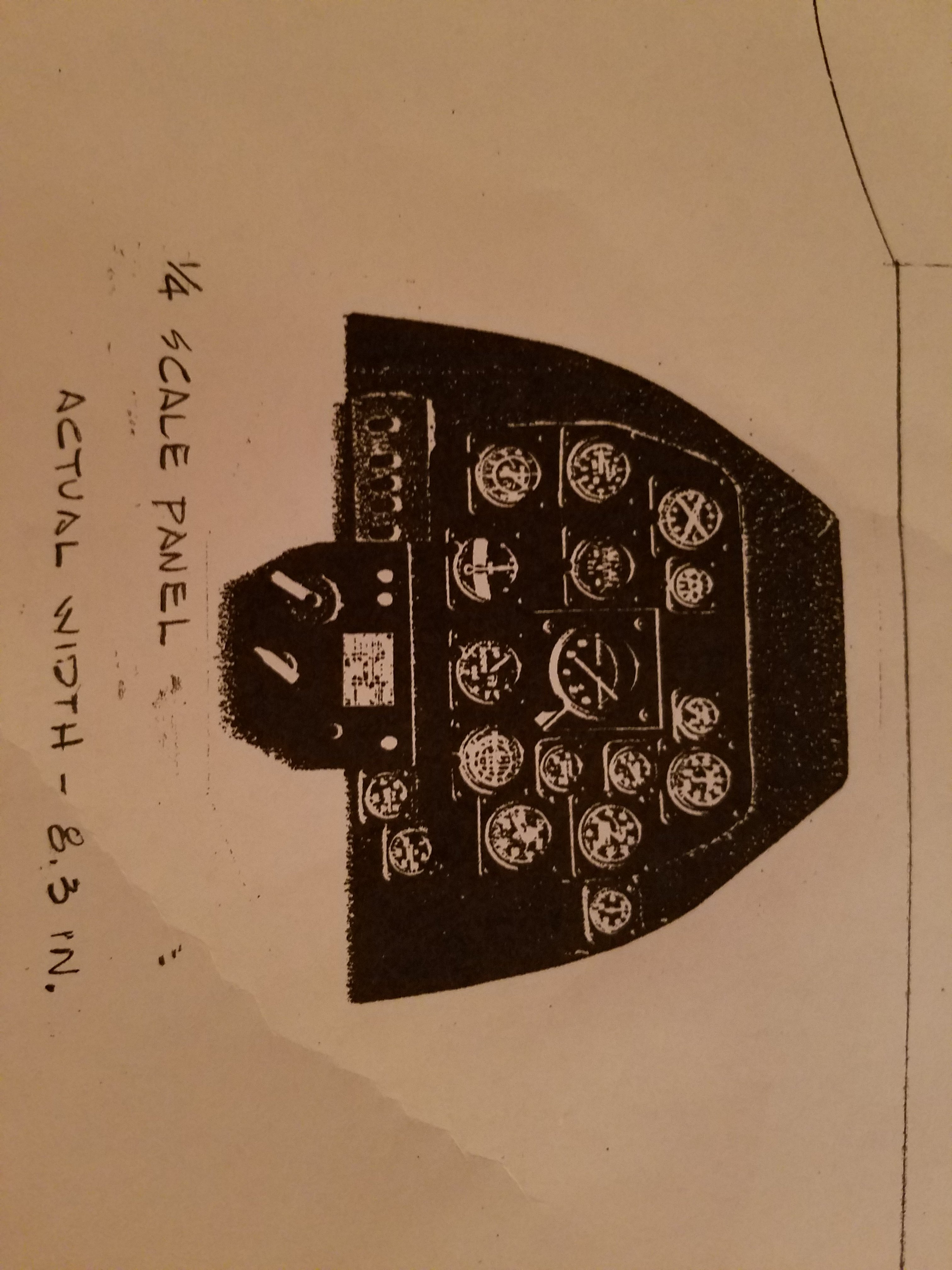

Heck, even the instrument cluster will be over 8" wide.
