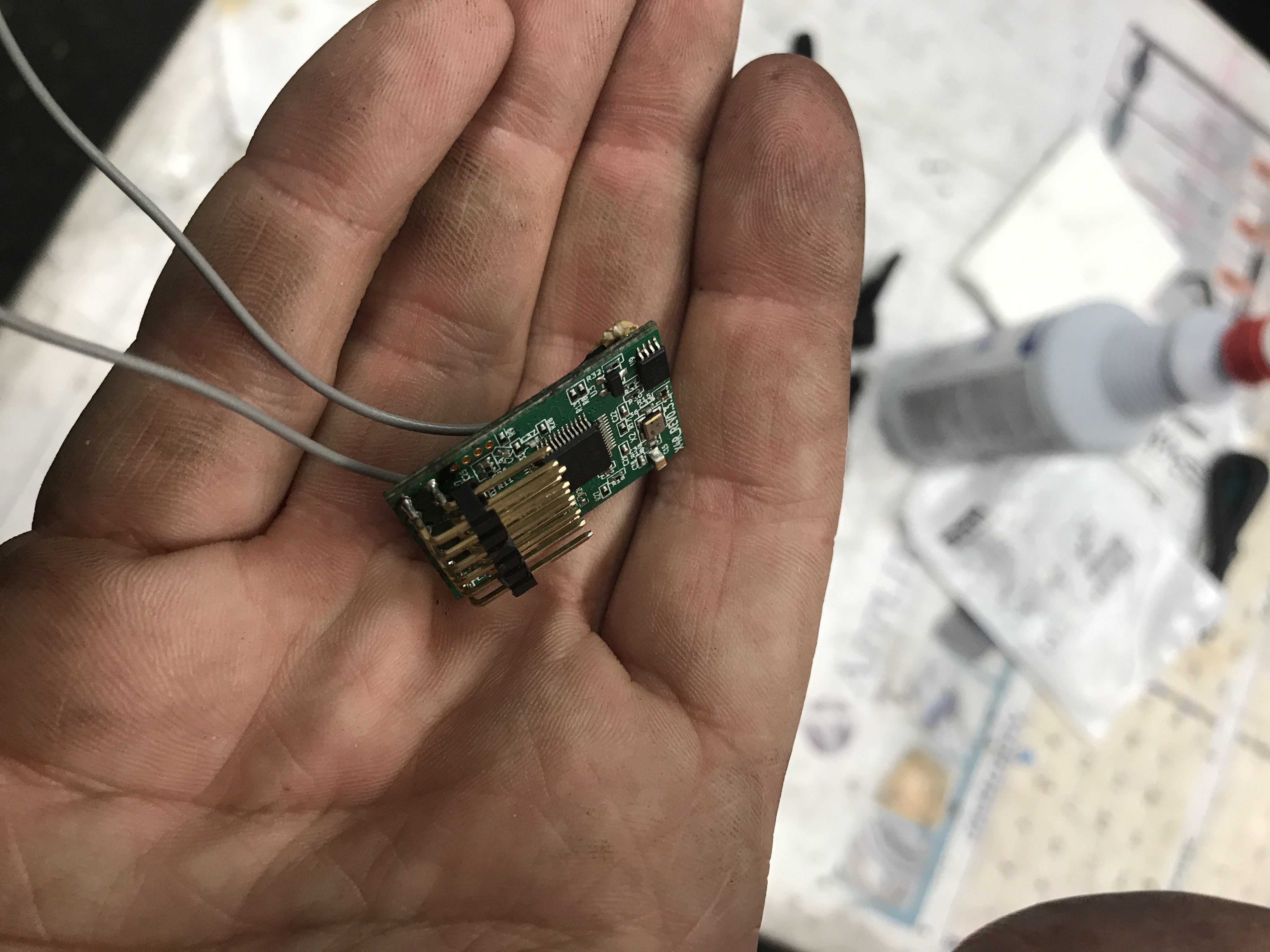

Couple things completed. First I reversed the pins on my receiver as it just didn’t quite fit in the pod of my dlg with the servos plugged up. Was kind of a pain but worth it.

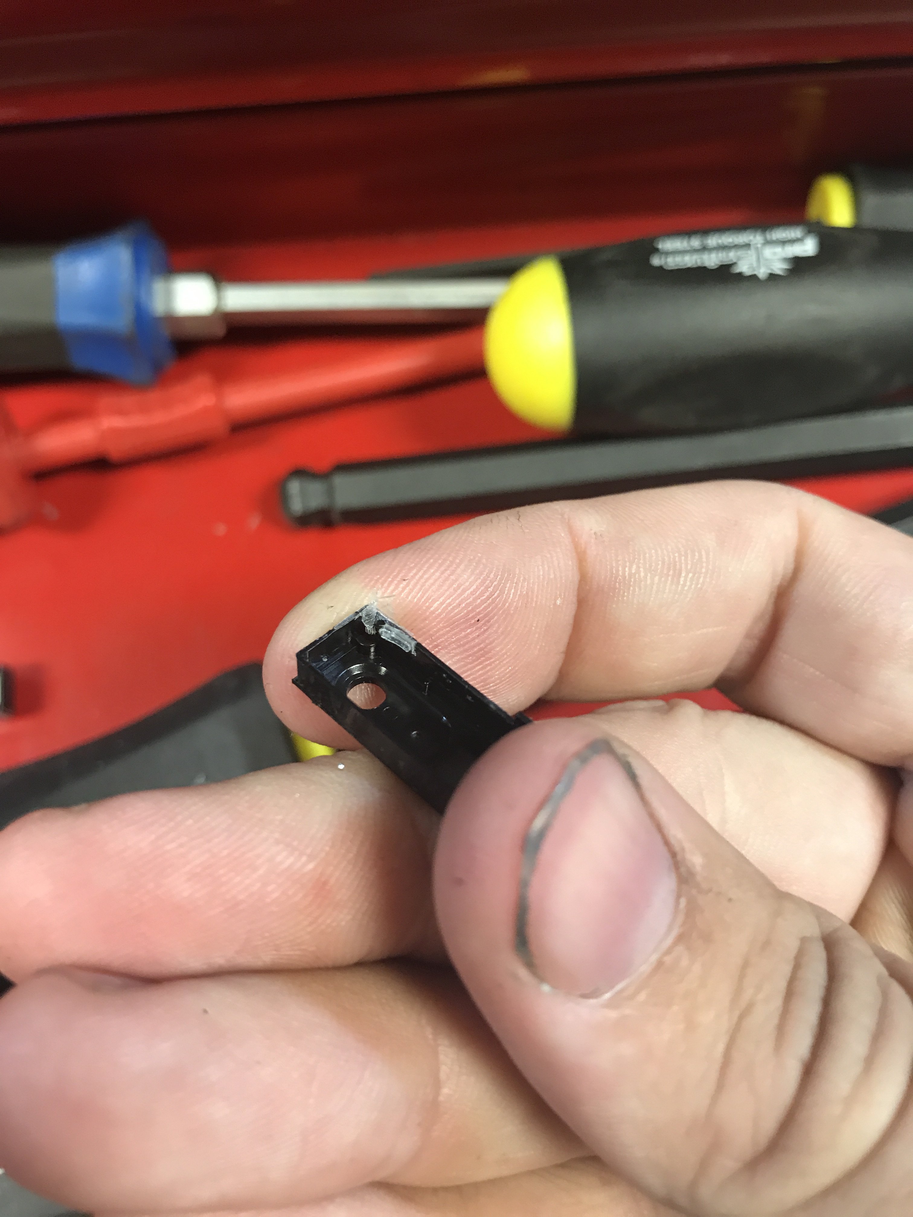

Then while making up linkages I noticed my elevator servo would only just barely move. Checked all my radio settings and it was good. Pulled the servo out and couldn’t move it by hand. Opened it up and found where I had epoxied the two servos together that a small amount made it into the servo and onto the main shaft. Got it all cleaned up and hopefully it will Work now. Will try it out when I get home.

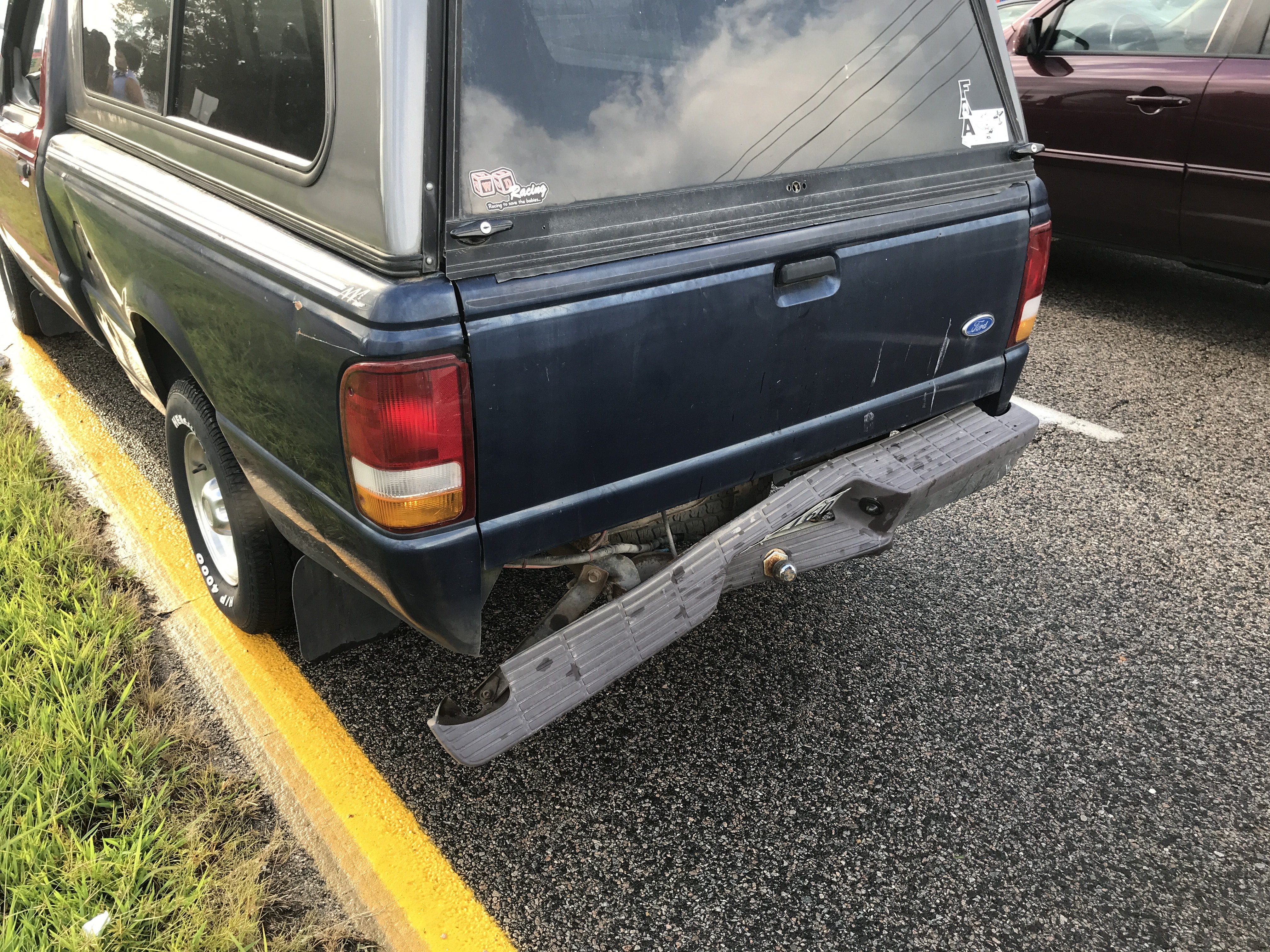

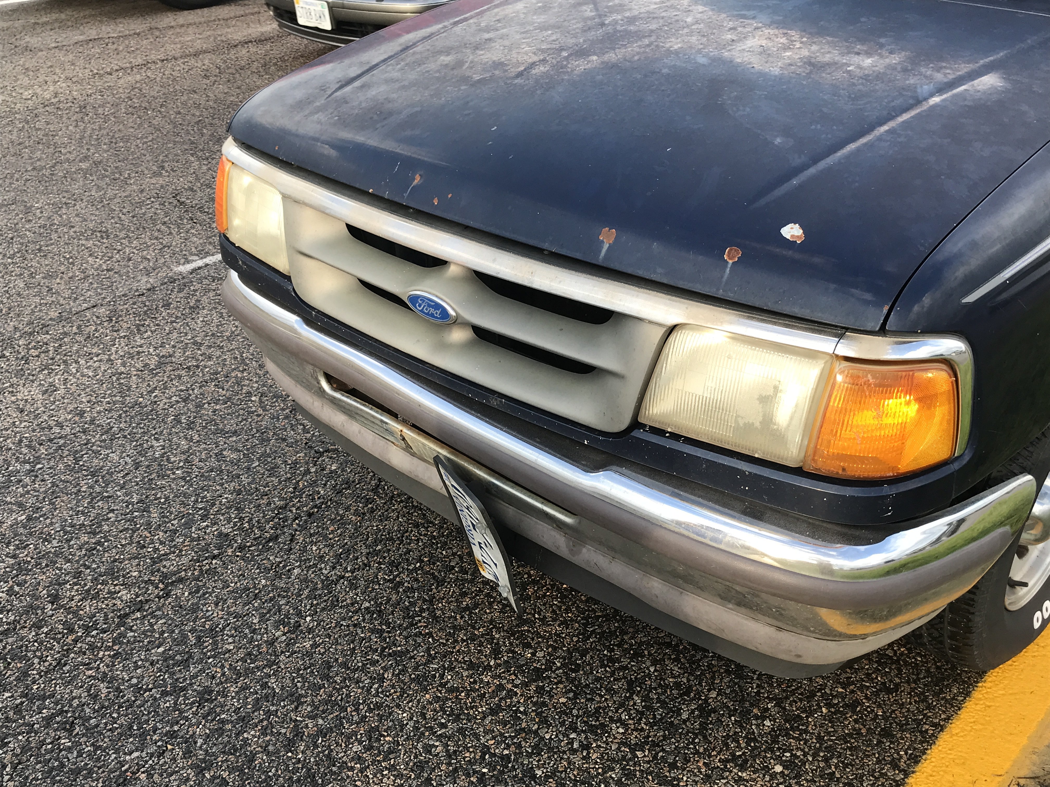

Hopefully insurance doesn’t total so I can pull it in the shop and fix it. Got hit from behind today and shoved into another vehicle that then got shoved into another one itself. Four vehicles total. Only needs a new front and rear bumper and their mounting brackets but between that and labor it would prolly be what insurance says the truck is worth which isn’t much.
