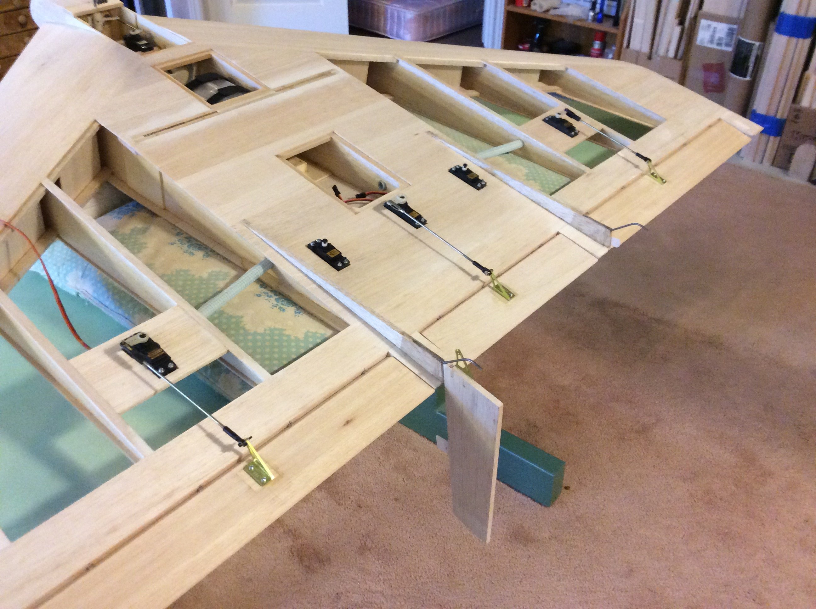

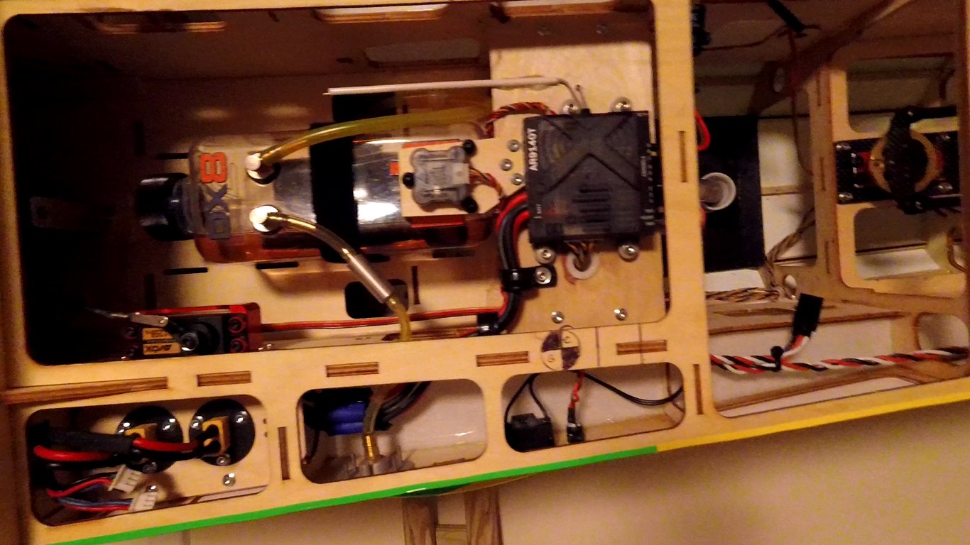

All the servos are in and setup. So the only one that is left is the throttle servo, which is always the tough one and difficult. Need to go up and down equally across centre.
You can also just see the tank just a head the landing gear blocks.

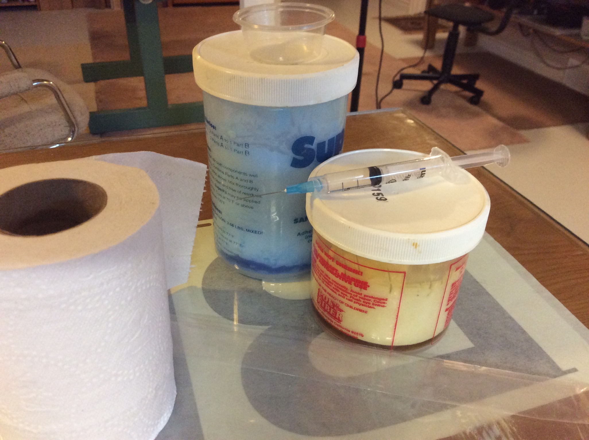

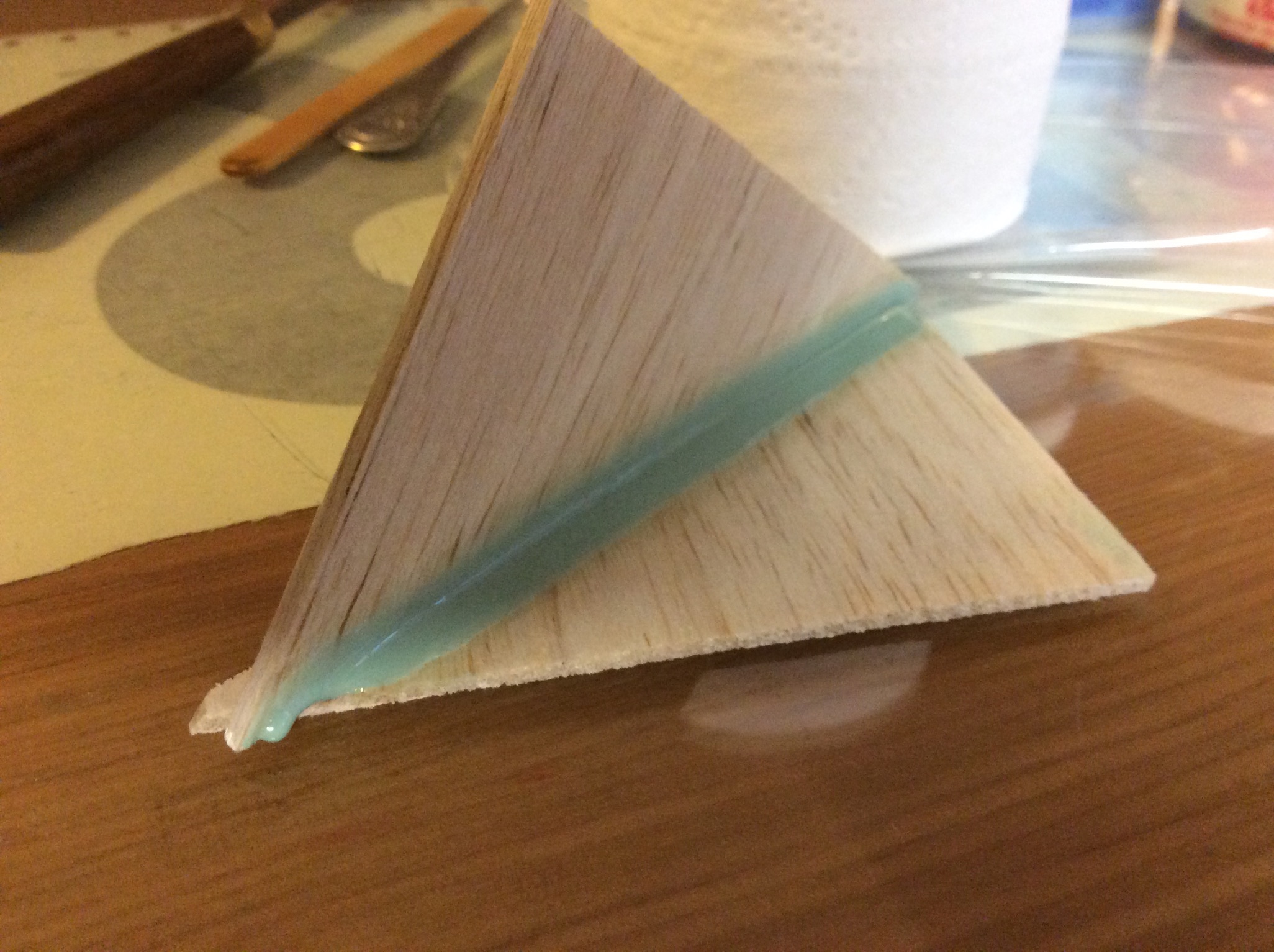

I have some Blue Stuff that I bought a while back and did not know if it is still good so I made up a test piece and mixed some up and tried it, time will tell. It did need some thinning and a lot of mixing but after that it looked good so made a small test piece to see how it still works. This stuff is epoxy based and no idea what the stuff is that is mixed into it but it is as strong as hell and sands easy great for making fillets.
