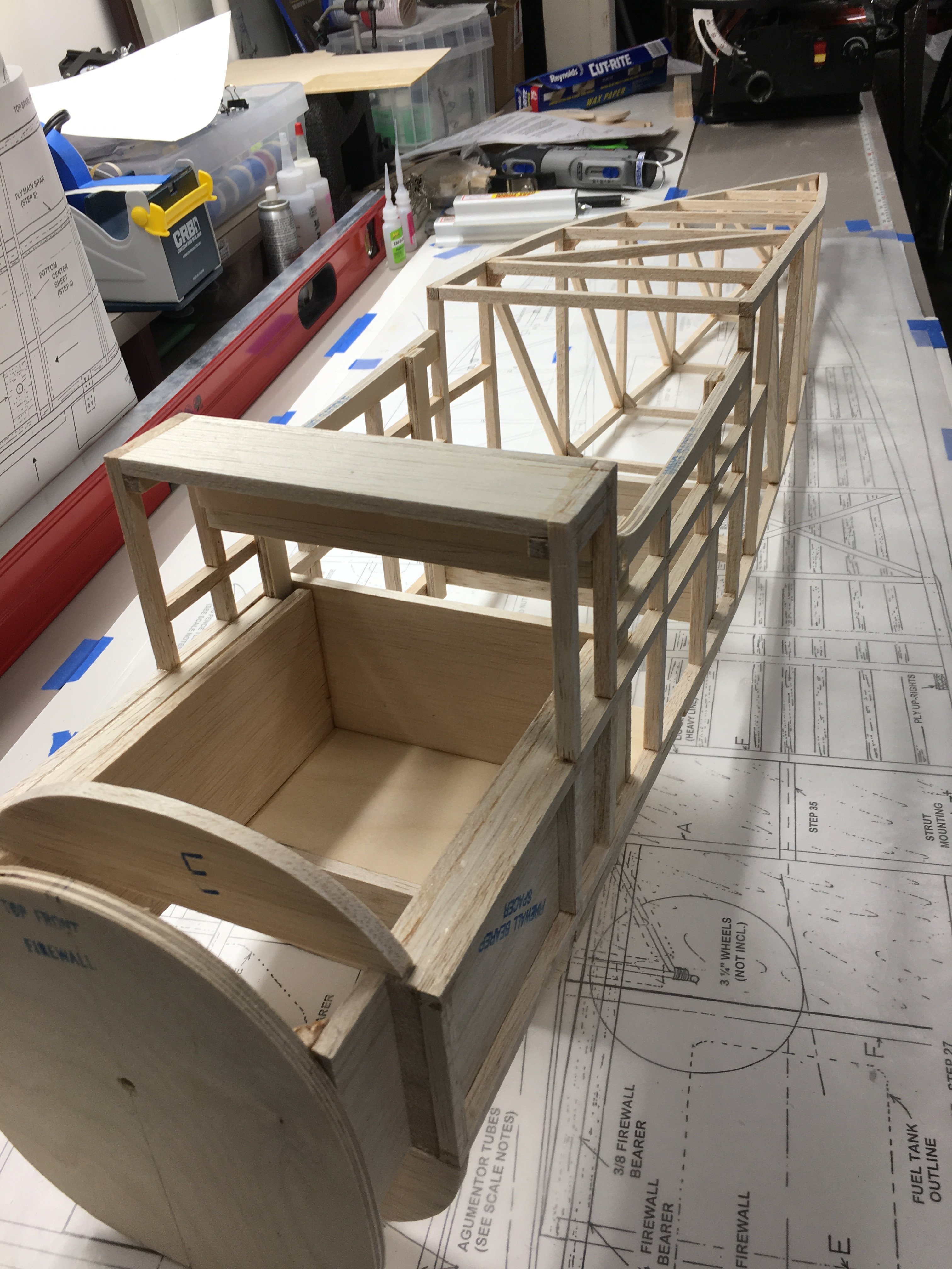

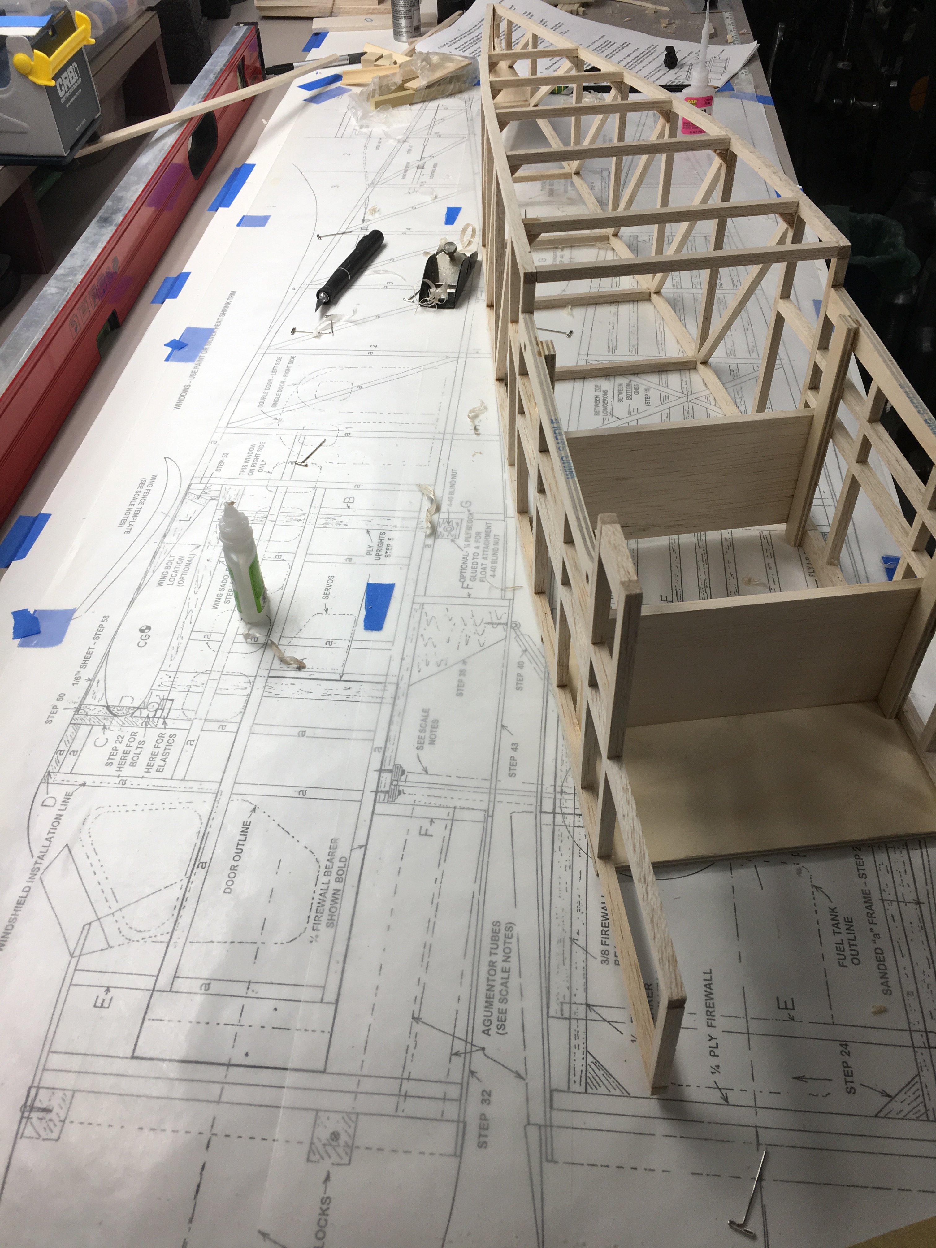

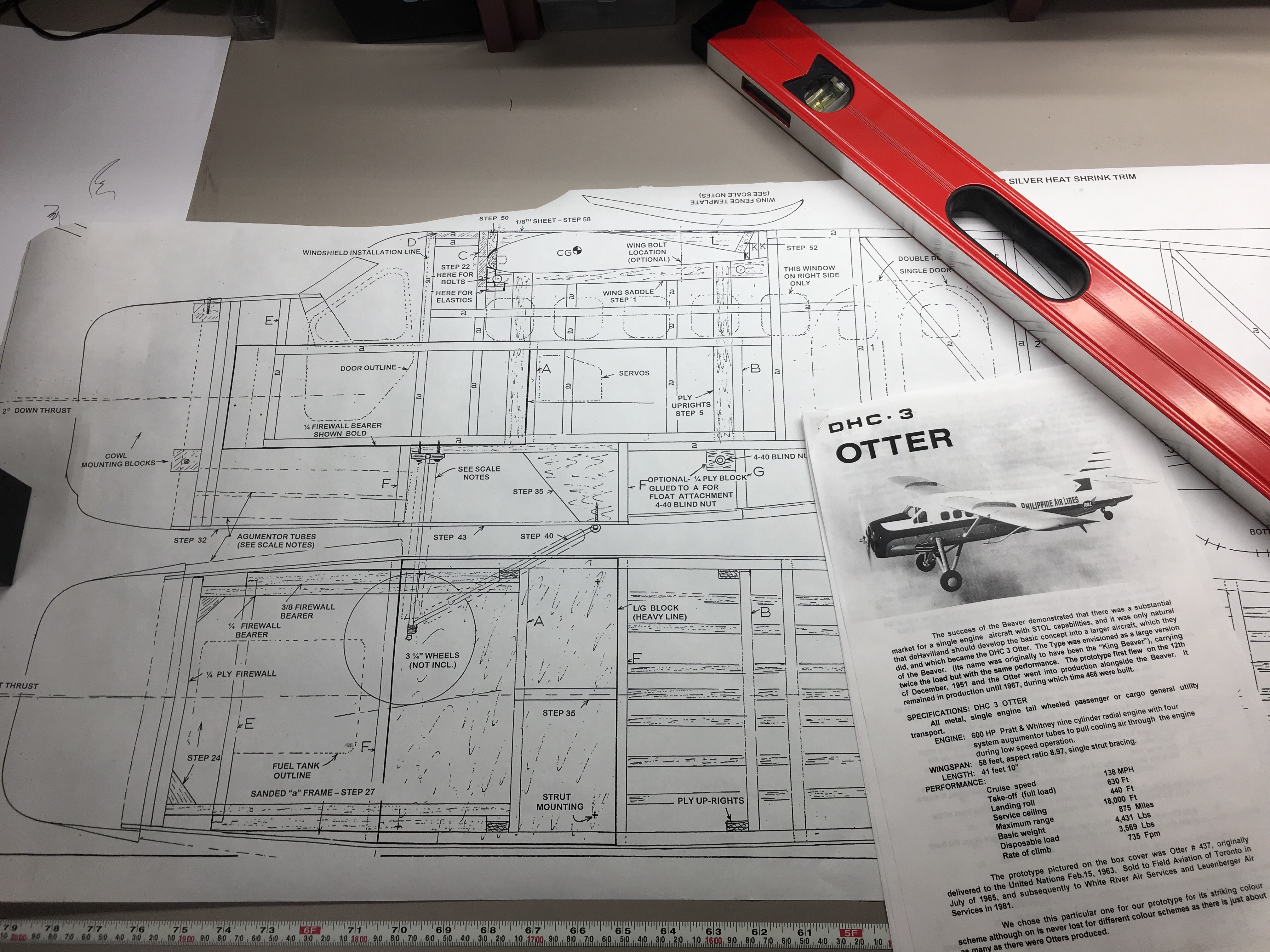

The beaver kit you recommend how did you order or pay for it. Or how does it work.Well started a new build. Unionville Otter 6ft wing. Two nights into it and it’s coming together thanks to the quick work of the scroll saw.

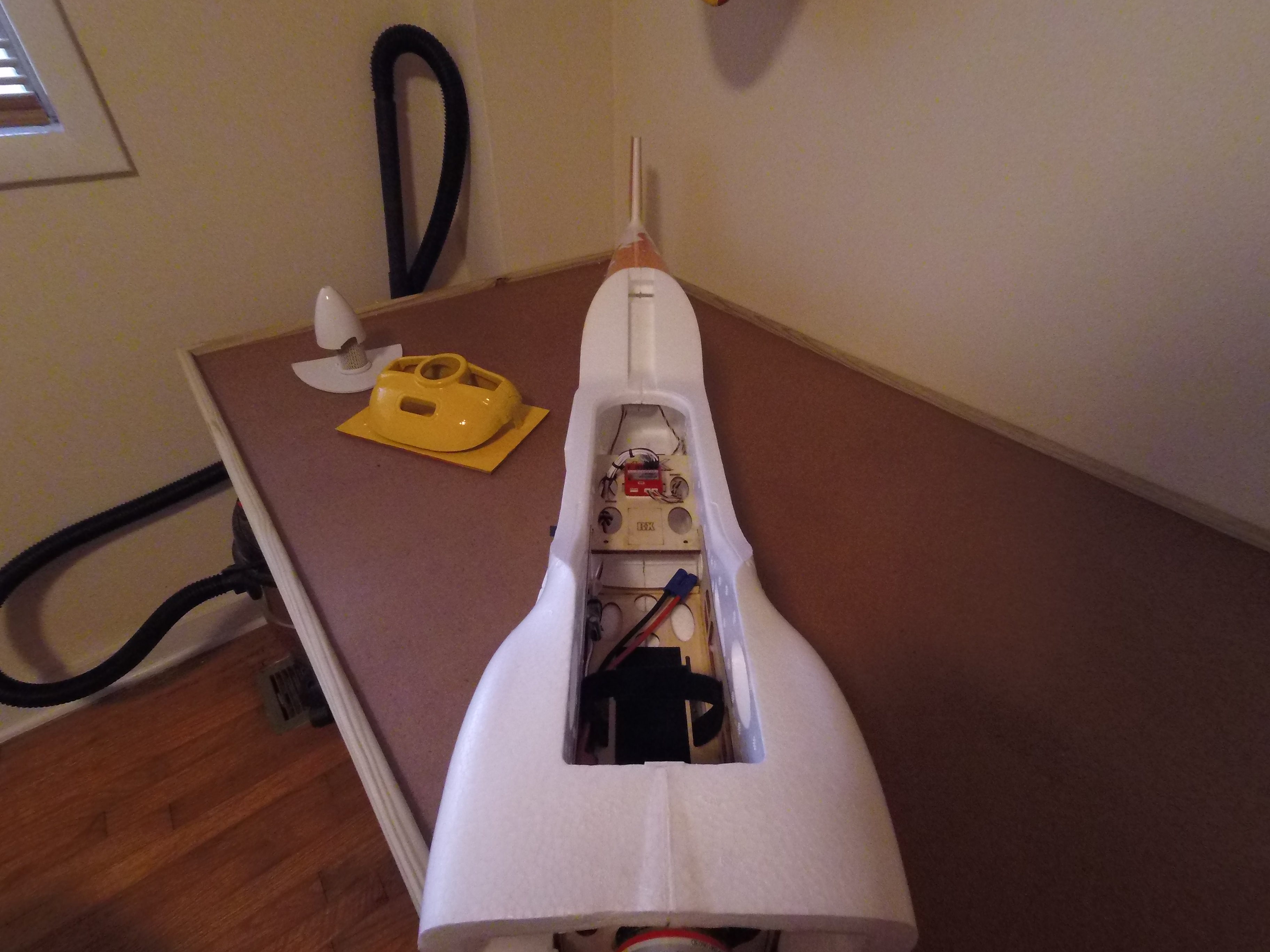

Phillips head screws painstakingly removed, holes saturated with thin CA to make the wood swell, grommets/eyelets installed onto servo rails, and finally screwed the servo in place with some nice black hex head screws from TDRC. Everything is nice and sturdy now, and some minor adjustments to the hole positions on the servo horns had the rudder and elevators driving to their limits with most of the servo resolution being used.
