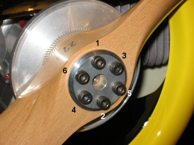

Hi Bunky,
what are your thoughts or experience of using (when using the bolts on the prop hub washer)
1. the 6 bolts with no washer between bolt and the hub washer
2. a washer between the bolt and hub washer
3. bolt, lock washer, flat washer, the the hub washer
which is best
which should be avoided?
