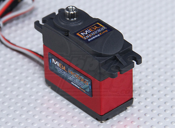

Don't beat me up! MiBl 70960 HK. Has been on my 30% and 35% going on 4 years. No issues. Throttle response, resolution and feel is exceptional. Not cheap for a China servo...About $90.00
