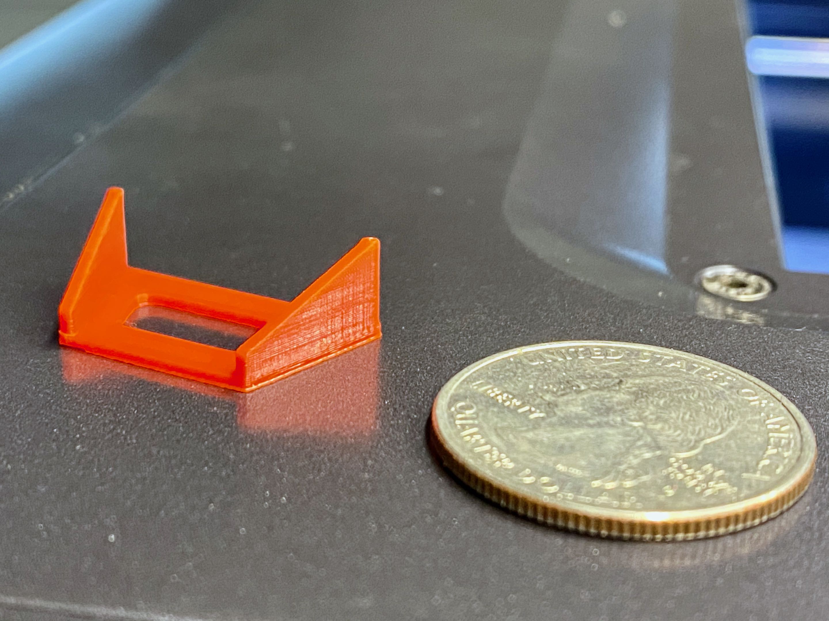

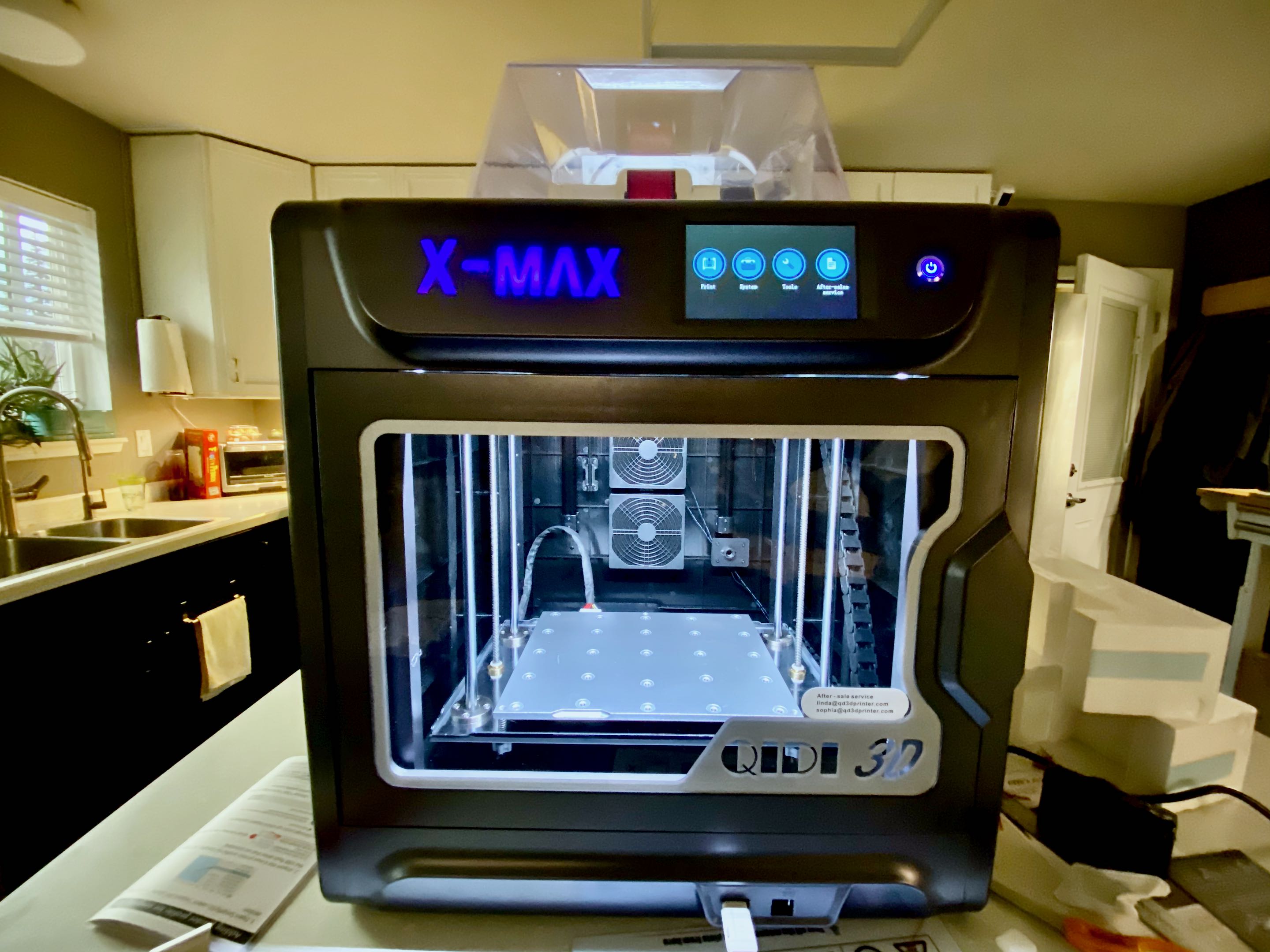

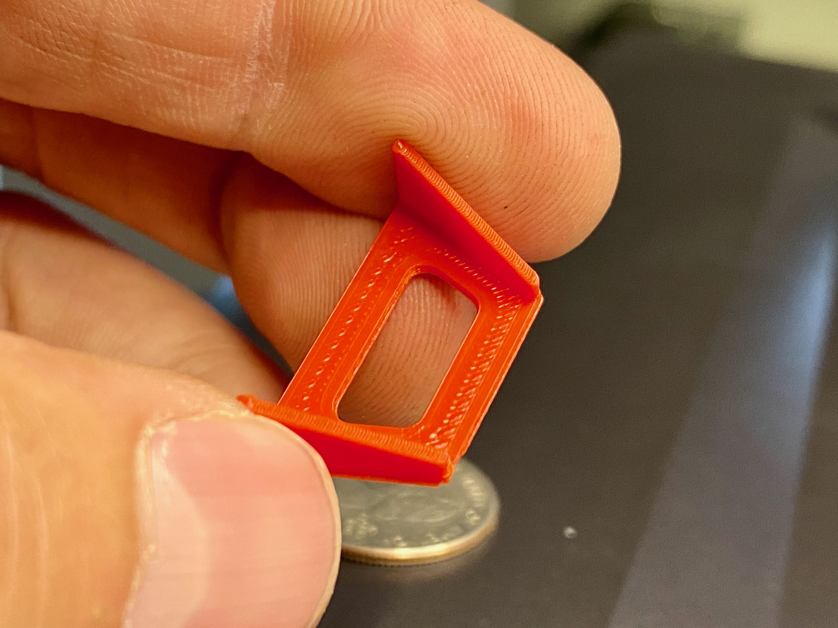

    OOOO! Looks fancy! You're going to love playing with it! Takes some fine tuning to get your first layer just right then just watch the magic. Lots to learn and explore!

    That looks awesome keep us informed, very interesting machine. I keep looking at them but I need a 12 inch drum sander first.

    What this guy said. That part looks great other than needing a little adjustment on the first layer settings but still freaking awesome for the first part off of it.

    The build plate has a a significant crown in it. With the bed level and the nozzle set the proper vertical distance at the adjustment points it touches in the center. The VG was printed in the bed center and it was blowing out the first layer due to the lack of clearance. I'm in contact with the manufacture now to get a replacement bed.
