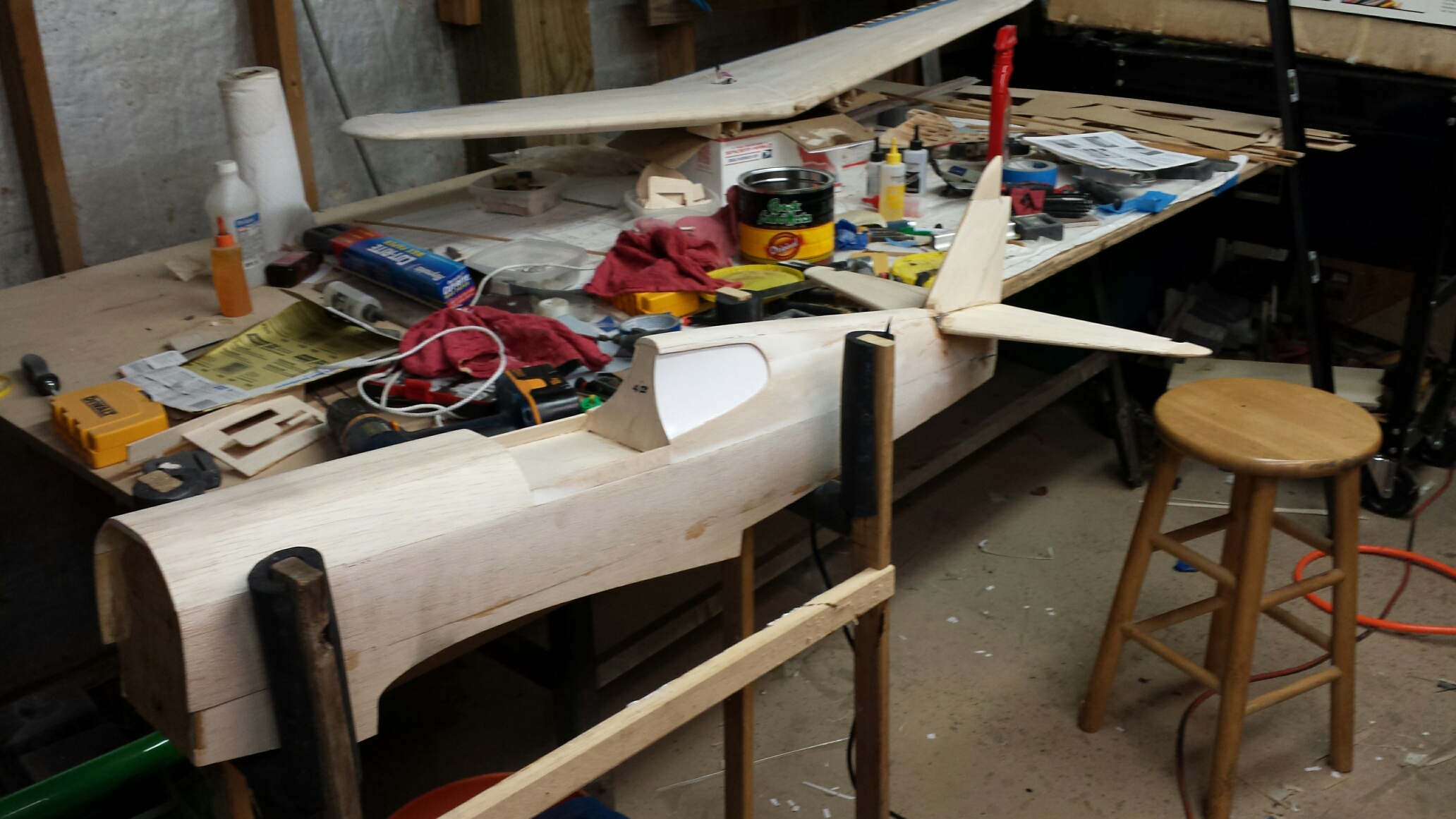

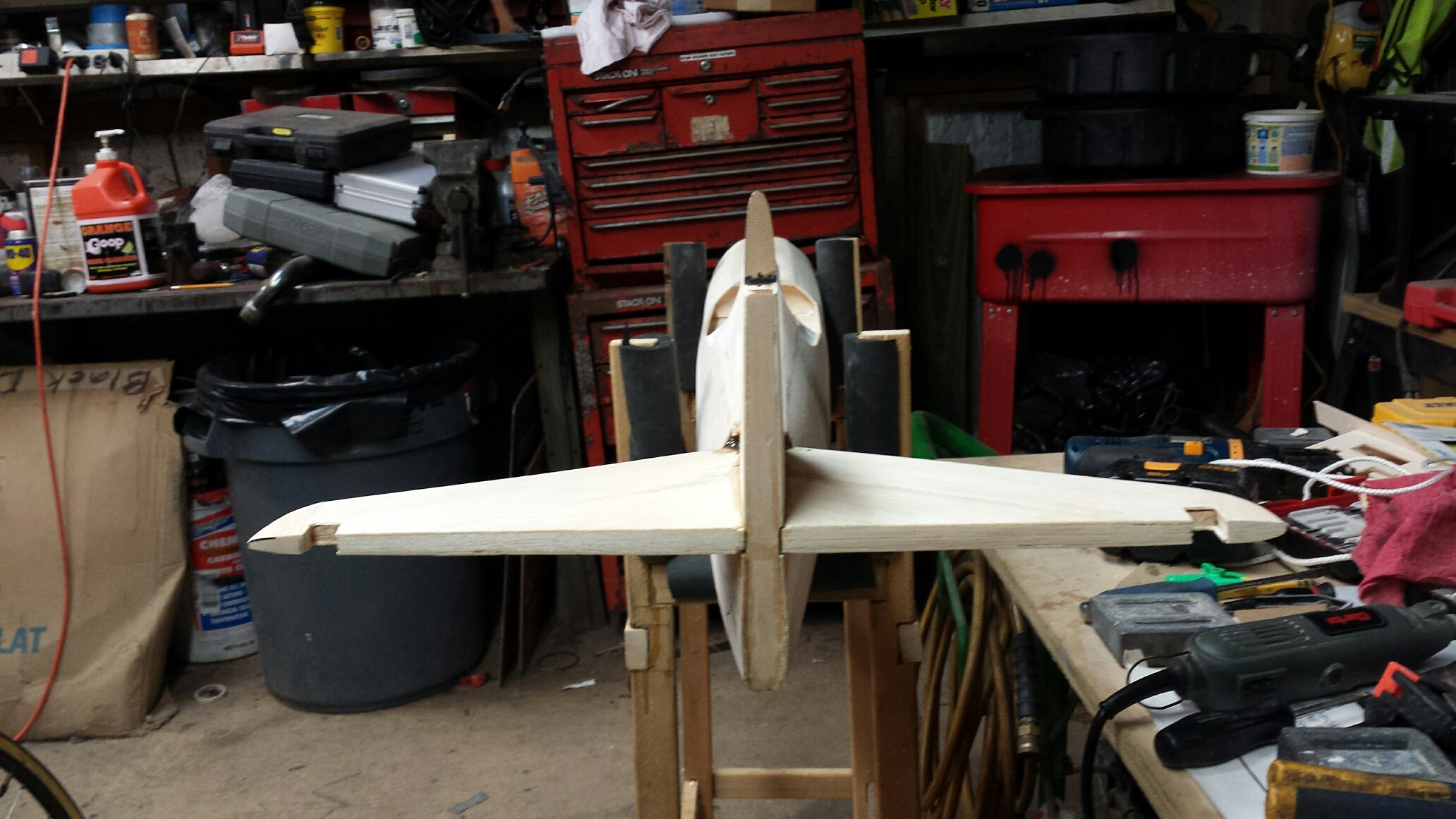

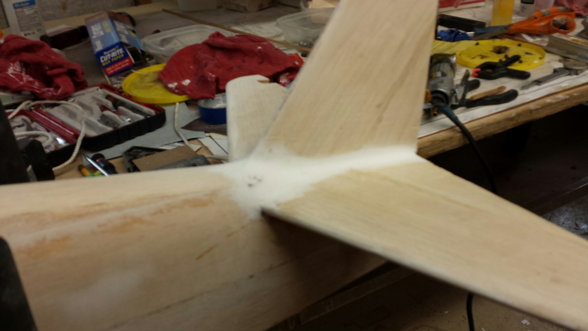

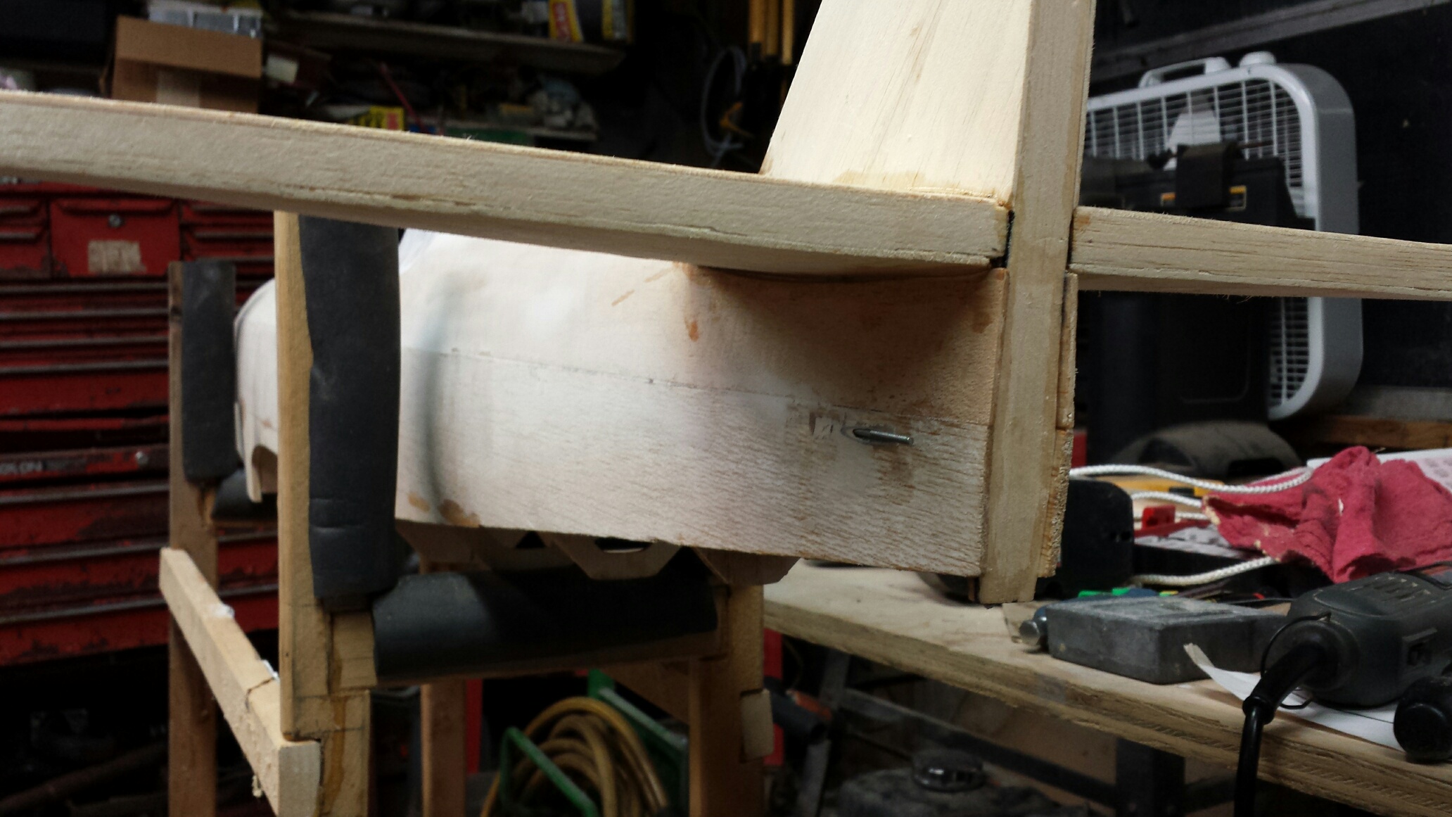

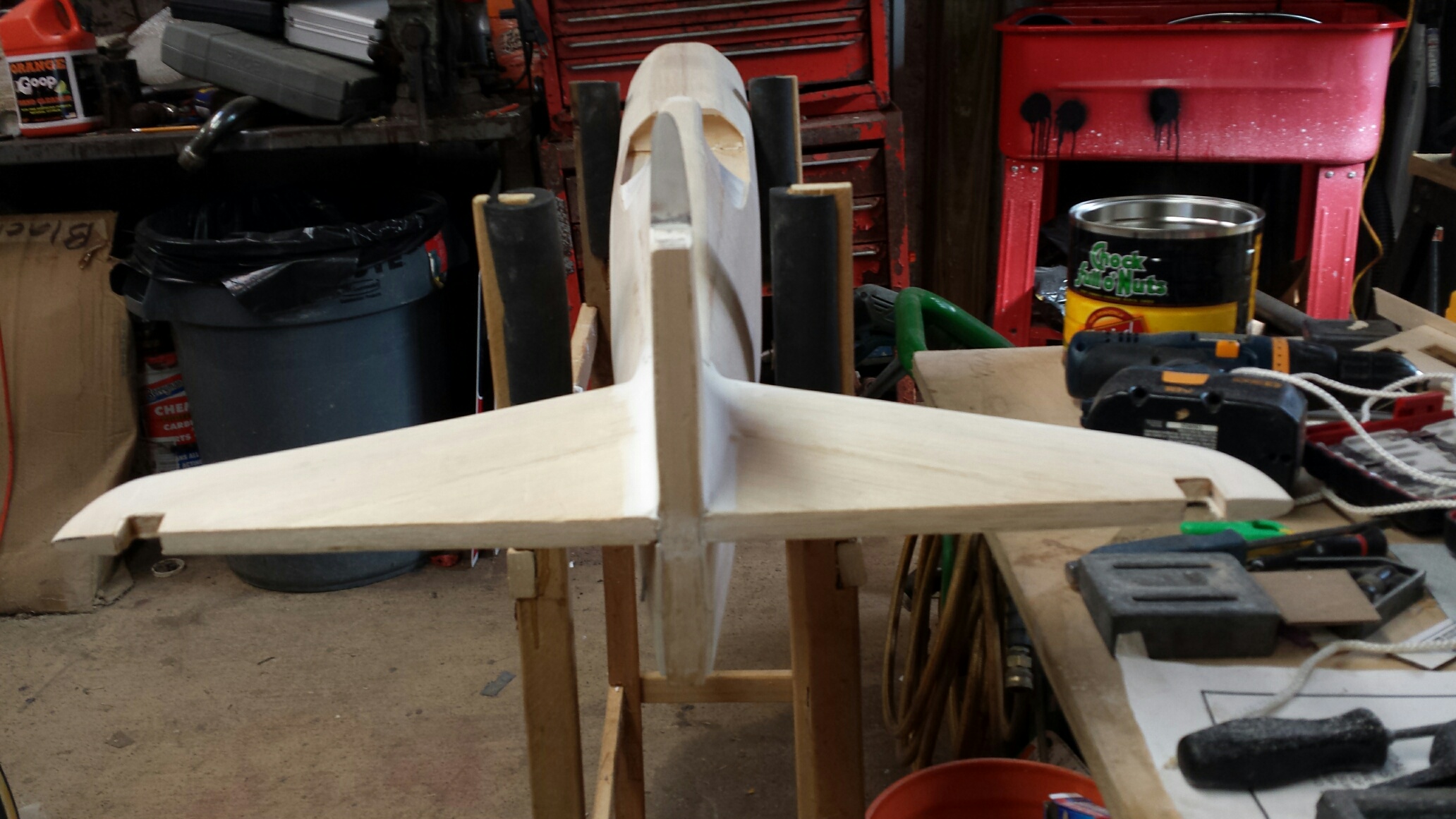

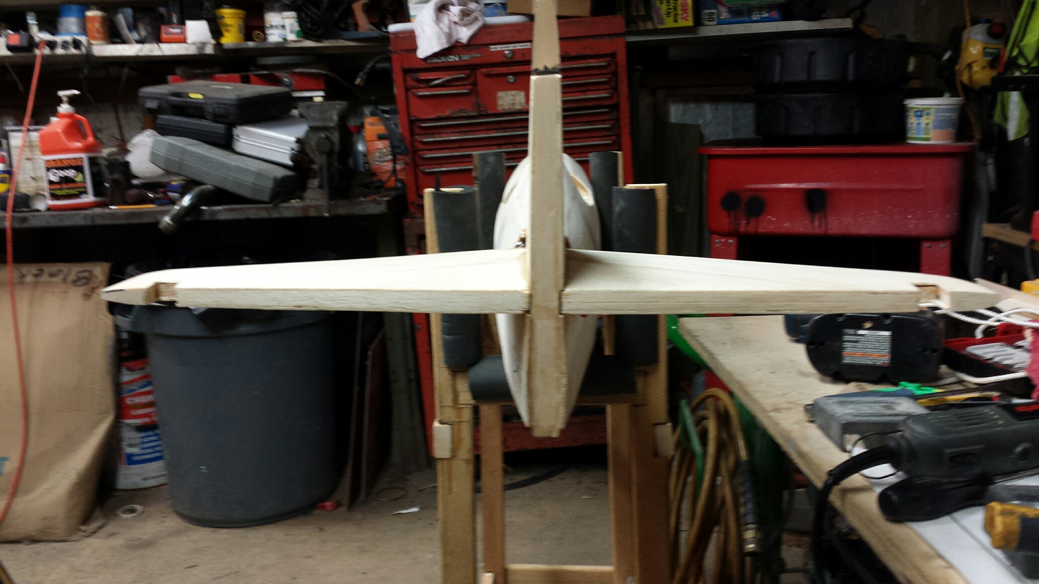

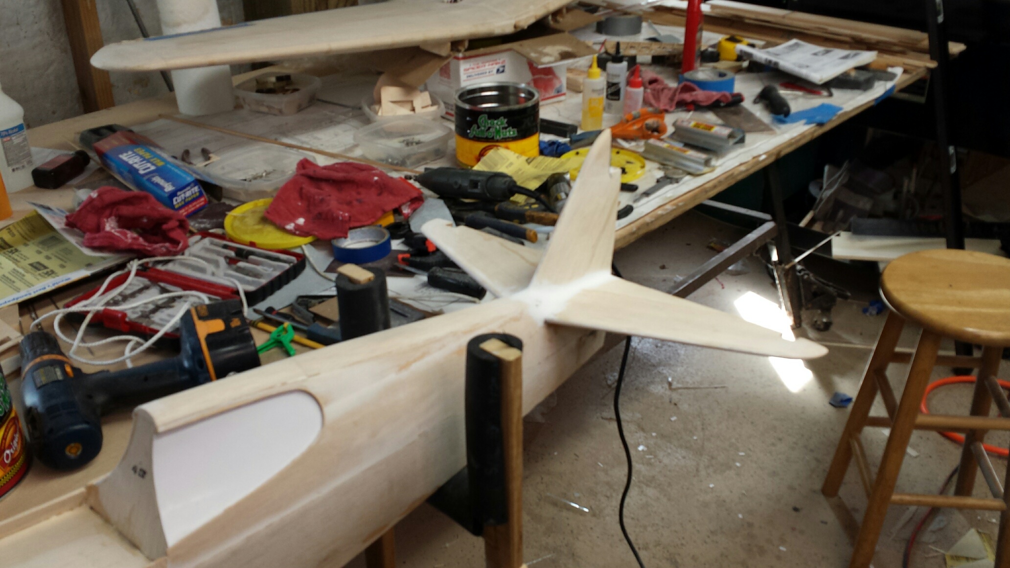

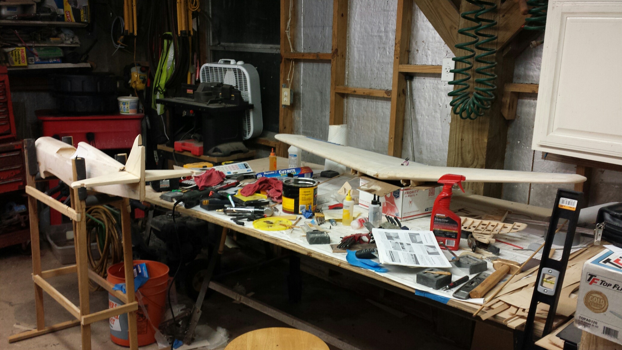

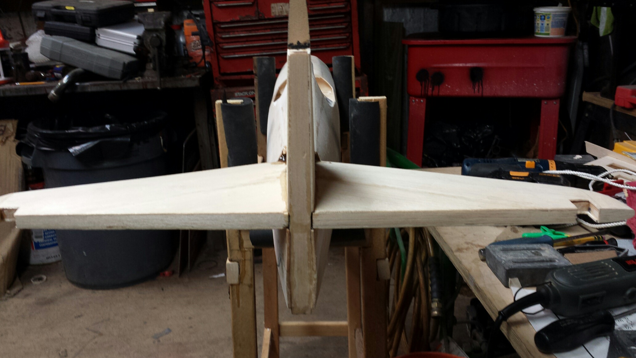

Attached the vertical stabalizer to the horozintal stabalixer last night and epoxyed the tail to the fuselage tonight used an epoxy sawdust mix to fill the gap where the vertical stabilizer meets the body and will use Hobby lite filler to finish fairing the body into the tail.
Im now at the point that I am going to have the install the tailwheel retract before i can put in the belly sheeting. Have decided to go ahead and use a Robart #121 Tailwheel retract and use a Robart 161 air cylinder to actuate it that is coupled to the main retract air system.
