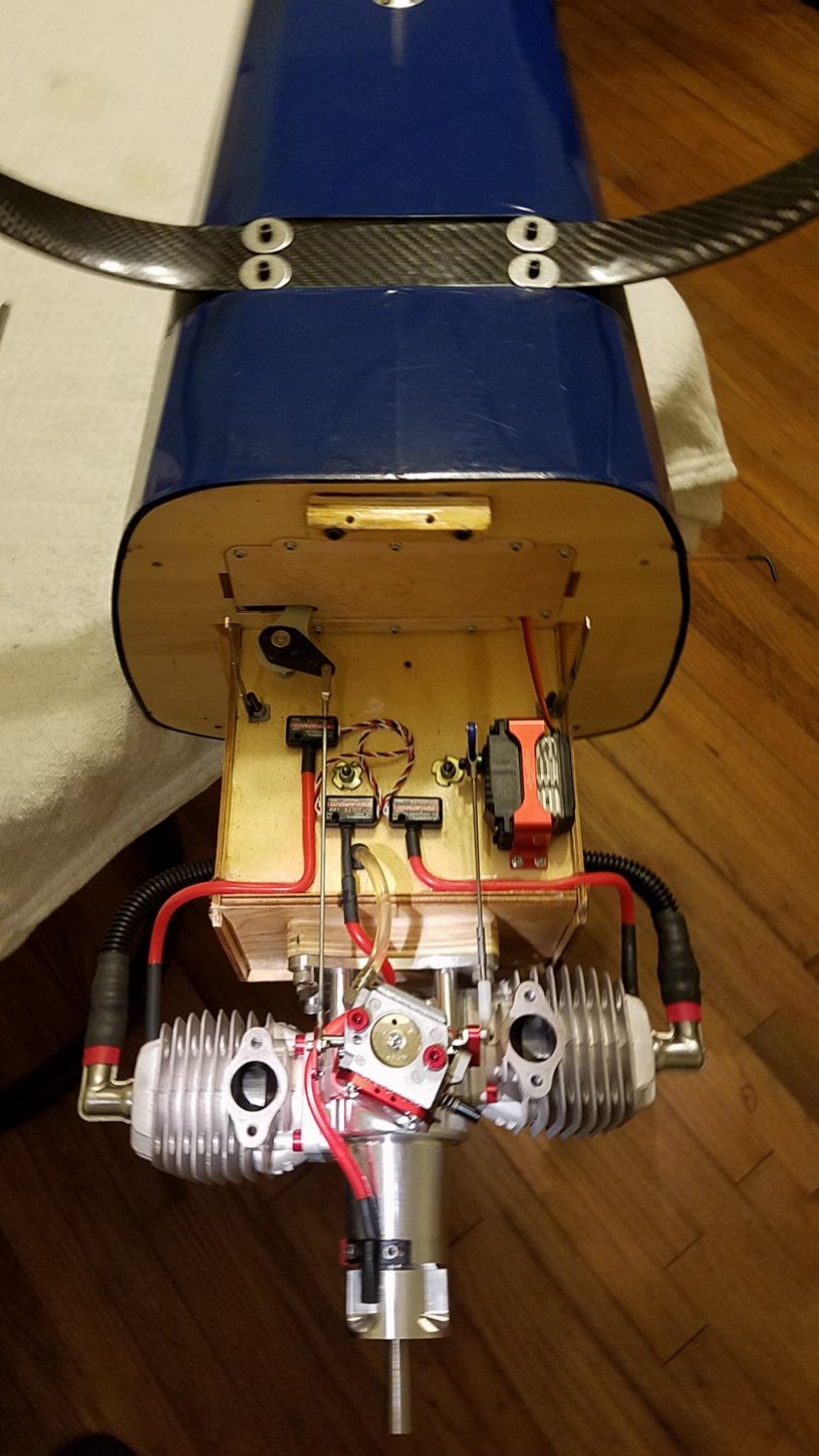

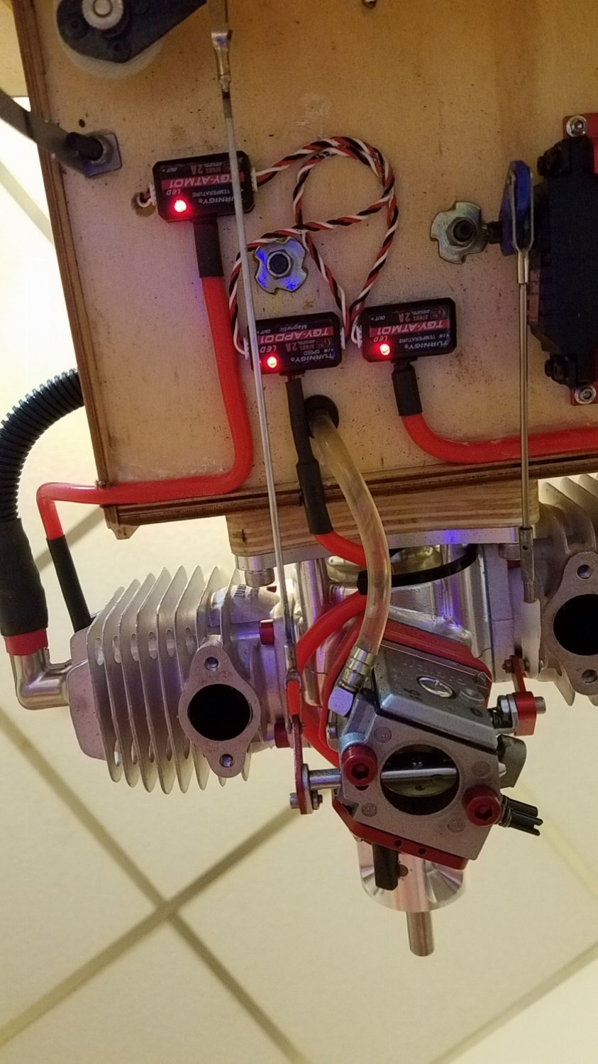

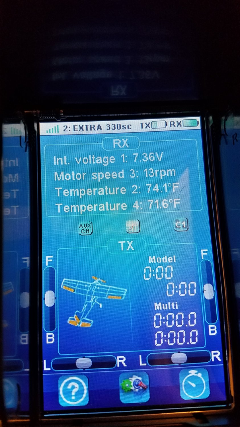

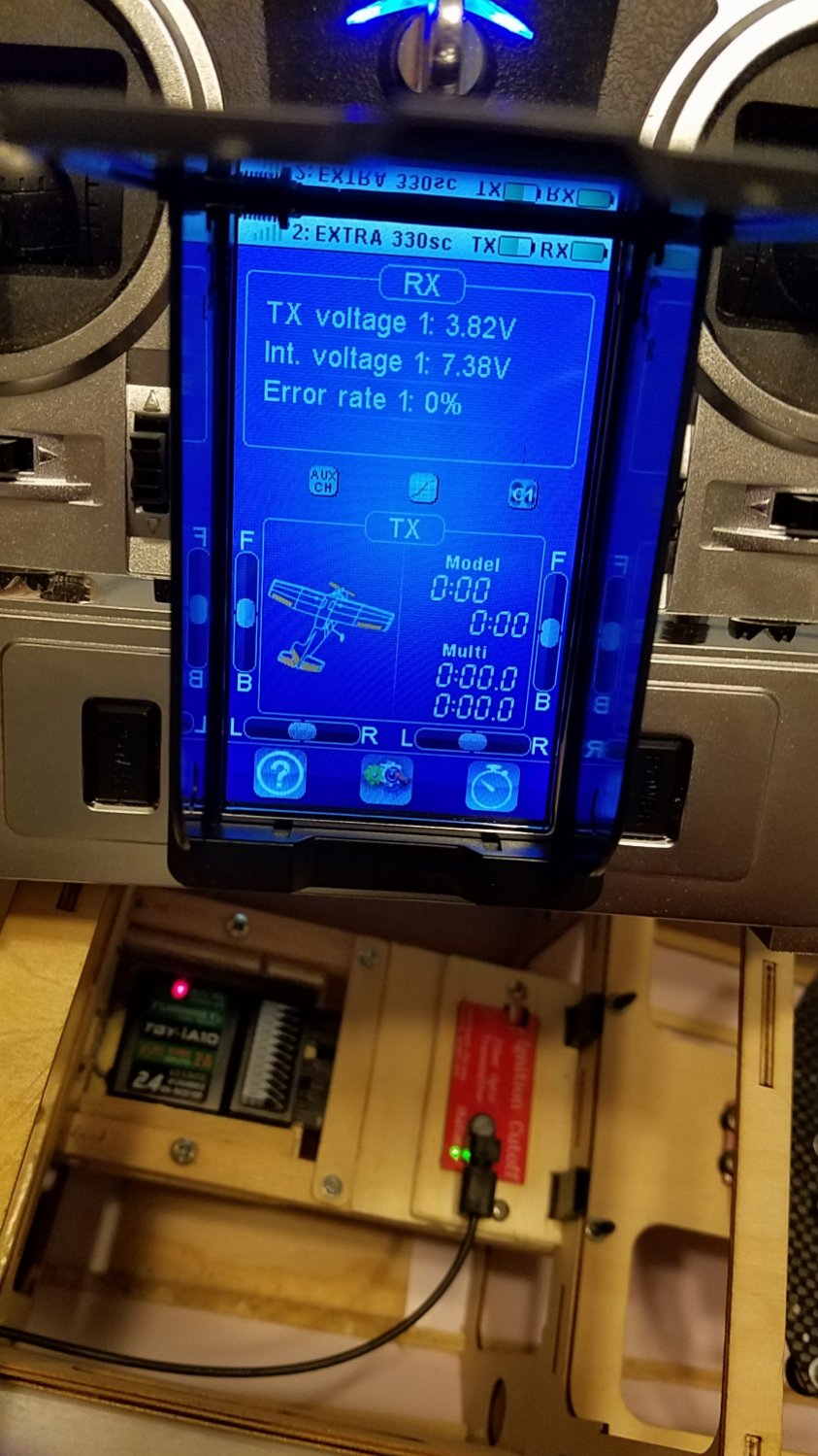

I have installed this radio in to my 32% Extra 330sc with engine CHT and RPM sensors. Onboard voltage monitoring is done by the receiver alone since this bird fly's with one 4400ma 2s lipo. Hope to get it out Sunday afternoon and "see" the difference:).
View attachment 83419 View attachment 83420 View attachment 83421 View attachment 83422
Looking good keep us informed about the good and the bad of the radio. The price and the ability of the radio seem to be at odds. But very interested to see how you like it and how it performs in the long run thanks.

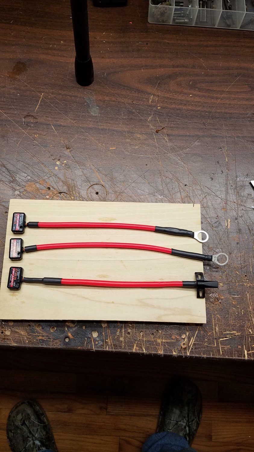

How are the thermal sensors connected to the cylinder heads. (Picture).
I used 12-10awg ring terminal connector. The portion of the thermal head is inserted inside the ring connector and filled with thick ca then shrink wrap. The wires themselves are inside some red silicone fuel tubing. Spark plug holds em in place.
Thanks now it all makes sense. Under the spark plug does that not give much higher temperatures than the head actually is.
With it connected under spark plugs what is your upper operating temperature limit on the DA
