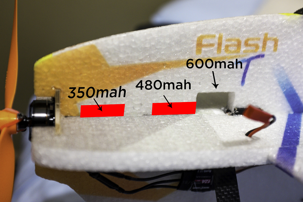

Here's a pic of what another guy did for his flash ng. It's pretty common to put the battery up in the nose.

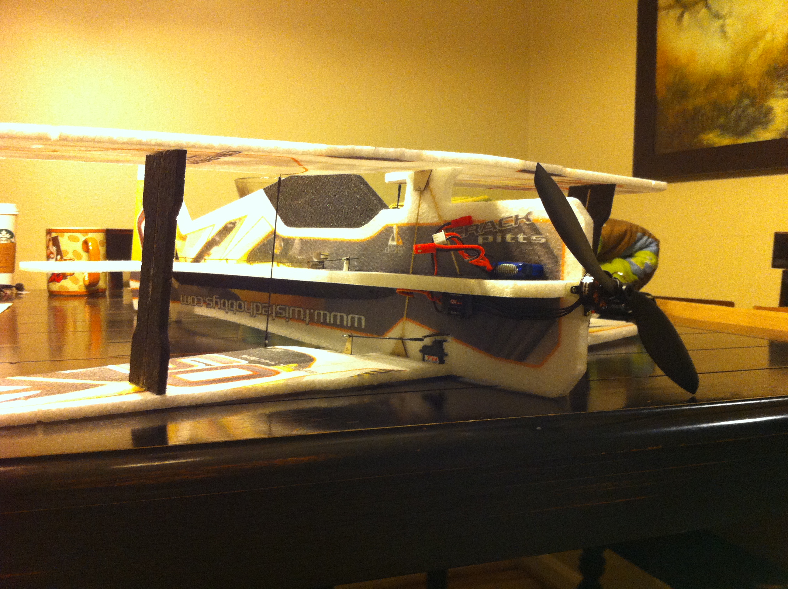

Here's another example of with my crack pitts...

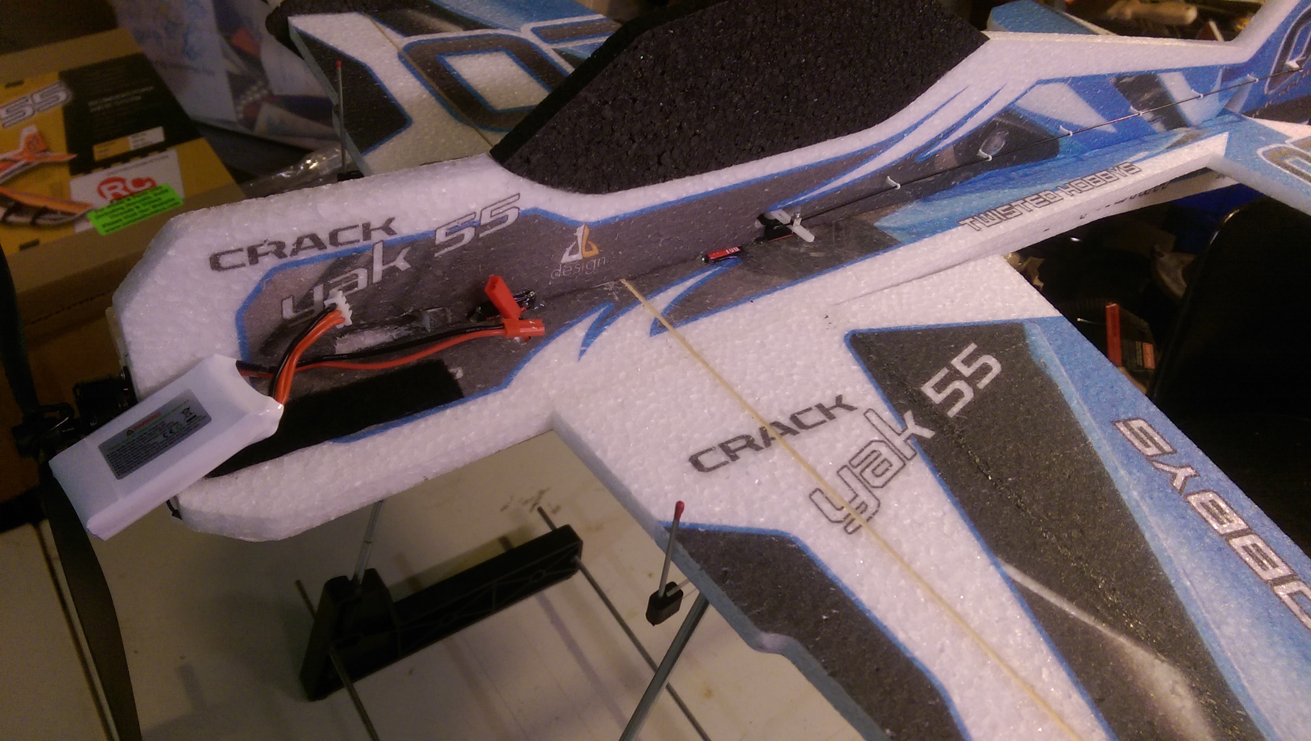

I did cut a slot for the battery based on the position in the first photo.

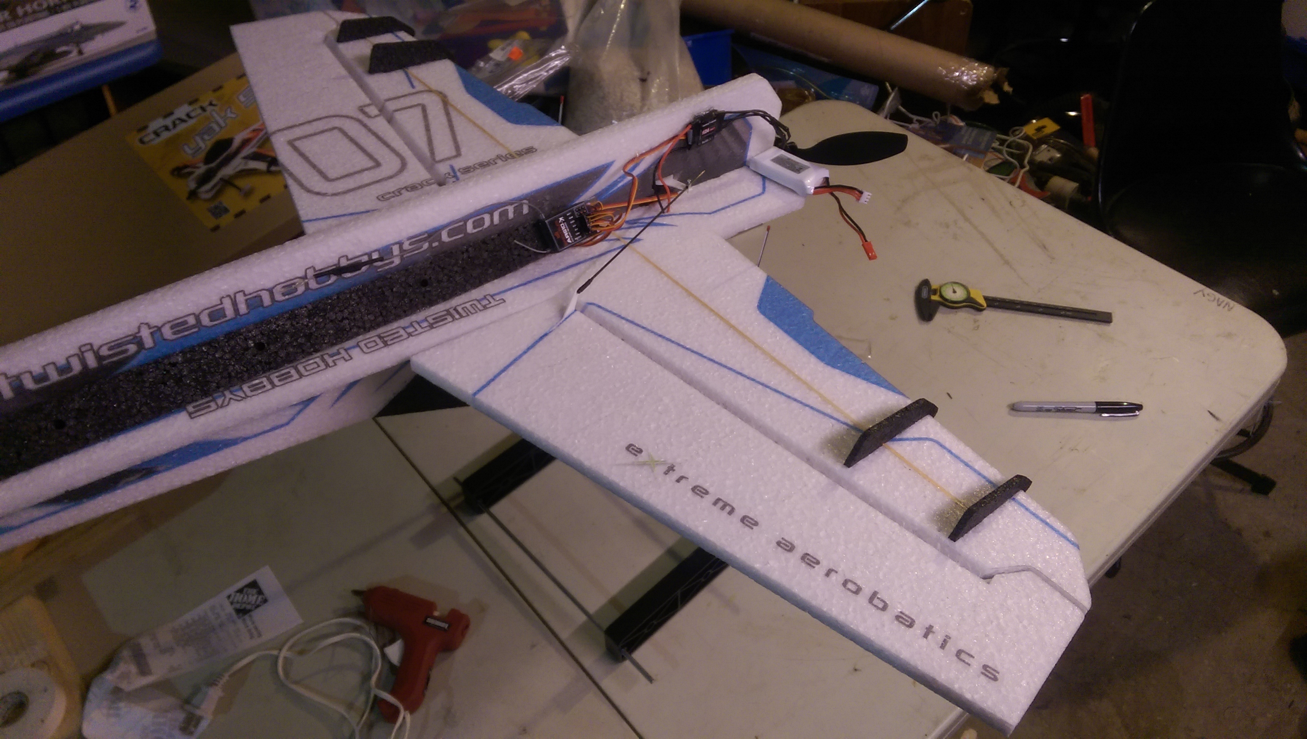

I've attached two more photos to show the component positioning and balance points. I am using the th power combo.
I must be overlooking something. I'm starting to wonder if the cg in the manual assumes the landing gear is attached.
Tbos
30cc
Thanks Mike.
It appears to have been an issue with the elevator servo setup and sub trim.
I noticed that after a flight the elevator didn't go back to neutral at center stick.
Weird, but after setting it up again it works perfectly. Yay.
