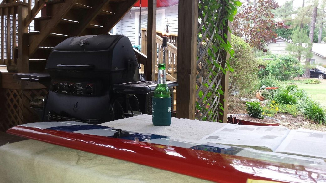

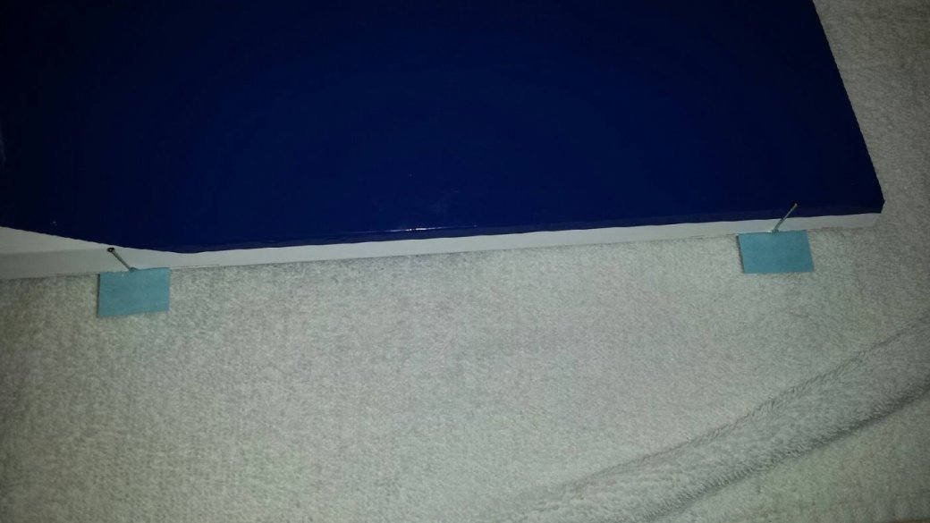

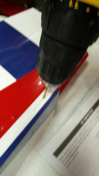

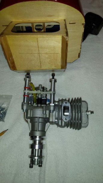

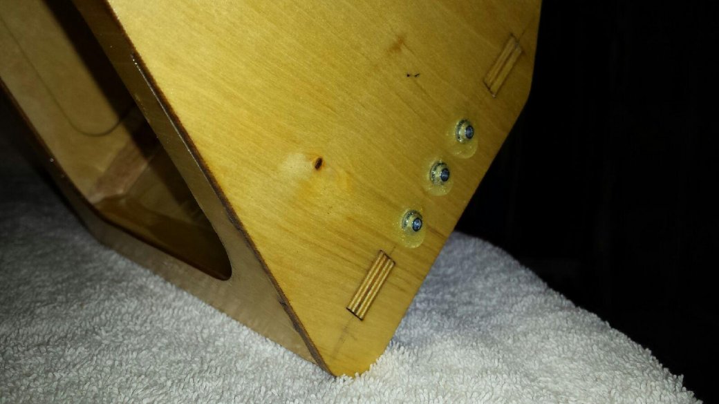

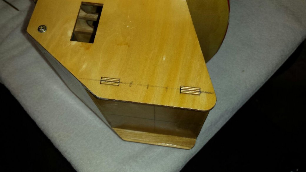

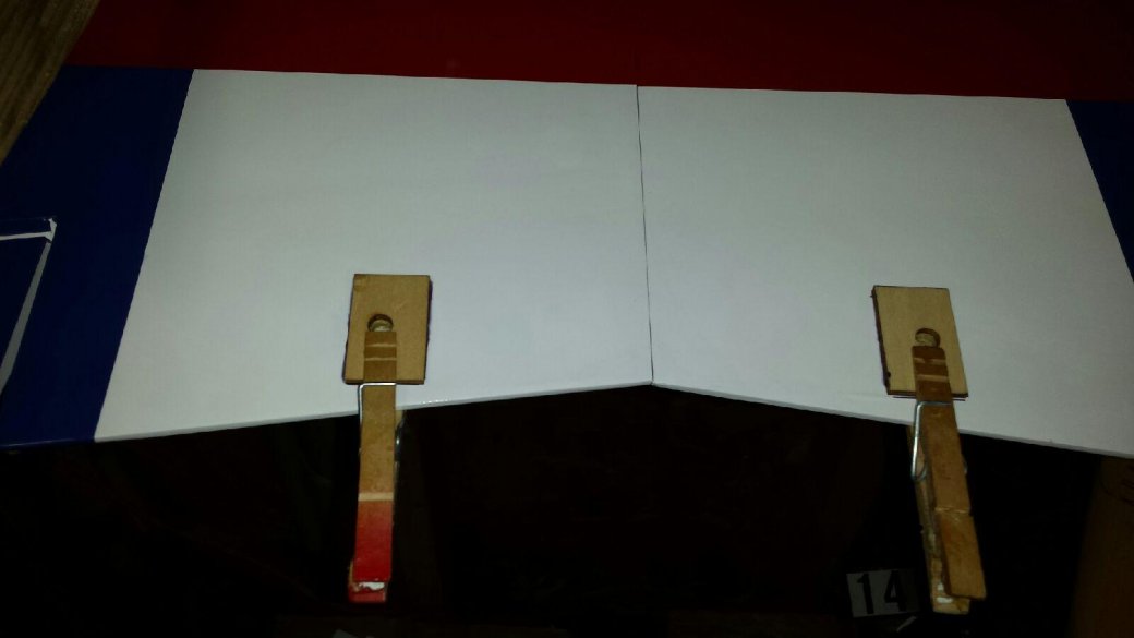

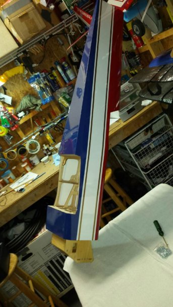

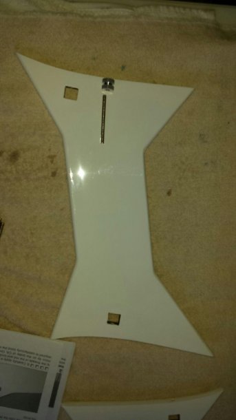

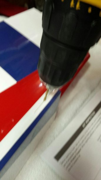

Well finally got a little time this weekend from home repair/maintenance to work on the Ultimate. Here are some pics:devil:Big Powerplant) 20150425_170657.jpg 20150425_170547.jpgmark firewall for pinning.20150425_172927.jpgUsed Servo screws and epoxy20150425_173607.jpgCure time20150425_180743_1.jpg3/32 holes for ca hinge20150425_181016.jpgone upgrade was the Radio South hinges.20150425_183914.jpgpin hinge placement.20150425_185206.jpg4 ailerons installed.

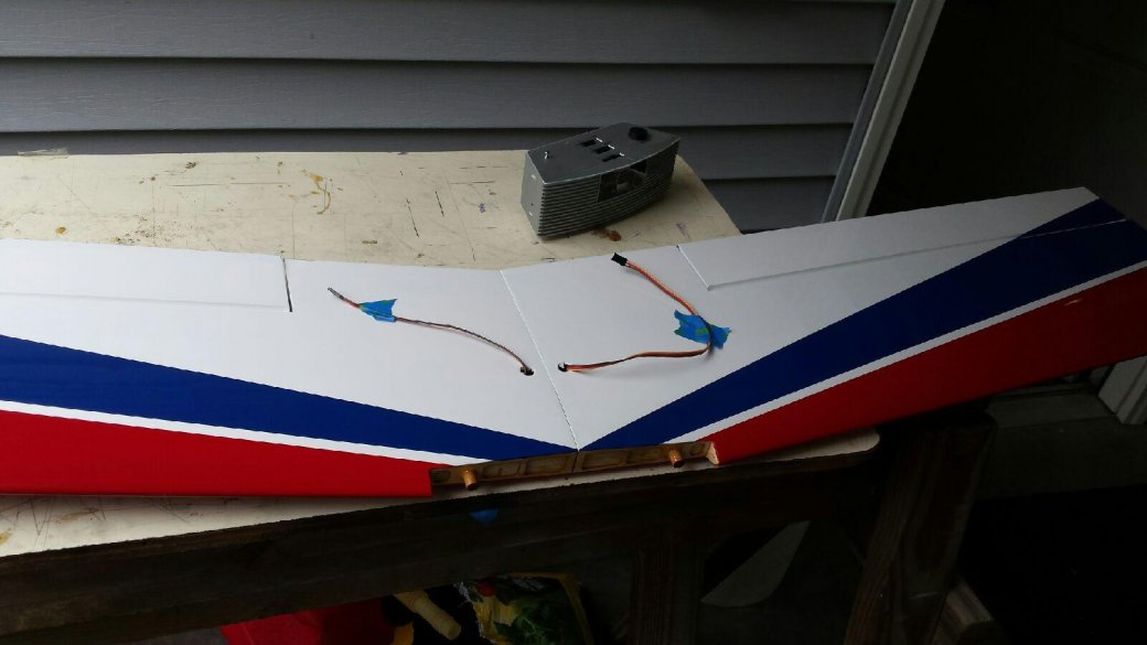

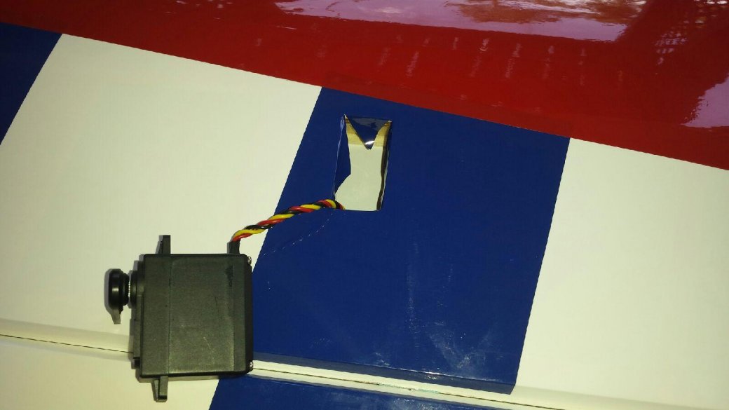

One more step accomplished in the build. Installed the 4 aileron servos. Here is a pic of one during the process.I like to x my cutouts for the servo bays and keep as much covering as possible to prevent it from lifting out.
