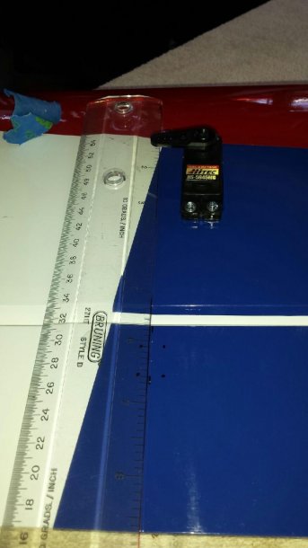

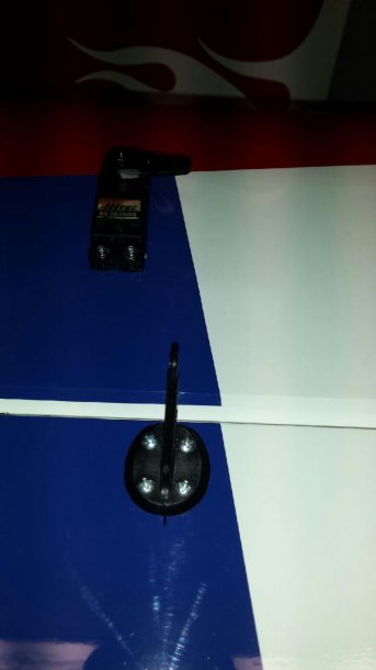

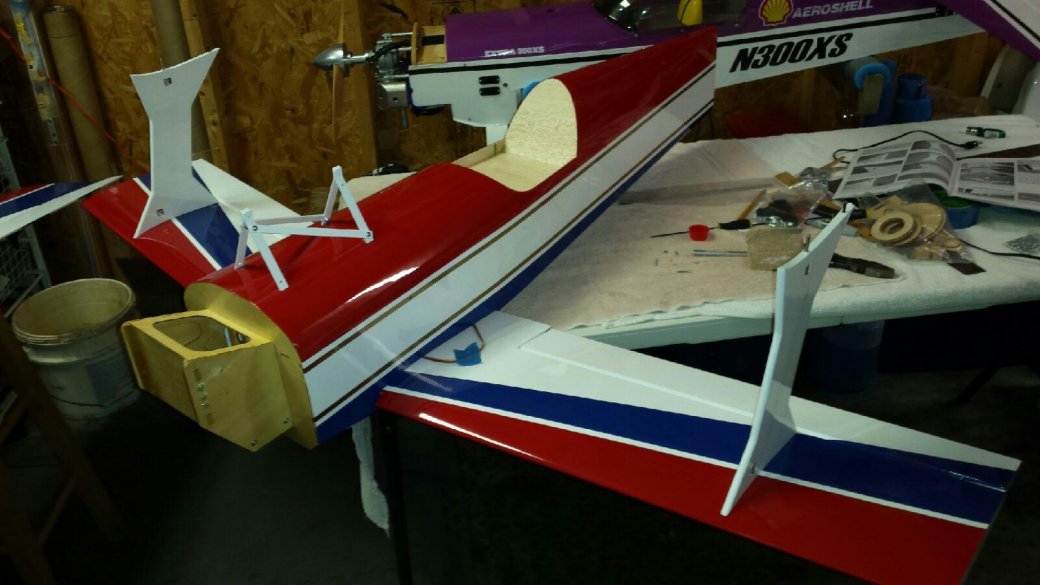

Got the horns installed on the ailerons!

Hey CC if you want to save some weight what I did on my last bipe was to just use servos in bottom wing and made my own slave struts to the top wing .
I also used a Sullivan quick connect on the top of strut so you could leave the strut with bottom wings when disassembled
This saves the weight of the 2 upper servos and wiring.
Just a thought .
Just a thought .
Had that setup on my Hogbipe and it worked great. Already installed all 4 servos in so going with the stock setup. Was thinking of some different mixing like crow and 4 servos are needed.
Thanks for the suggestion though!:)
