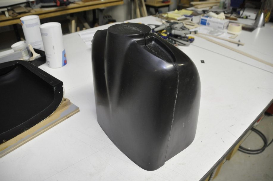

Cool Jetpainter, interesting stuff. I wanted to make myself a couple more cowls before I hand the mold over to Fibertech so today I tried a couple. Fist one was laid up with satin cloth, and it was immediately noticeable that it did not have enough structural integrity so I pulled it from the mold early. On the second one for today I went back to my old tried and true process but mixed in a little powdered graphite to give it a black color. This will allow me to really see the surface fresh out of the mold.. I've been sanding a little and cleaning up the mold with each pull. I'm super super happy with this right now. Very little body work to do before painting.View attachment 1894

Man, after these pics, and instructional posts, Who wouldn't want one of these awesome birds? Terry, have you thought any further on how you are going to do the cowl venting yet?:confused??:

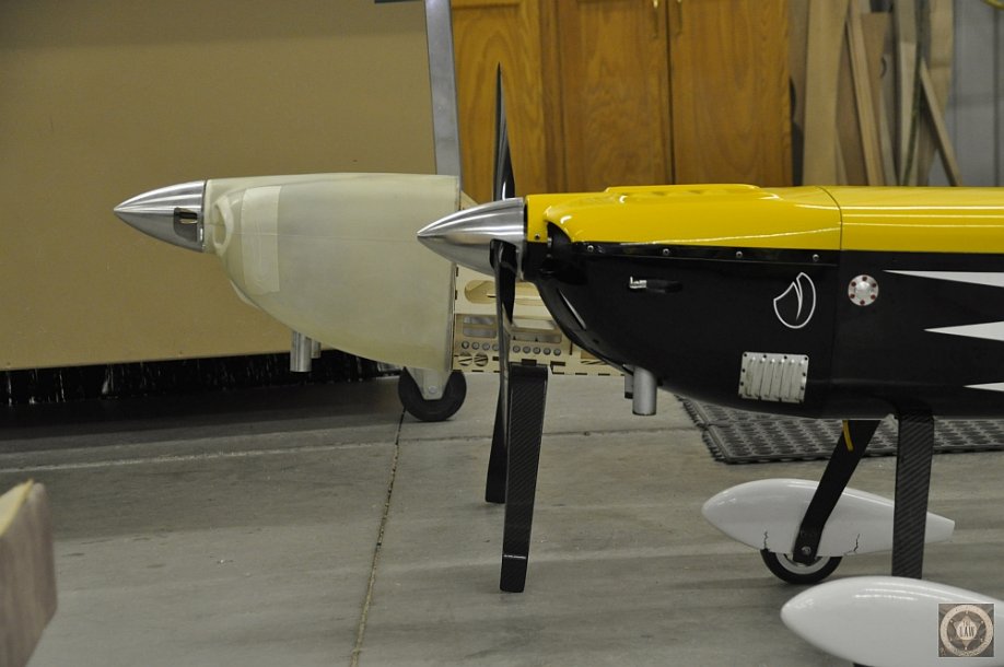

Absolutely, but they are small and detailed so it will be a task. There are two options: 1 - Make a mold and lay them up with very fine fiberglass cloth and then graft this assembly onto the cowl. The other option that I don't care for as much but would work is to make a plug and vacuum form them out of PETG to be grafted onto the cowl. Few reasons I don't care for this idea. I'll do what I can though as I also have ideas for different vent shapes and sizes that I could make and offer for other planes.

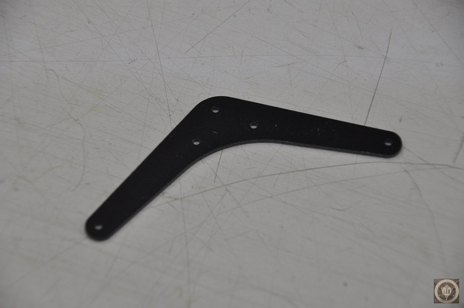

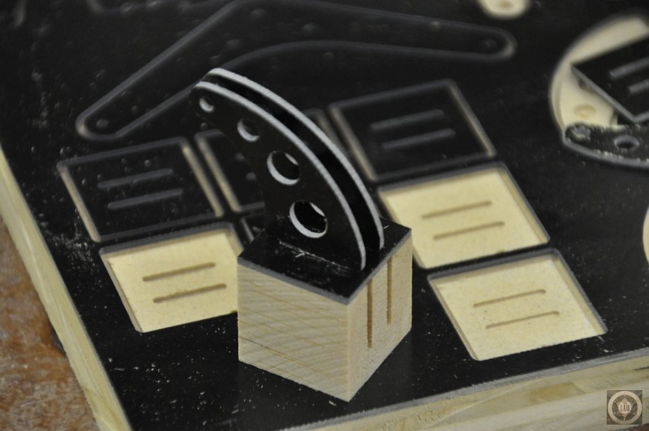

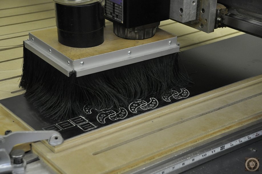

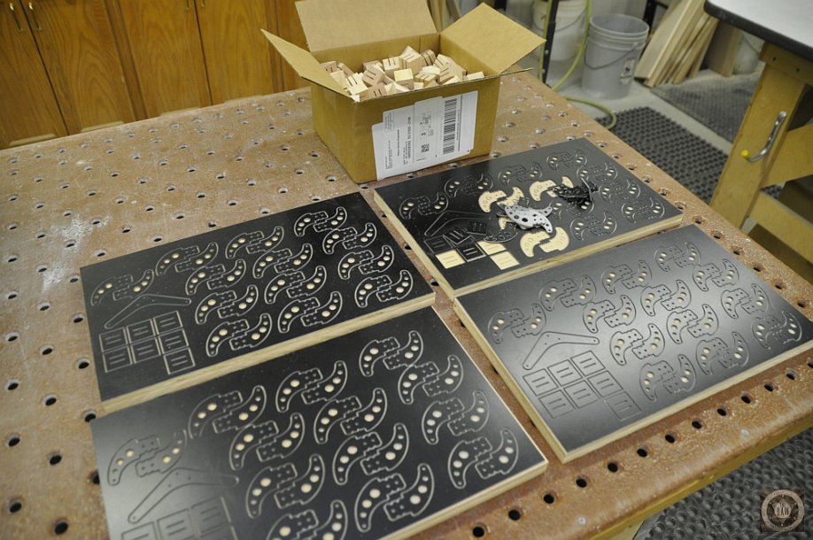

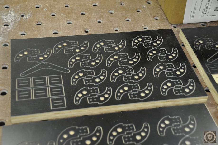

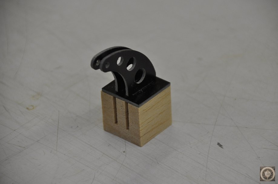

The LAW is CNC'ing up some control horns and I cut the wood blocks for them. I'd like to sell these as a kit separately, and have actually already sold a few kits to people. Maybe, just maybe I'll include a kit with the first few Vipers sold;)
