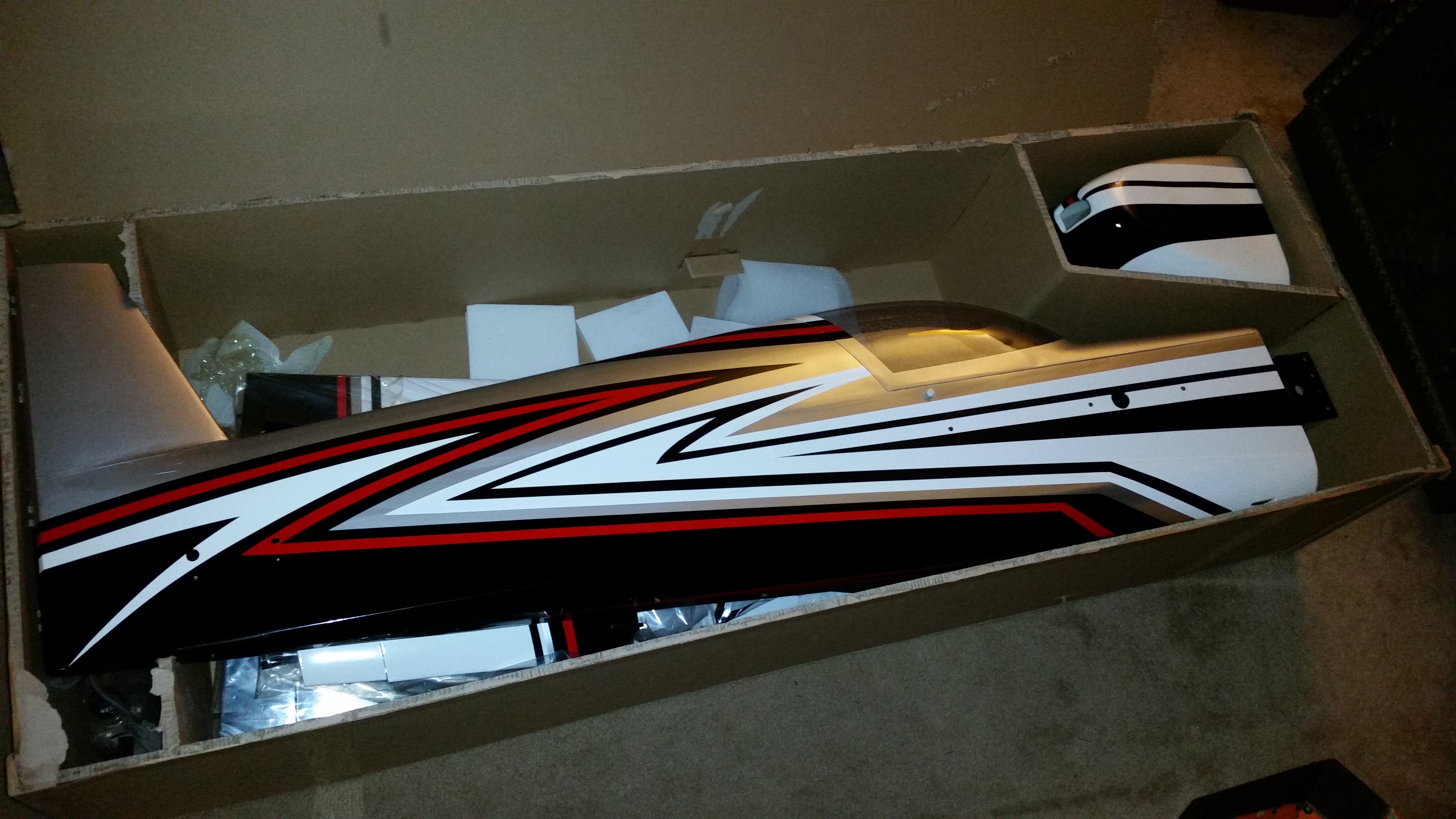

So I picked one of these up at the 2016 AMA Expo this past weekend, could not pass it up. I will try and be as detailed as possible in my build to give the lesser experienced builders a bit of a boost in their build. Some notes about the airplane:
-Covering is immaculate out of the box.
-Airplane is extremely well packaged and protected against damage.
-HIGH quality hardware is included!!! This includes aluminum wheels with replaceable rubber, tailwheel, and even a pre-assembled Fourtitude style tank!
-Options for engine exhaust setups (I will be running mufflers).
-Plenty of extra matching covering for repairs or building goofs...

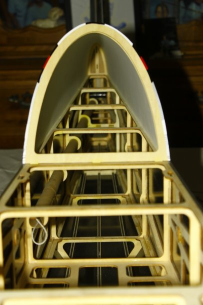

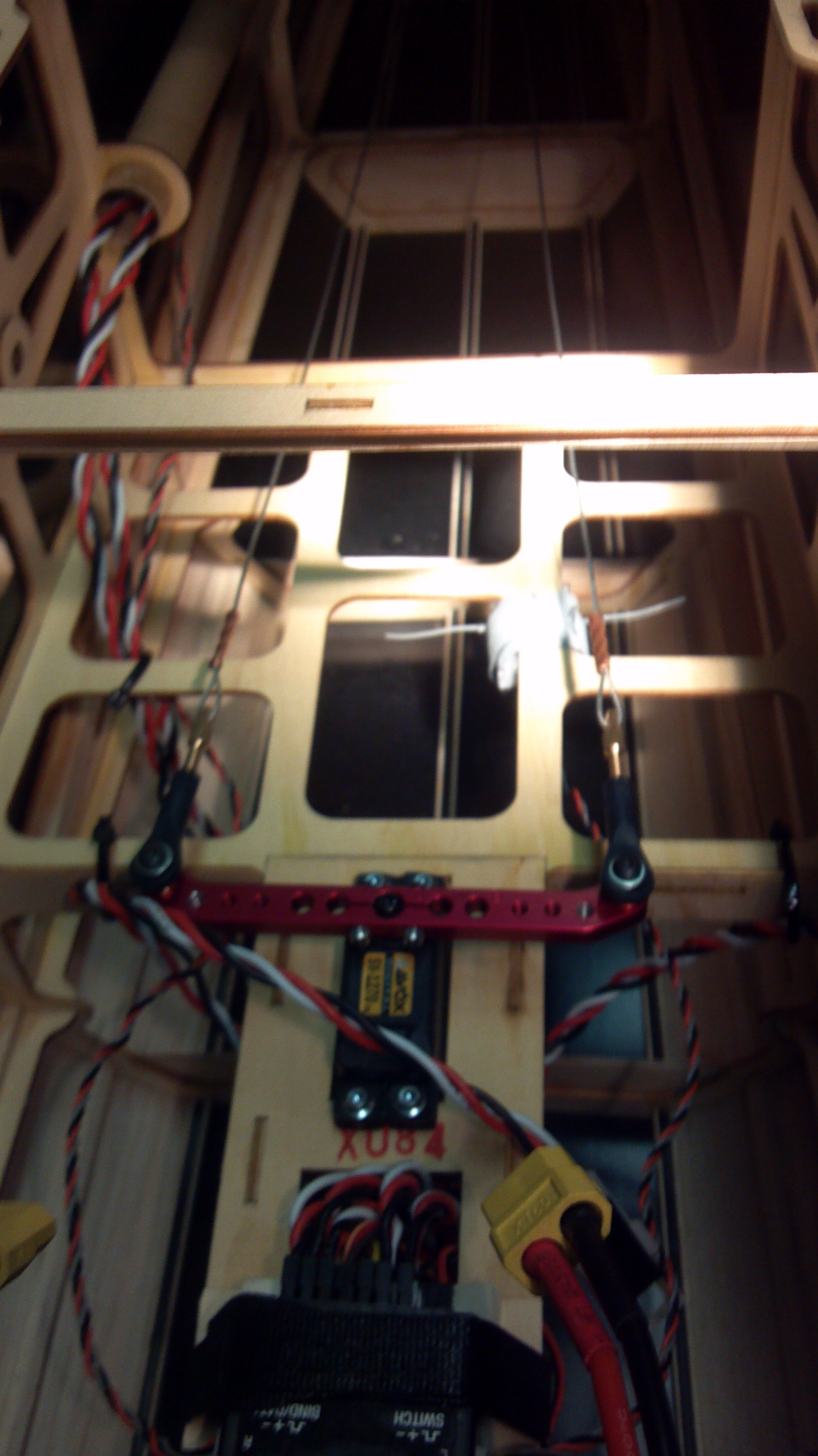

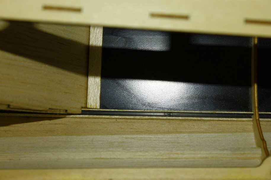

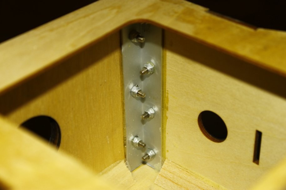

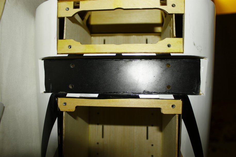

Mine was received with some fuselage damage but was promptly replaced by Ray so no complaints. My ailerons were glued in so don't be surprised if yours are. The bottom of the fuselage formers have a notch in the middle for the carbon fiber rod running the length of the fuselage. I recommend reinforcing them with a section of 1/16th ply, otherwise they can be easily broken at that notch when handling the bottom. Make a template with cardboard and then cut the ply to fit. Hopefully the attached pic is comprehensive.
I installed a DLE61 in mine and it came in at 20lbs with 16oz of fuel and has plenty of power. The DA70 is going to add another pound and you'll probably want to go with a 24oz tank for the flight time so another pound and a half total. I'm sure it will still fly great, it just won't be the float monster it is at 20lbs and considering how it flies at that weight, I wouldn't want to add any more and sacrifice performance. I've got the 93" Extra with the DA70 in it. With 24oz of fuel it weighs 22.5lbs and that strikes me as the perfect match. They're both great looking planes in the air.

DLE61 with J-Tec wrap around. 2x 2200mah 2 cell lipo through Powersafe Rx. Savox 1270TG x5 and Hitec 5565 on the throttle. My weights are honest weights ready to fly with fuel, not the fantasy, wishful thinking BS weights I hear about quite often. BTW, what is "very light"? That doesn't really tell us anything about actual weight. Maybe Santiago can report what his weighs RTF with fuel so we can get some perspective. The three formers that I reinforced added 12 grams to the plane and is an obvious improvement in strength, so for me it's well worth the preventive maintenance.

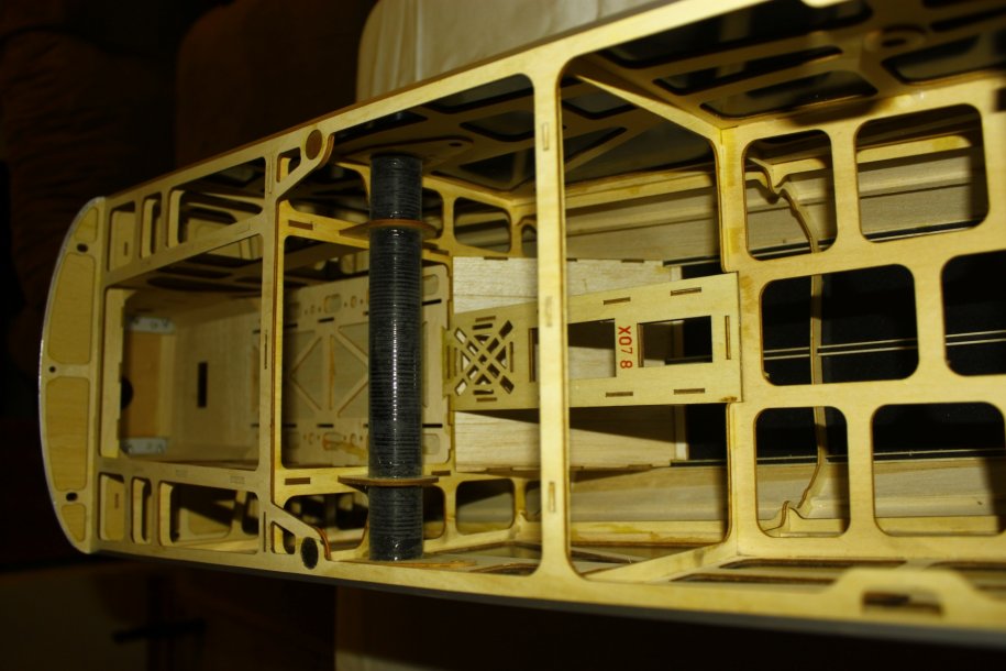

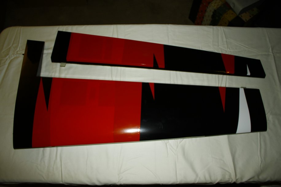

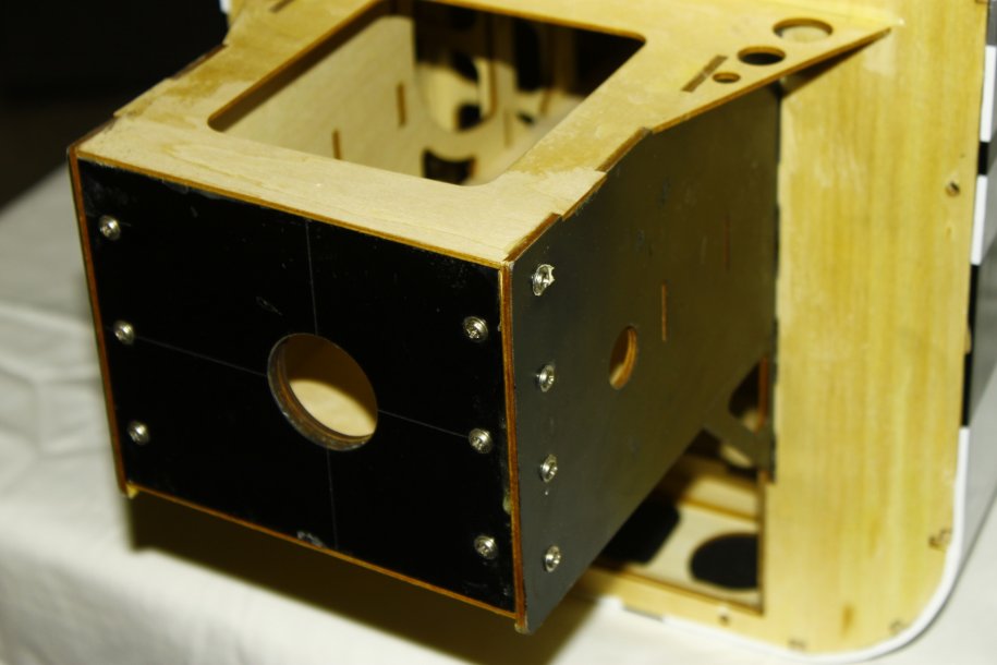

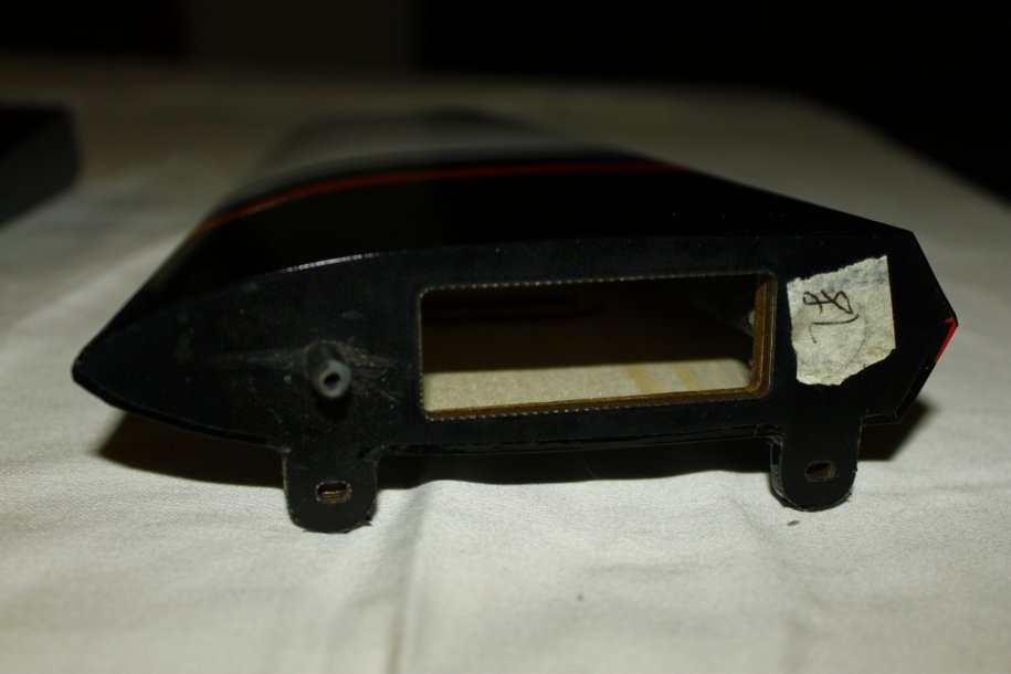

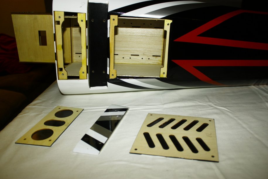

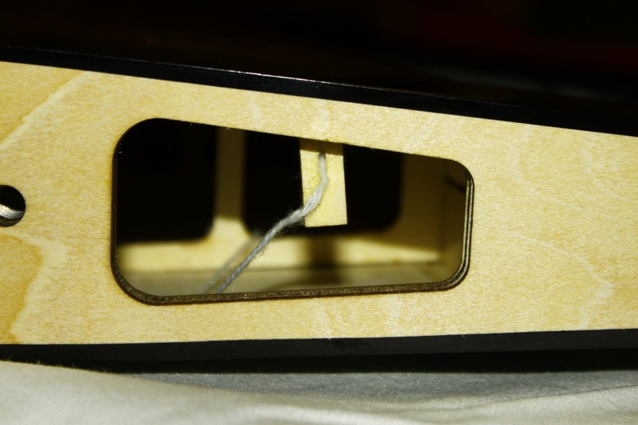

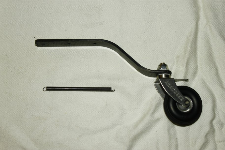

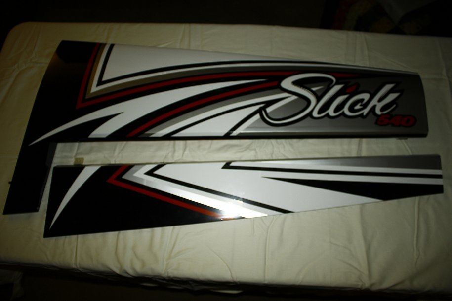

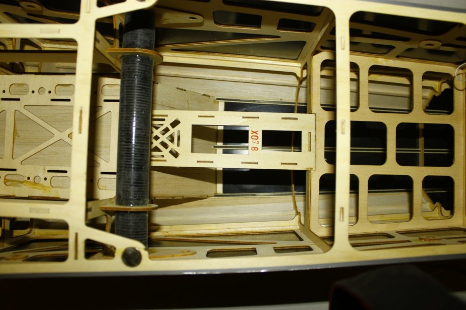

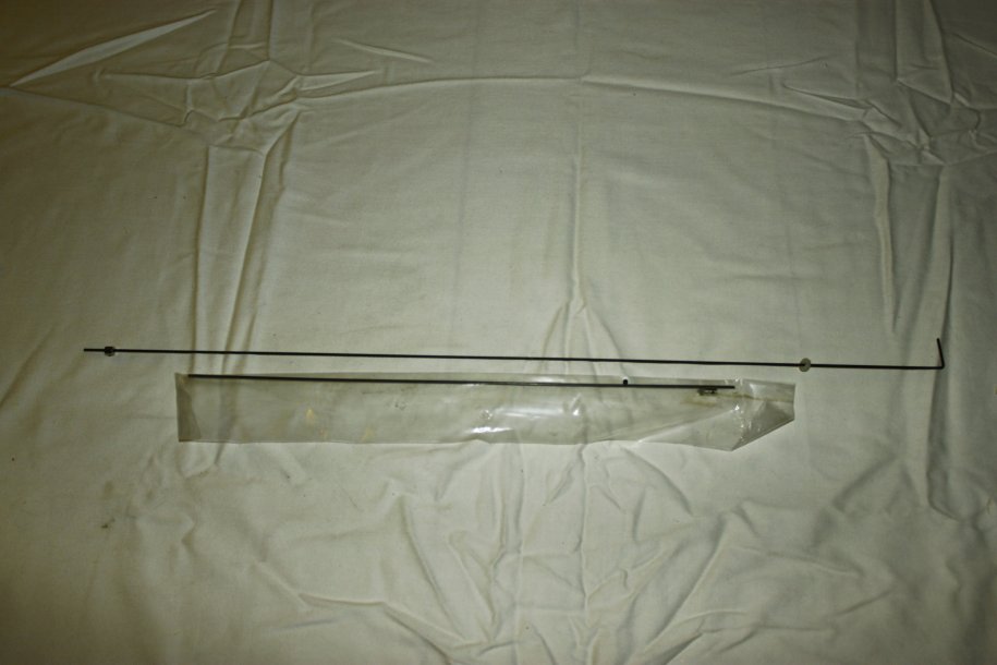

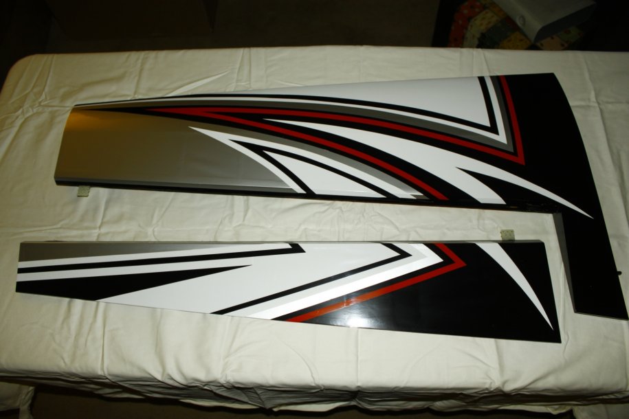

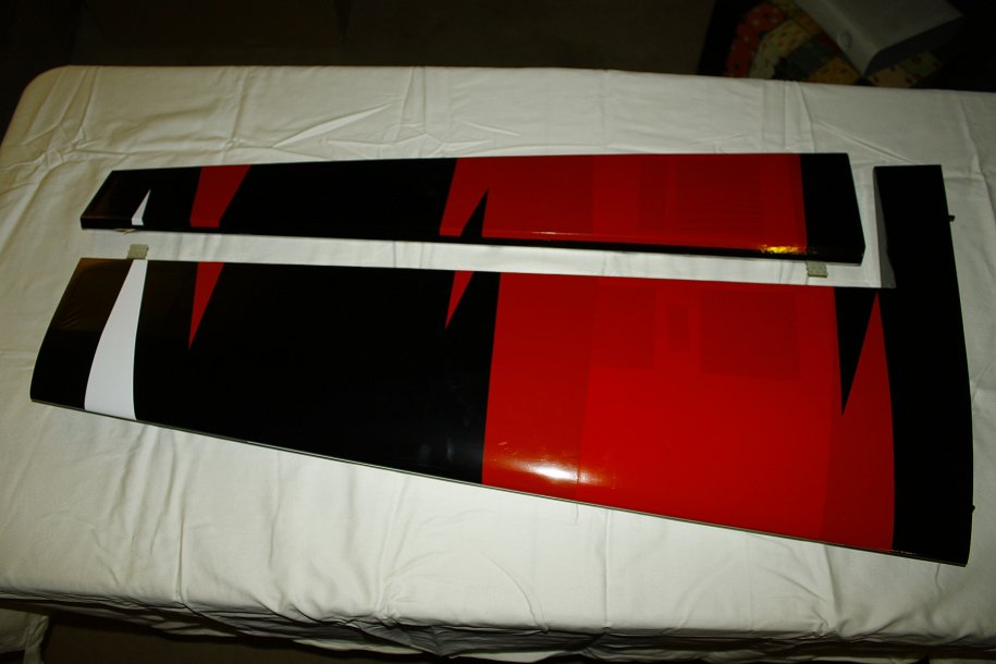

Here is some awesome picture hotness for you guys!

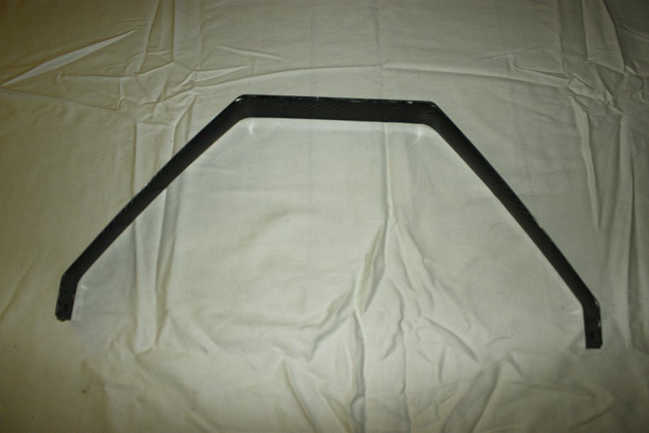

The airplane comes with carbon main gear, pre-drilled and ready to bolt in!
Also includes SFG's that bolt in place as an option, I will be running them.

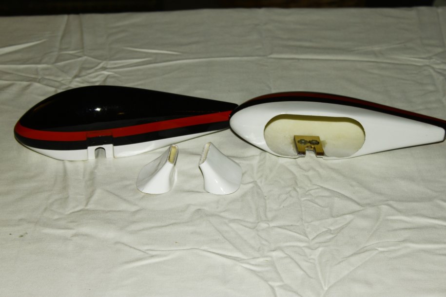

Wheel pants and gear cuffs come pre painted, made of really strong fiberglass. The pants have the mounting blocks/nuts already pre installed.

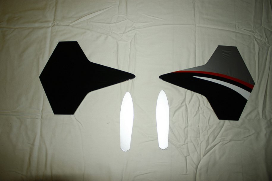

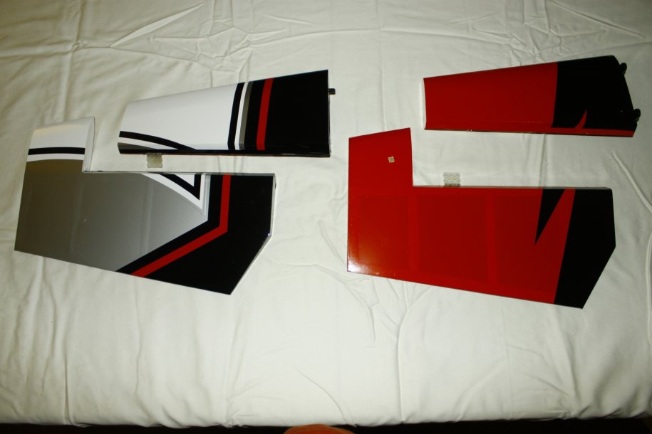

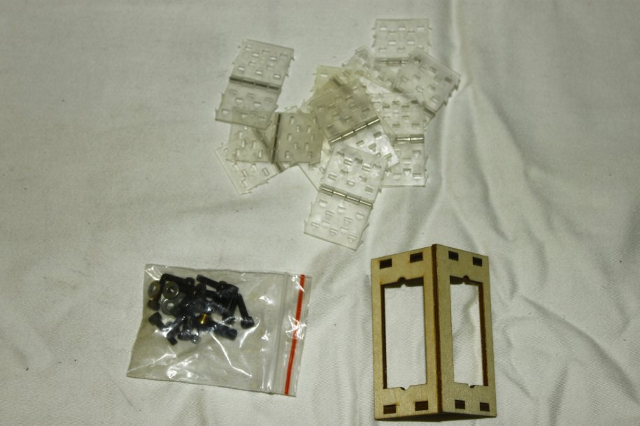

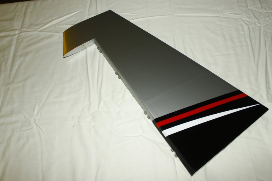

The elevator/stabs do not come pre-hinged which leaves you the option of how you want to hinge them. I will probably use the stock hinges, they seem to be real high quality. Also has CARBON reinforcing the mounting side!!!
Rudder and vertical stab on the fuse side have the hinges pre-installed, this is a removable setup which makes it easy to fit it in smaller vehicles. I will be taking advantage of it.

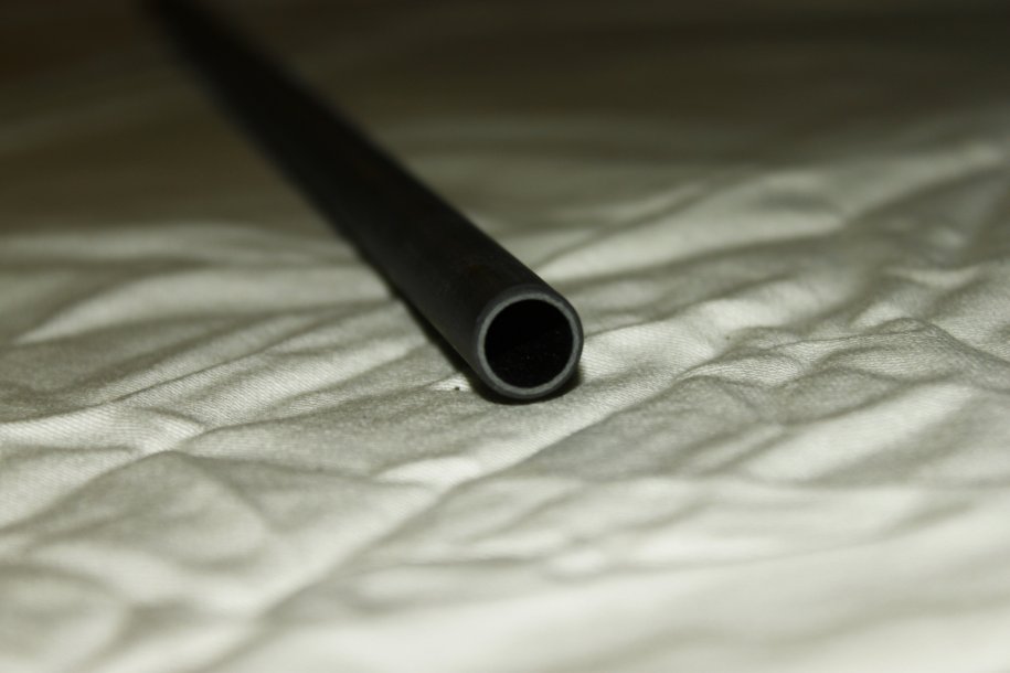

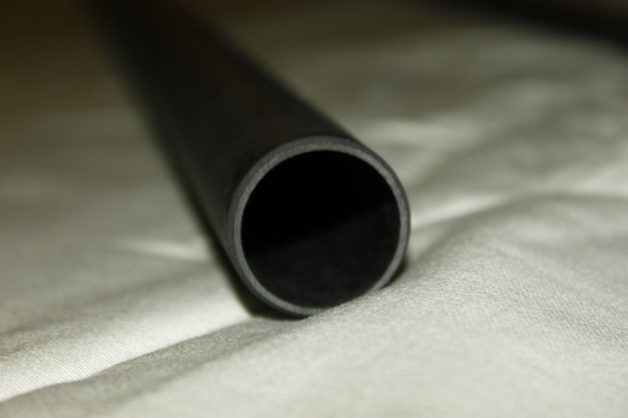

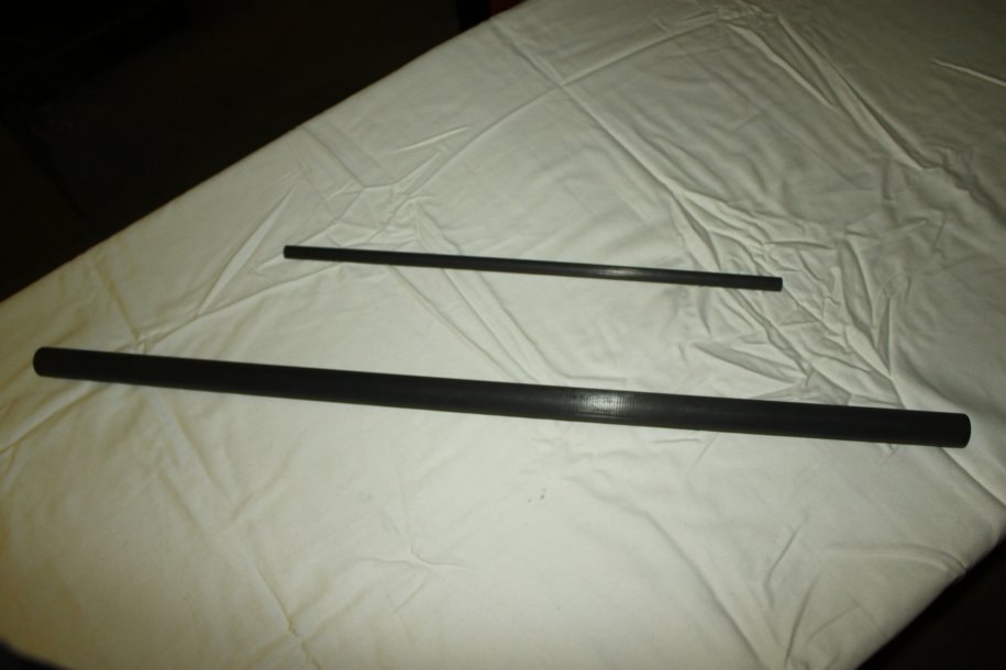

Wing/Stab carbon tubes are THICK and ready for abuse!!!

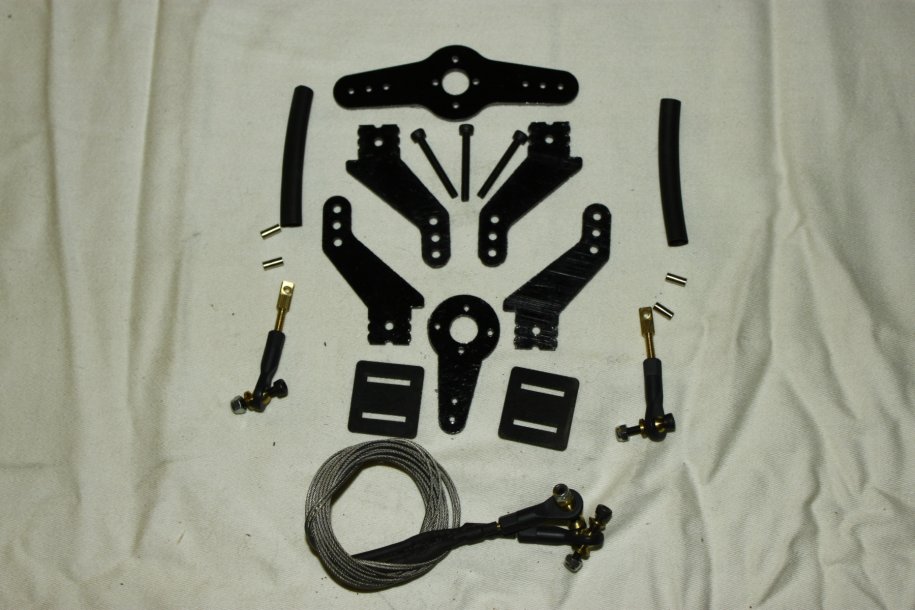

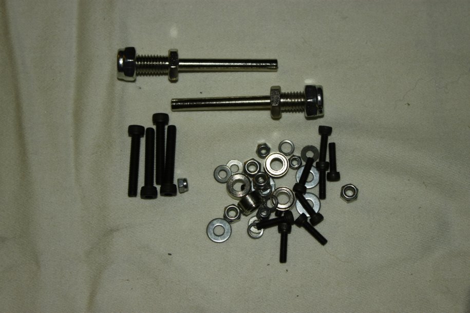

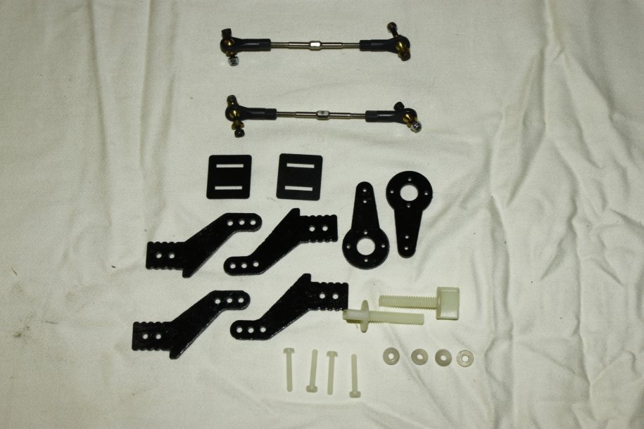

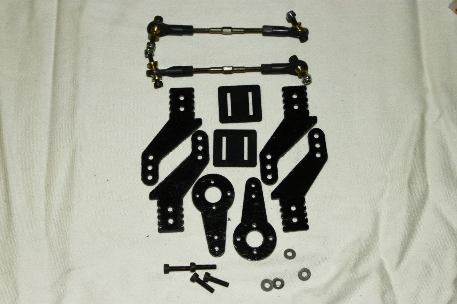

Misc. hardware. Kit comes with some really quality linkages and carbon fiber control horns. There are also servo arms that bolt onto your existing servo arms, but I'll be using aluminum SWB arms.

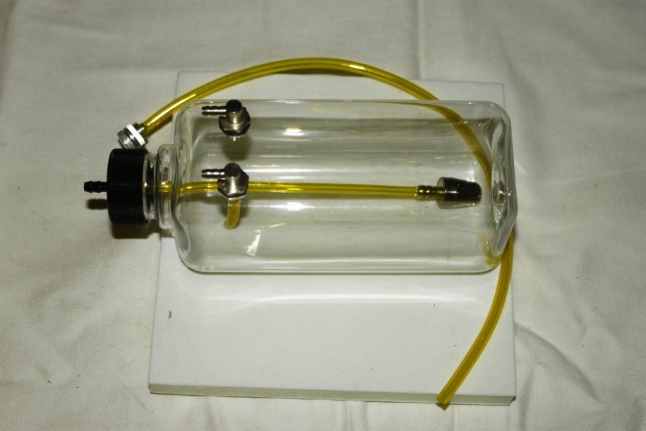

Fourtitude style clear tank comes completely pre-assembled and ready to go in!

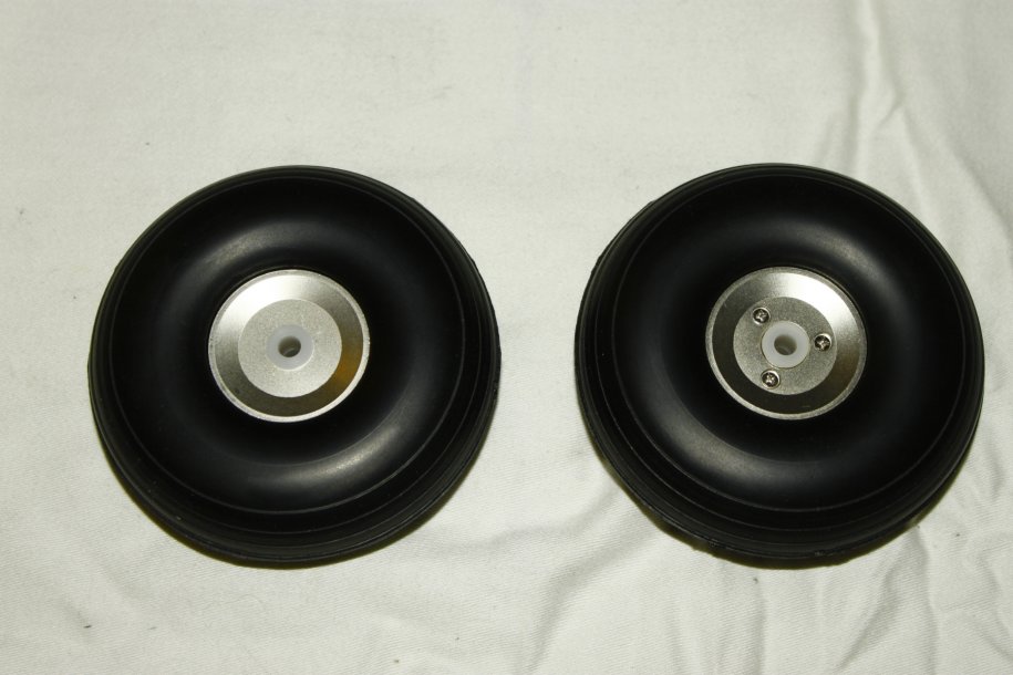

The main wheels and tailwheel assemblies are super high quality, the rubber is actually replaceable on the 3.5" wheels. Aluminum hubs as well.

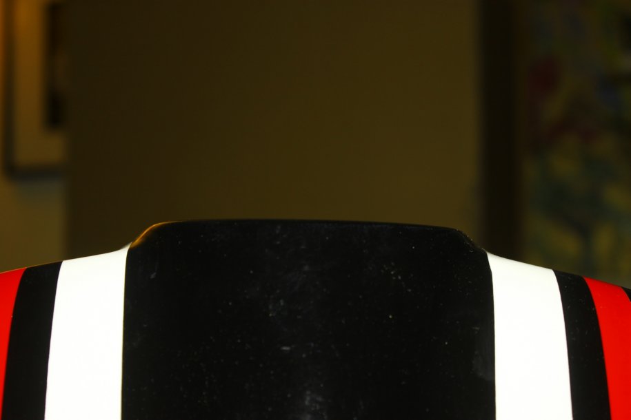

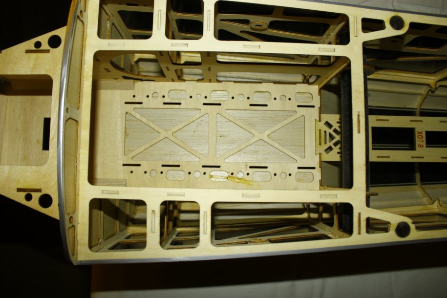

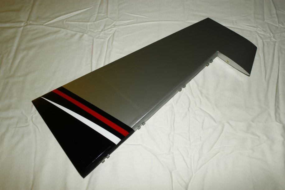

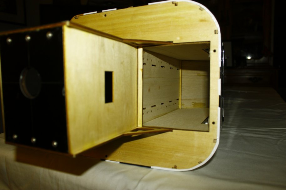

Misc. airplane pictures. Note lots of carbon throughout, including carbon reinforced stringers, carbon landing gear plate, and carbon reinforced landing gear plate.

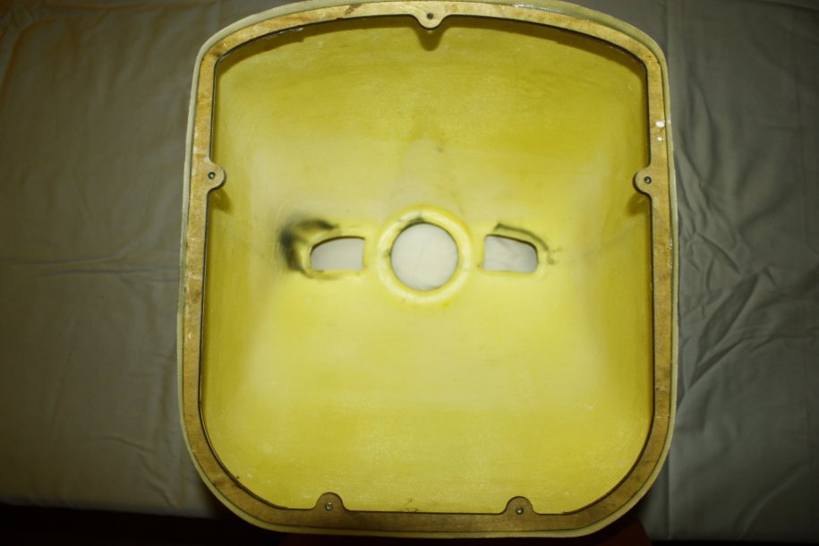

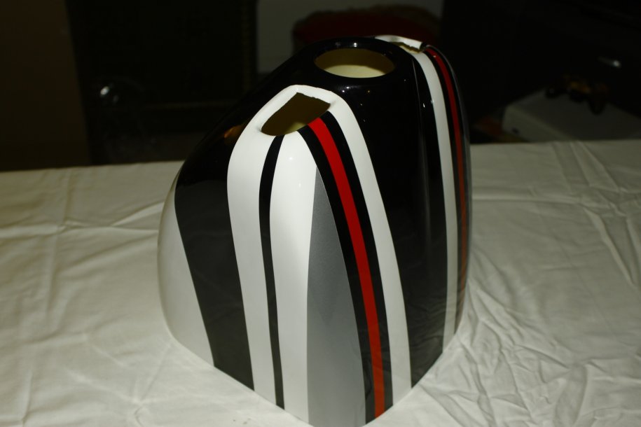

Cowl is pre-painted to match perfectly, and has thrust alignments built into it as well.
Lots of good quality stuff throughout, very impressed with this kit. The 70" Slick Pro was impressive (and don't get me wrong, I LOVE that airplane still), but this raises the bar to a completely whole new level. I feel like the price tag should have included a lot less, but they really went above and beyond with the airplane and took care of you.
