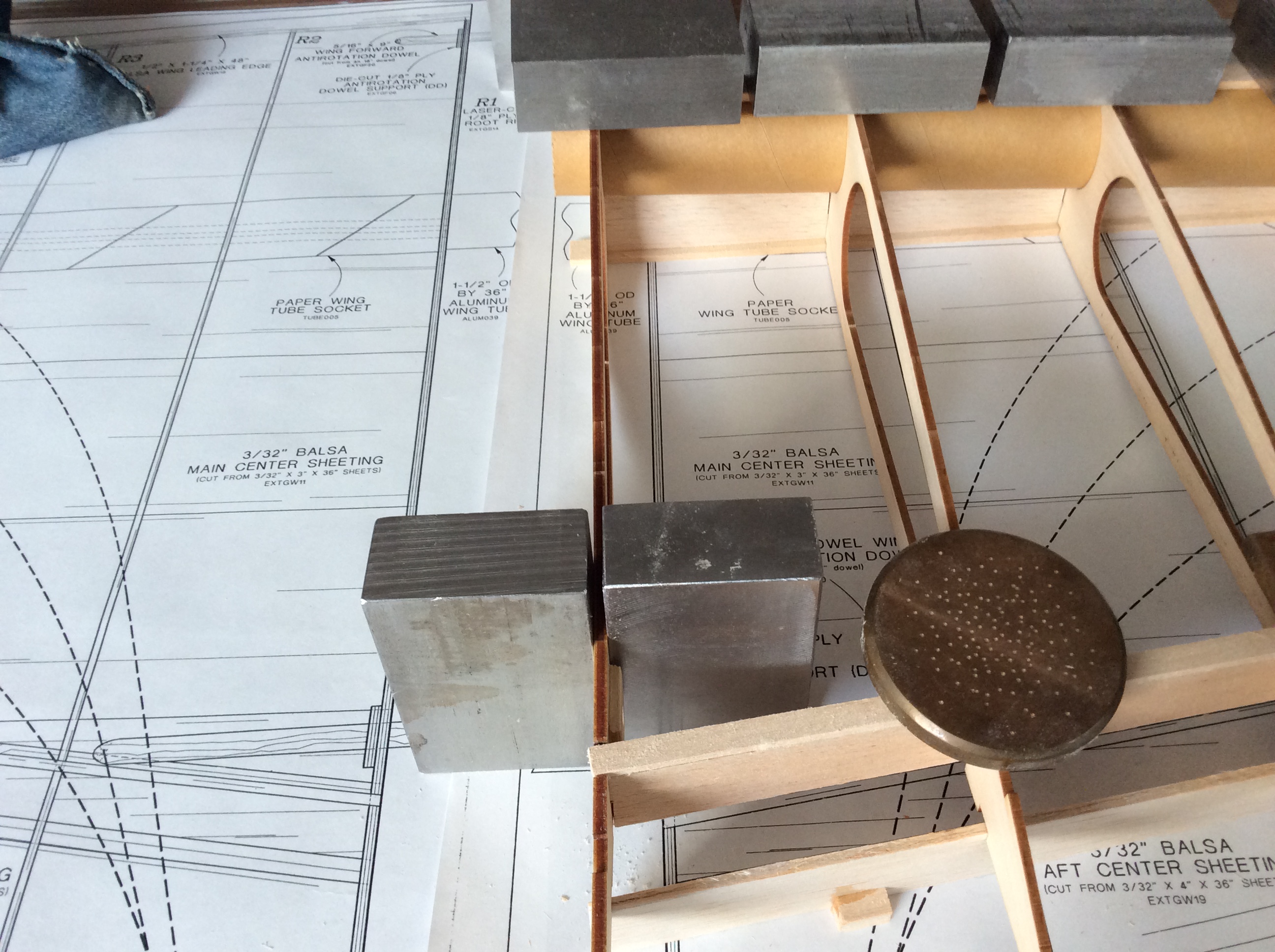

Well haveing an interesting afternoon. Trying to put the wing together, but it is not doing what I would like it to do. Struggling to get it straight and square. The drawings are rubbishy the jigs that come with the plane do not match the drawings that are off by over an inch. And the trailing and leading edge supports do not reach the ribs. The wing tube and the spar with the interlocking shearwebs are not matching up with leading and trailing edge support heights. One of them are off.
As you can see from the picture above the wing tip rib is lined up with the drawing and the fuse rib does not line up with the drawing at all. Have to stand back for a while and decide how to make this work and end with straight wing.
