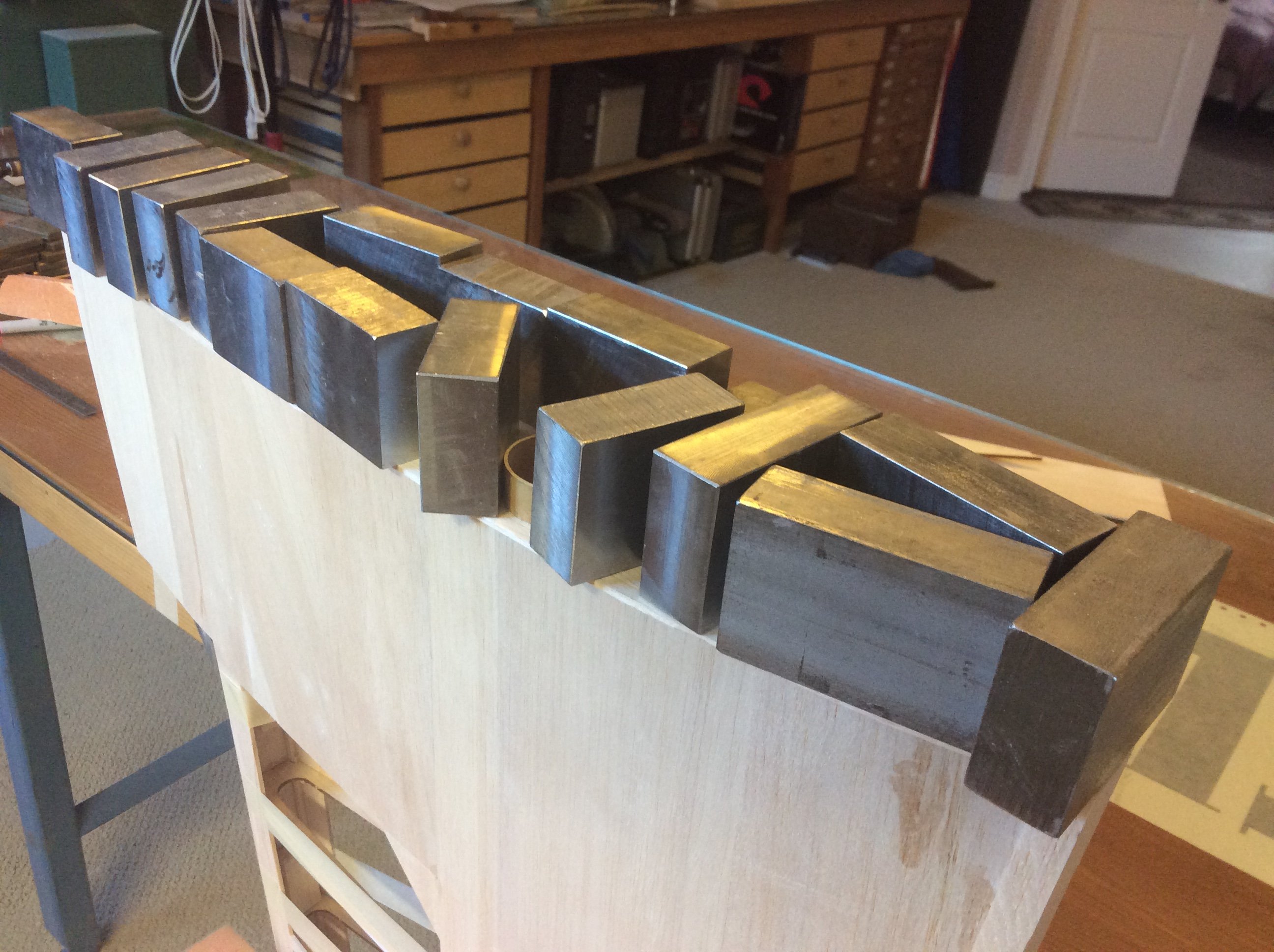

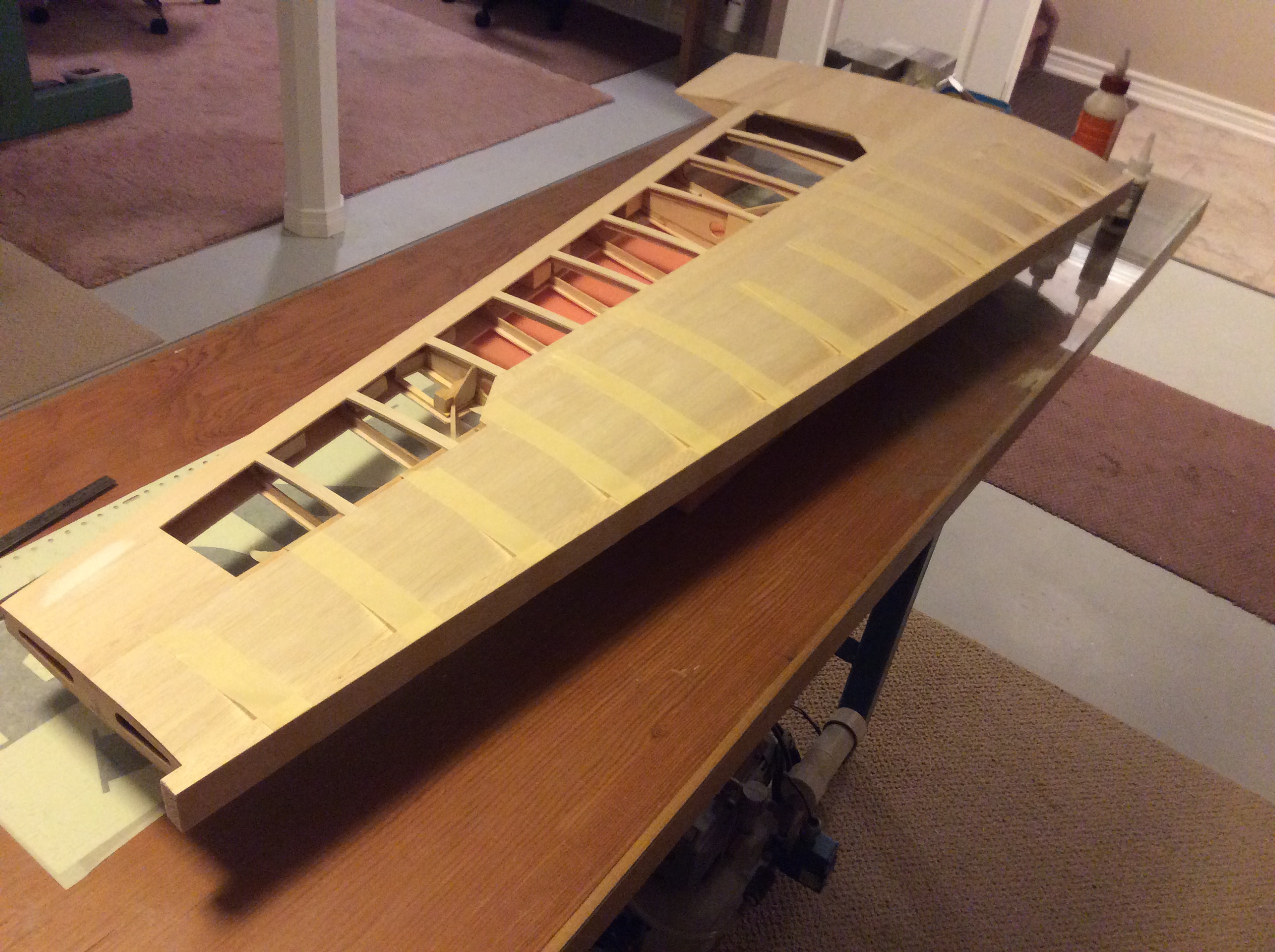

New bottle of glue got the leading edge glued on and all the hinge pin blocks glued in. All that needs to glued to the wing is the two end caps and bevel. Little bit of sanding and then put to one side and start the second one hopefully it goes a lot quicker.
Got the one end cap rib glued on . Look for the hardest ugliest piece of balsa wood I have then make end cap rib. Do this for 2 reasons when sanding the wing to match the fuselage it is easier to sand balsa and you do not sanding into the light ply root rib. Just. 3/32 rib does the job for me.
