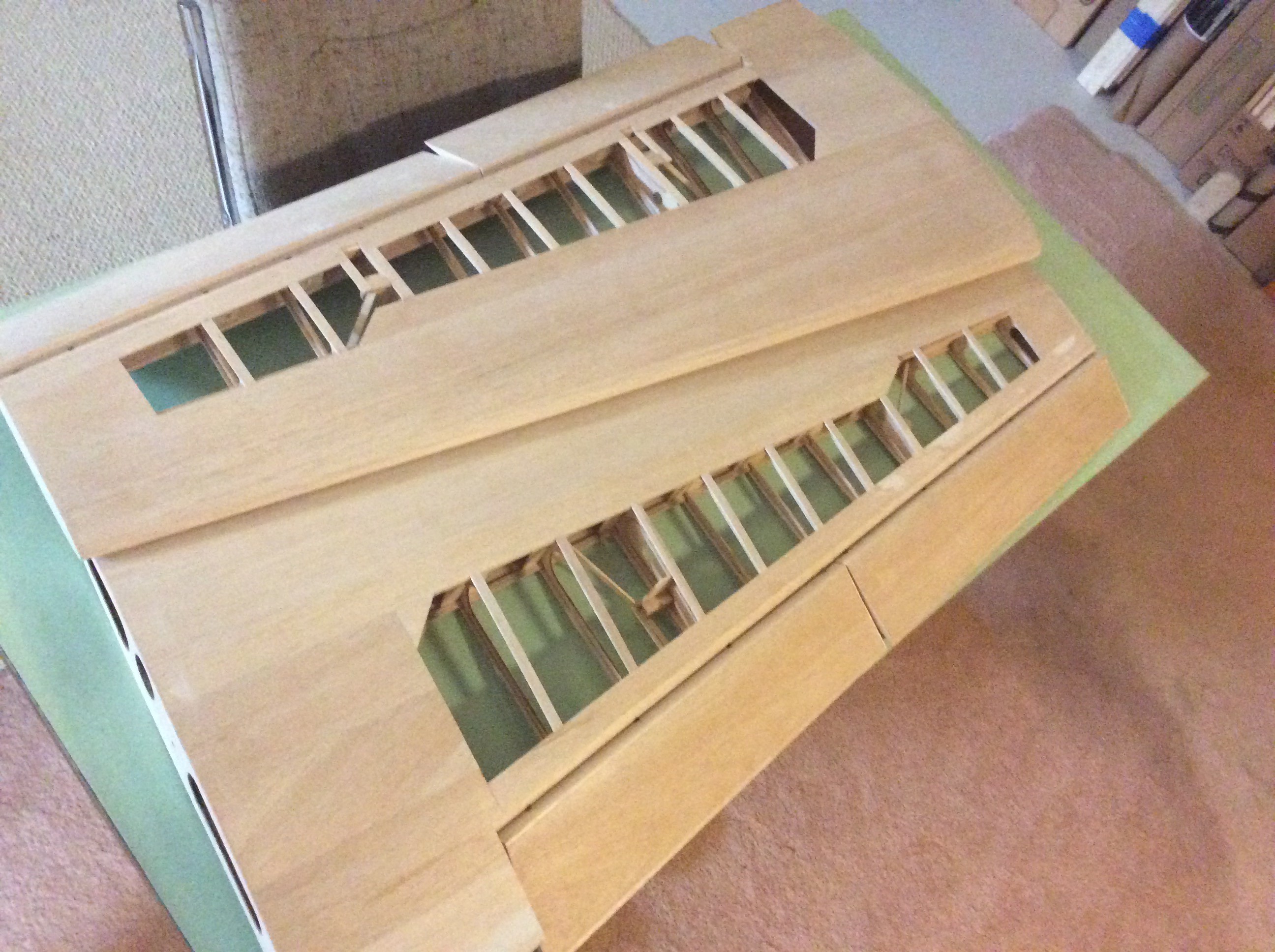

Ok done the hinges on both wings so that is done. Other than the engine being fitted to the fuselage and the cowl fitted to the plane and engine the building is done. The only things that need to be done is two hard points added to the two elevators and some hard points added to the rudder for control horns and the connection for the rudder wheel. So it is very close to the end. Need to buy an engine to continue it would have happened if I were at JoeNall. But not this year.

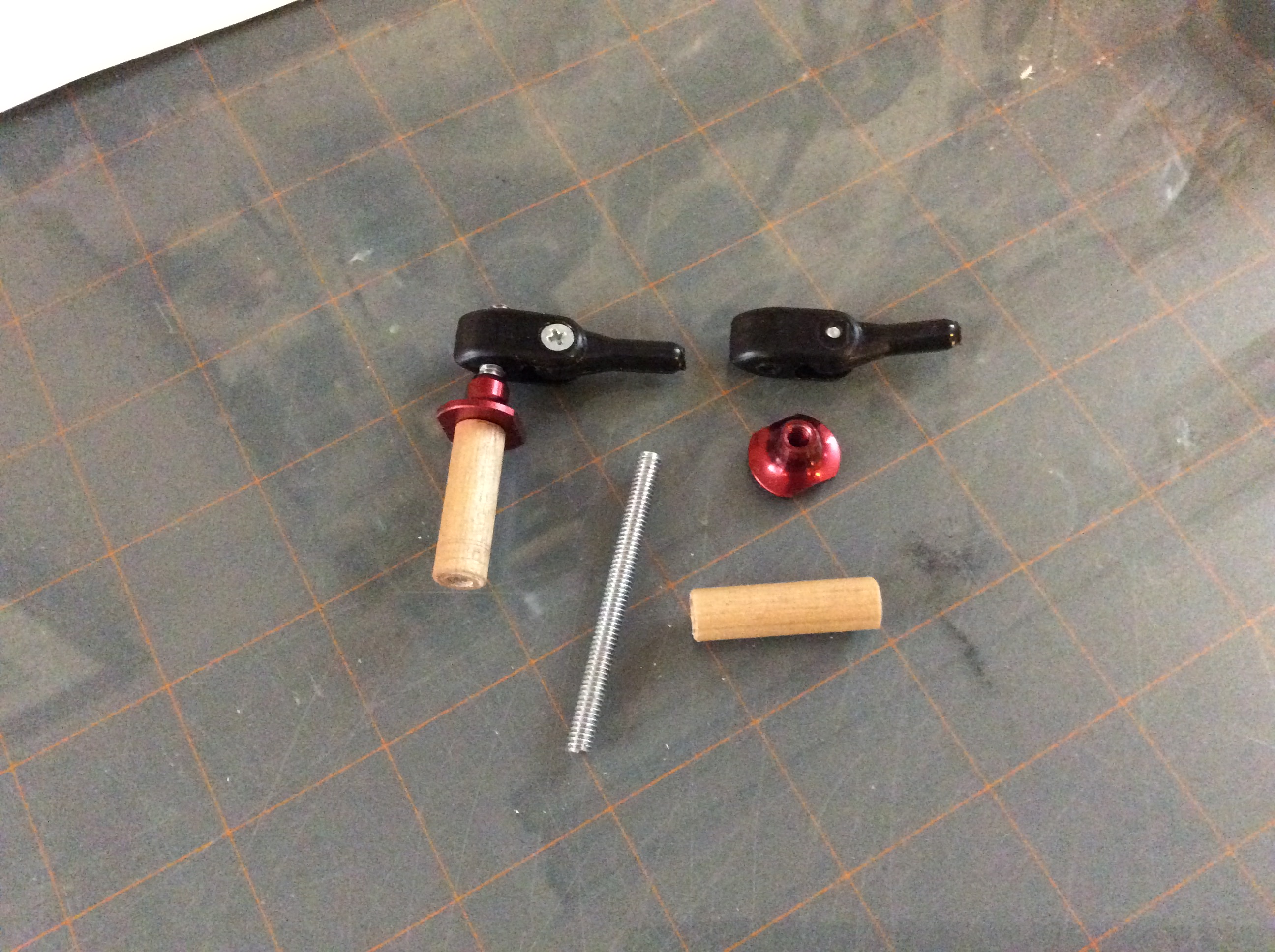

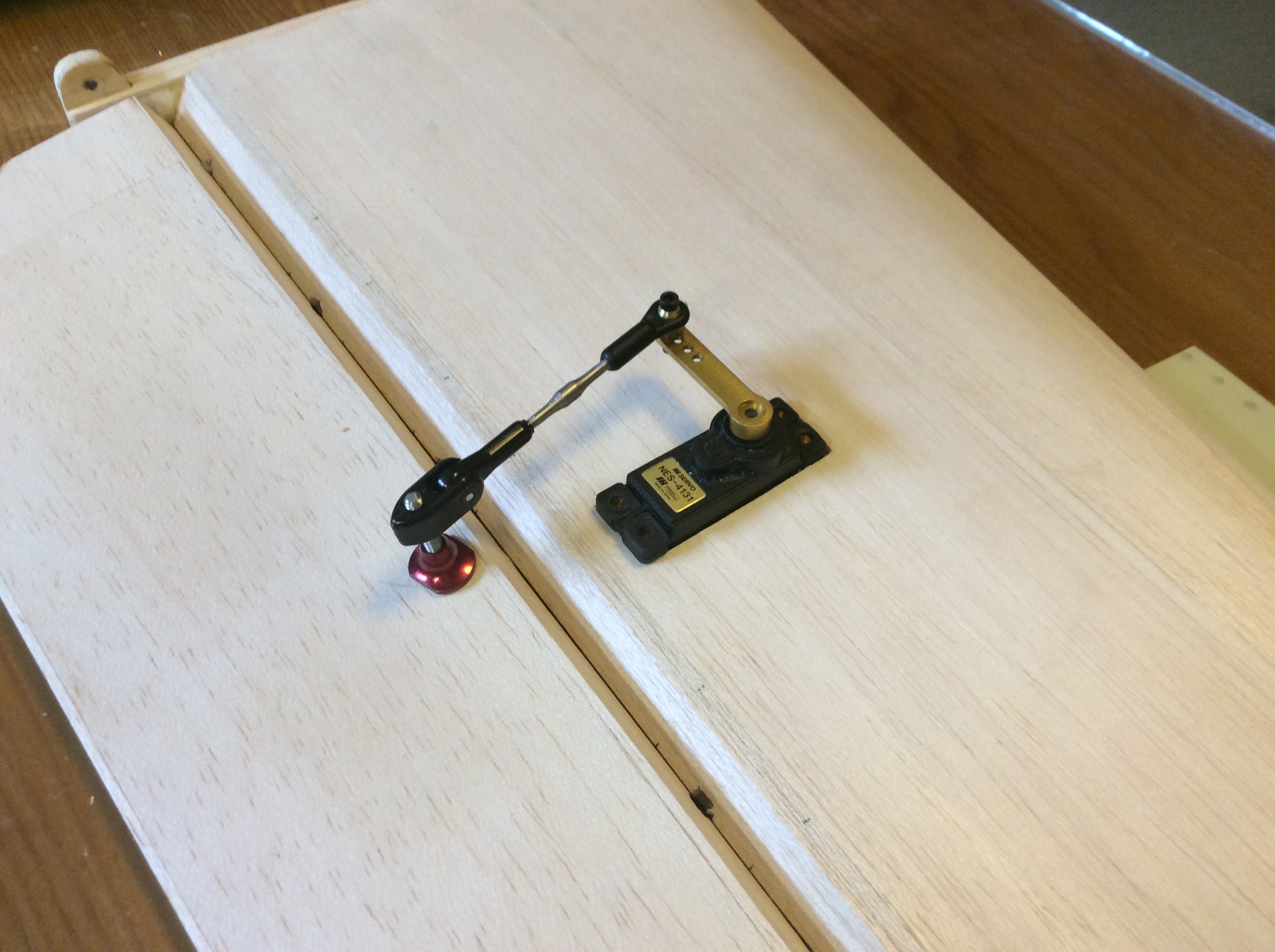

Yes it is raining again we have had over 3 inches of over the last week. Back to plane building. Went through my junk laying around. Found enough stuff to do the elevators. Made up two 8-32 threaded rods and 2 maple hardwood bushings to inserted into the elevators. All that needs to be done is drill some holes into the elevators glue in the bushings and then glue in the studs.
The 2 elevators are done except for covering, the linkage looks nice and sturdy and should not need any attention for a long time.

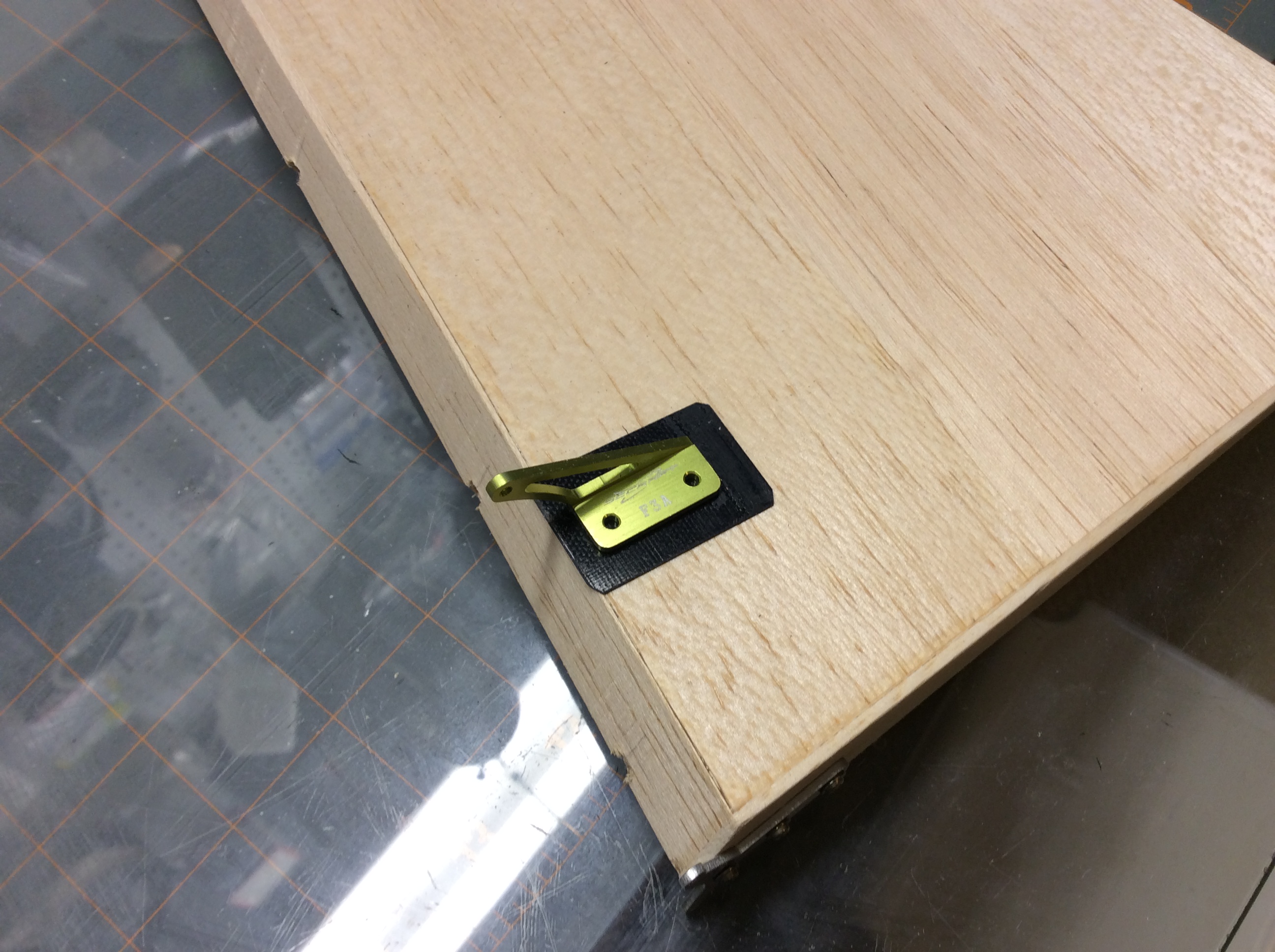

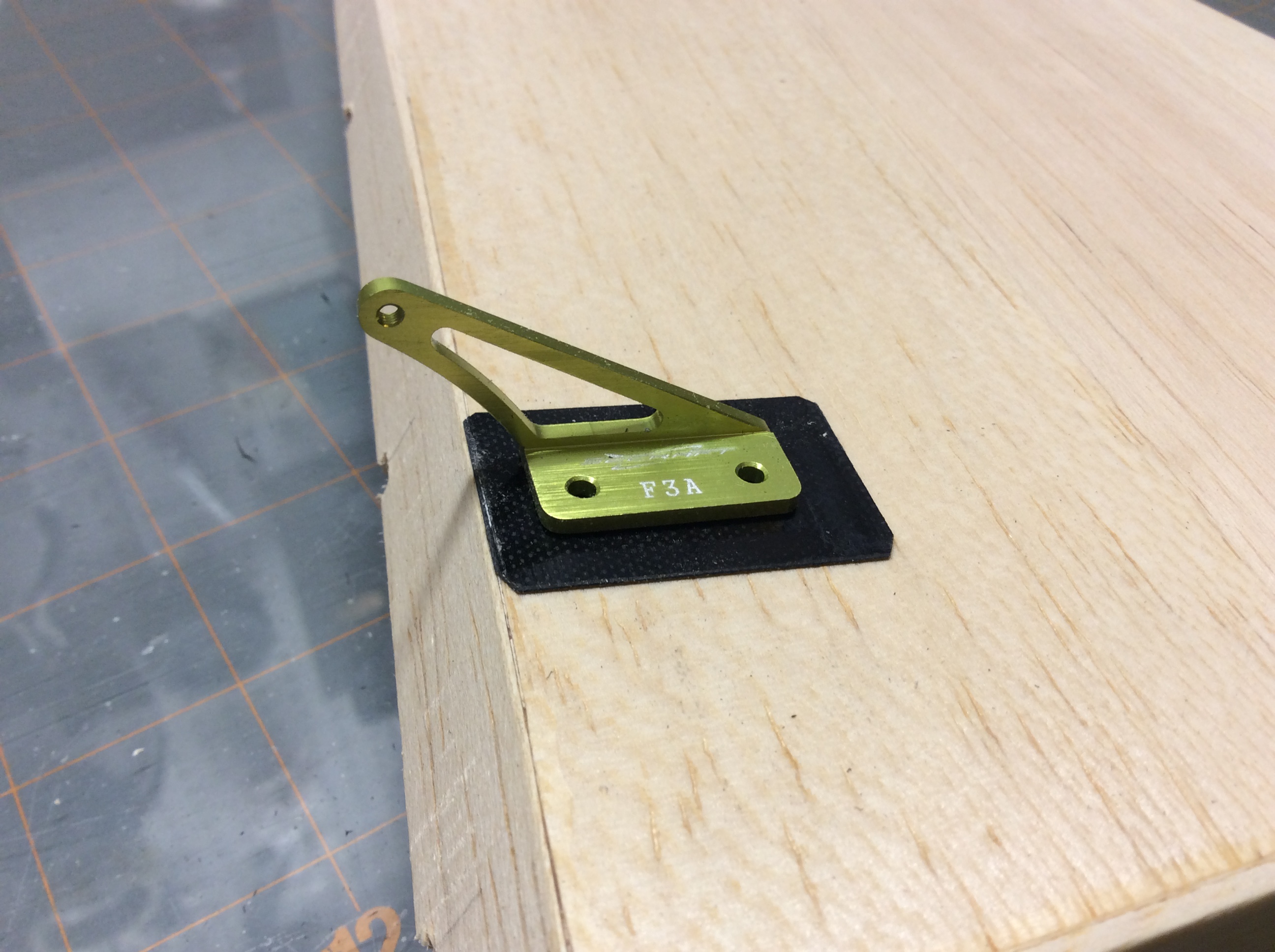

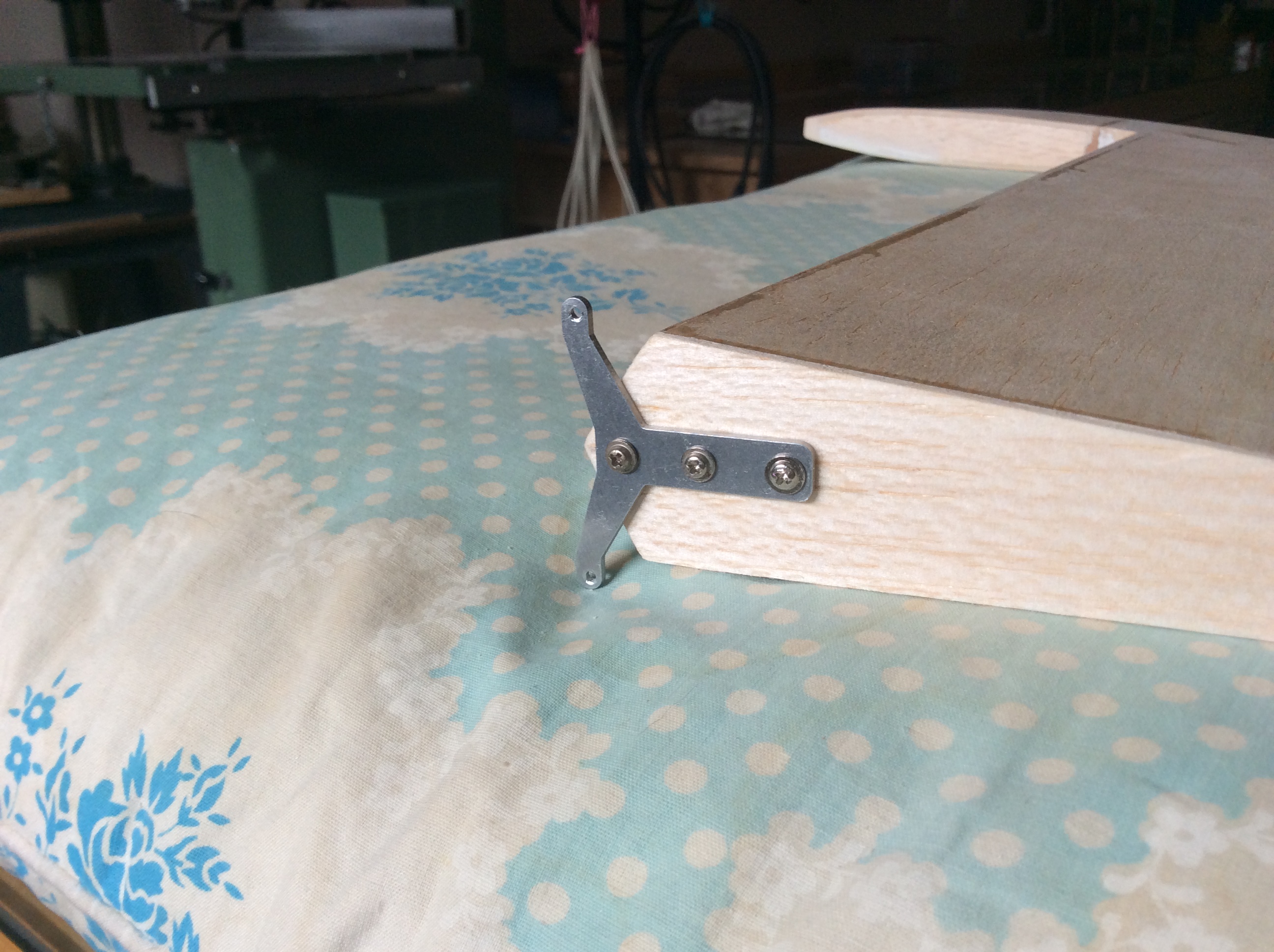

Got the rudder attachment made did it the old faithful way 3 pieces of nyrod pressed in 3/4 of an inch and CA in place. Then three wood screws in to the nyrod so that is done. Have a little difficulty with rudder not sure if I am going to use one or two servos. They have to be in the back because the plane is not set up for pull pull cables. So need to install one or two servos in the back. Anyone have any suggestions, one is easier to set up but??
Found some carbon plate and 2 horns. They will do the trick for the rudder just have make some rods that are long enough to go through the rudder and pick up both horns. Hope fully the carbon plates prevents the horns from digging into the balsa wood. I believe I am going to go with 2 rudder servos in the back. Hopefully I can compensate with the motor installation that I do not end up with a tail heavy plane, I just refuse to add dead weight to a plane.
