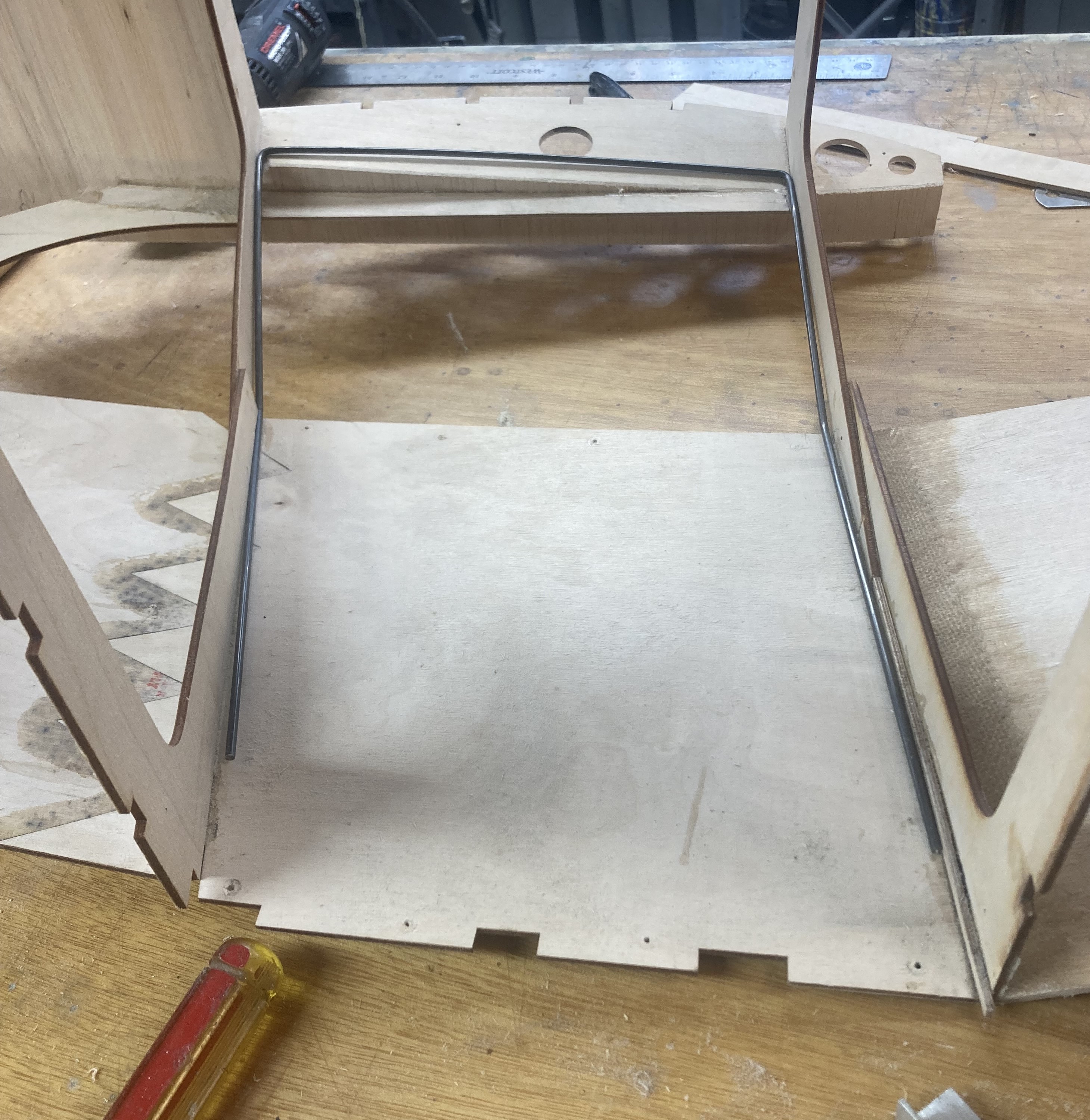

Fitting 1/8"music wire from former 3 at the side up to the wing rib and back down former 4. These will be encapsulated with epoxy and milled fibers. Wish I had done this on the Champ, had to go back and fit the wires after the post cracked.
TonyHallo
Have the right side wire installed, both still need encapsulated.

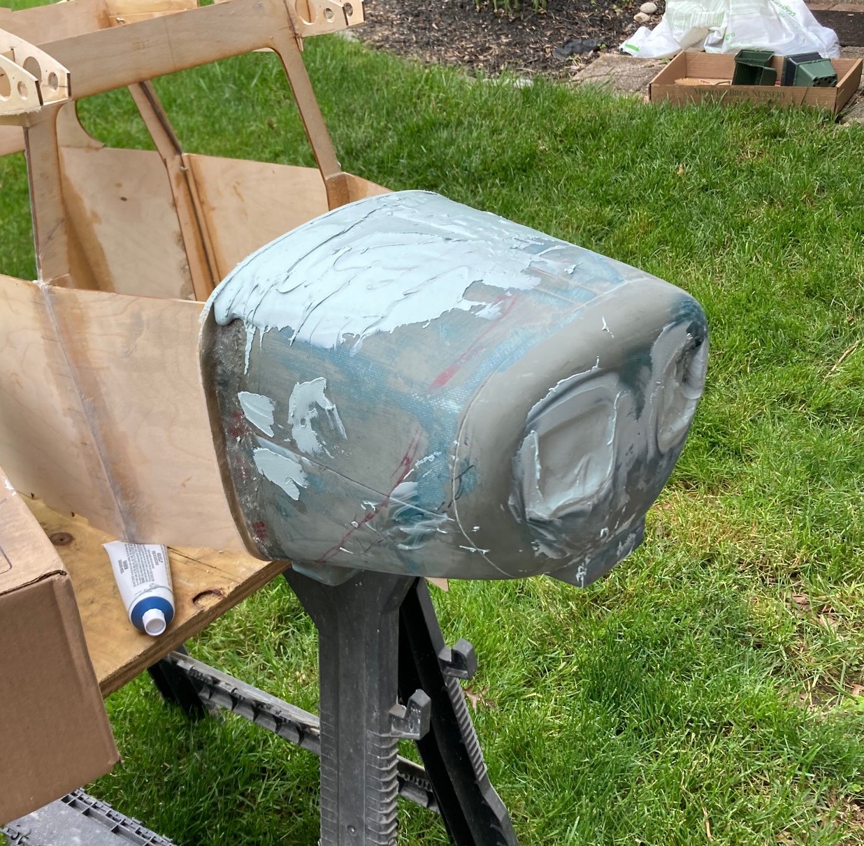

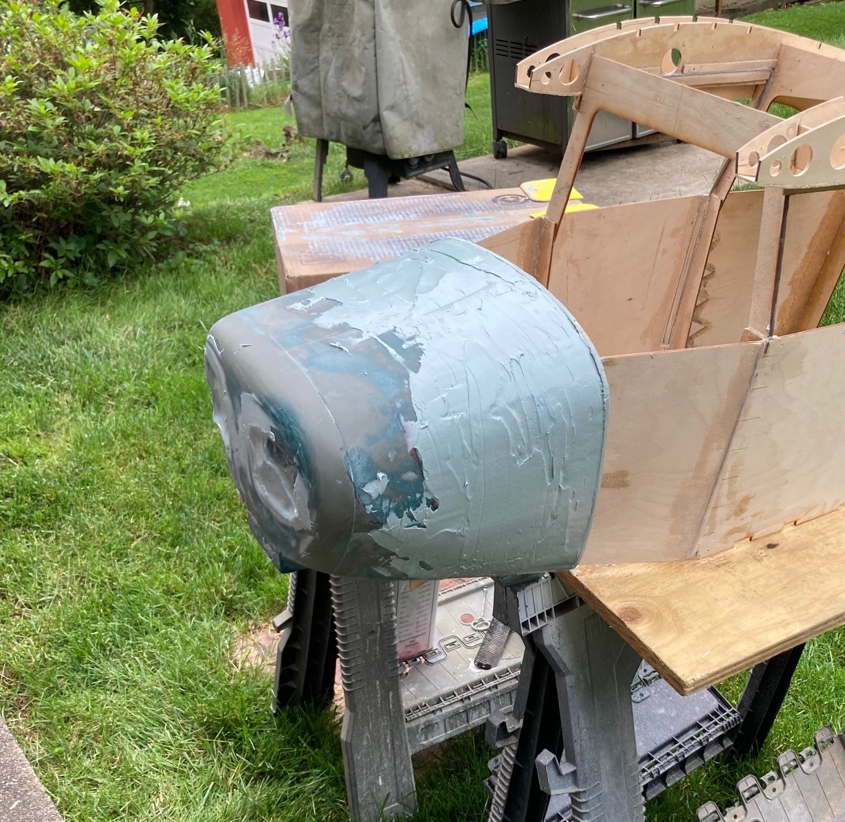

Weather got me stuck painting so I decided to throw some mud at the cowl. 1/8" balsa sheet was epoxied and glassed on the back edge of the cowl to act as a dam and guide. This was sanded to the correct contour with a long sanding bar. The mud is quite thick and will take several applications. The high spots were knocked off with a Stanley Sureform grater while the mud was green.
