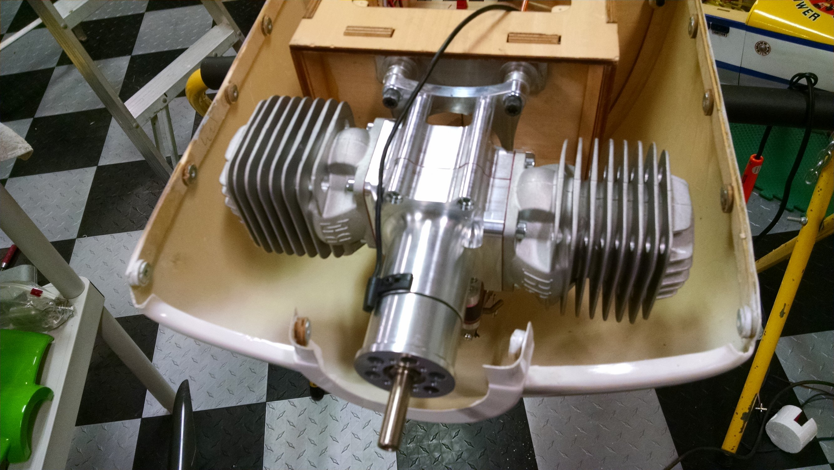

My engine showed up so I mounted it. It's a BE124
First I used my old aeroworks engine template for DA / 3W. As its the same pattern. Then I figure out the spacing and used some PSP spacers plus I always use a alum bracket to space the load.

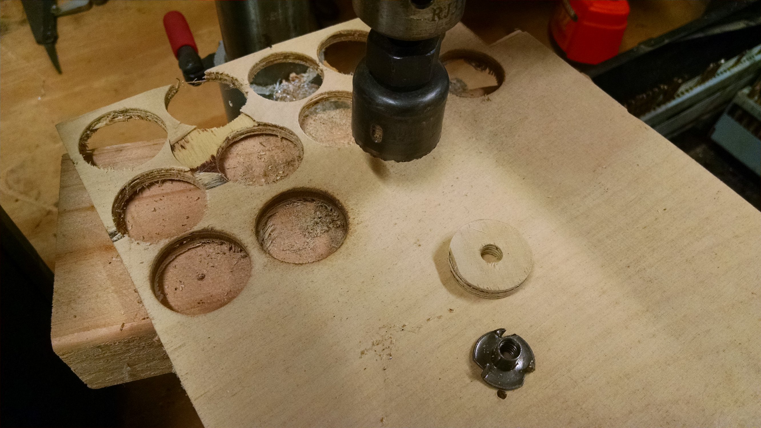

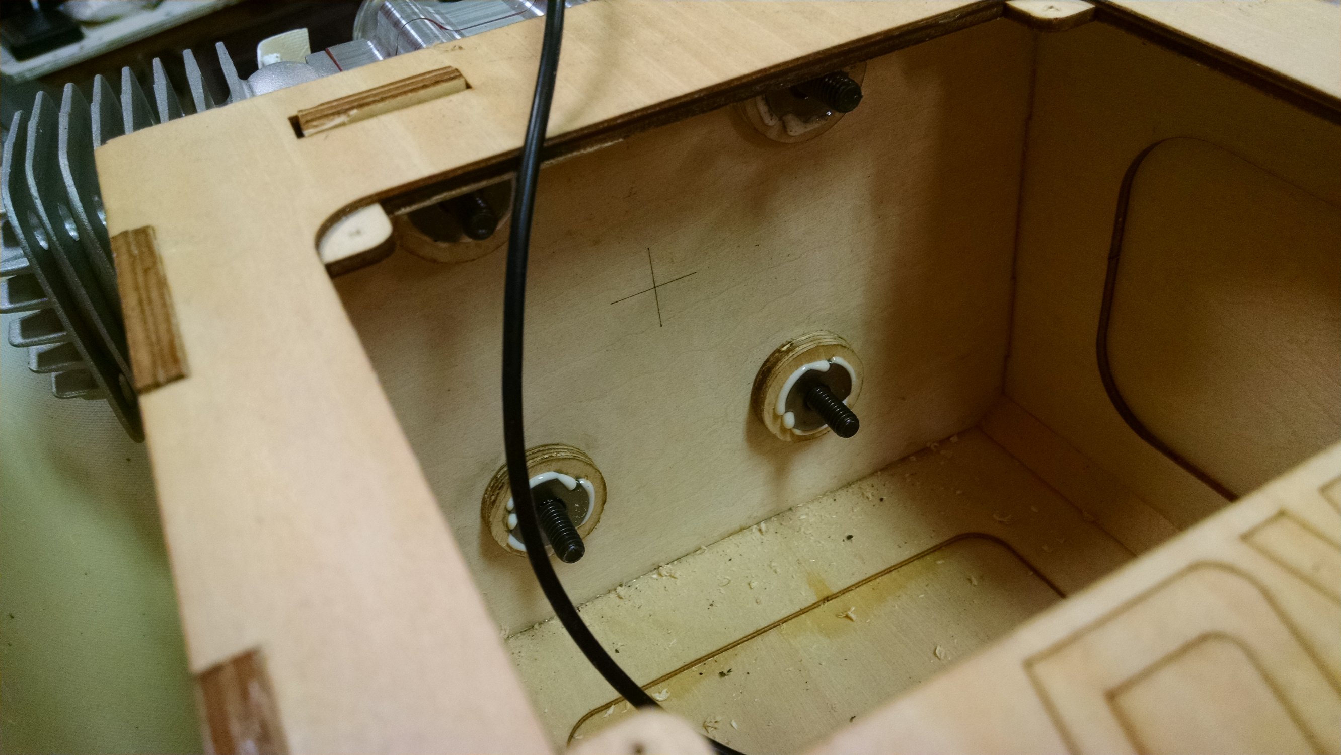

Then once it's all drilled out I make some wood mounts for my blind nit's. Simple with a hole saw.
