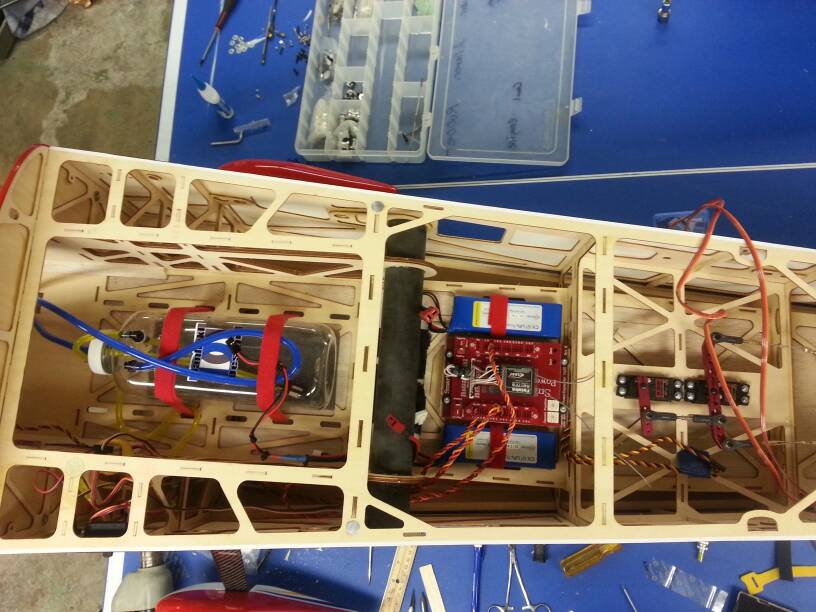

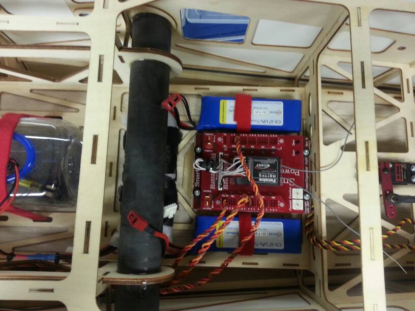

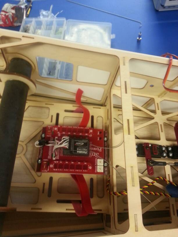

uploadfromtaptalk1396922928556.jpg installed smartfly board, decided to set two pieces of wood at either end to elevate the board and plan for batteries to mount on either side

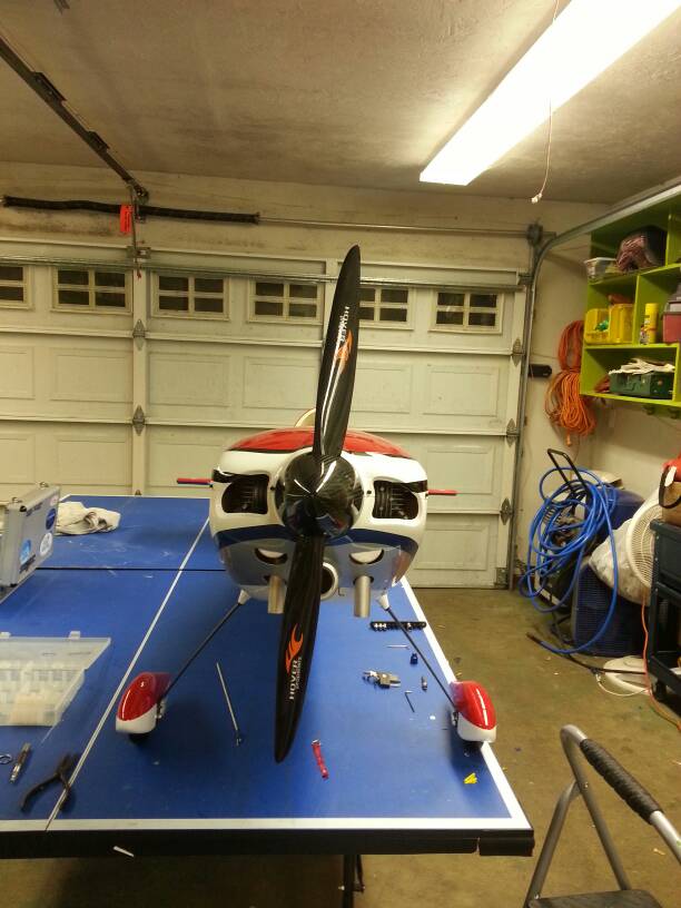

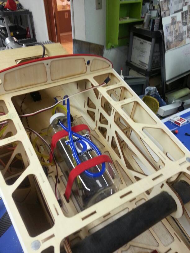

uploadfromtaptalk1396923066903.jpg just thought I would throw in a picture of the mayhem on saturday afternoon sometimes you got to just stop and clean up

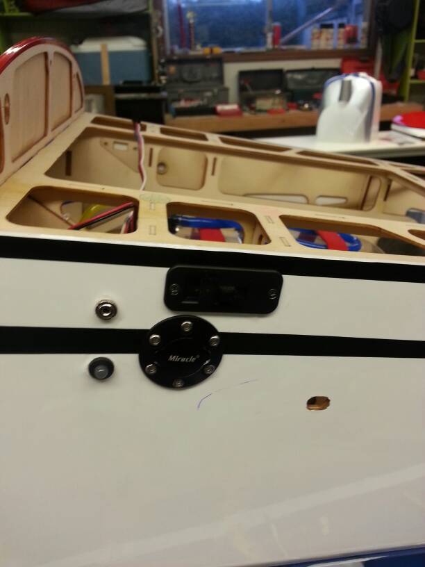

uploadfromtaptalk1396923157854.jpg I decided to put all the external controls right together and I think it turned out well, so you have the ignition power is the big switch ignition light is the led, radio power is the pin and flag and then of course your fuel dot

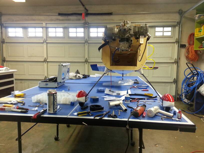

uploadfromtaptalk1396923456492.jpg cowl was a pain especially the top piece where it connect s to the fuse with the three Allen heads had to make a tool to reach the bolts

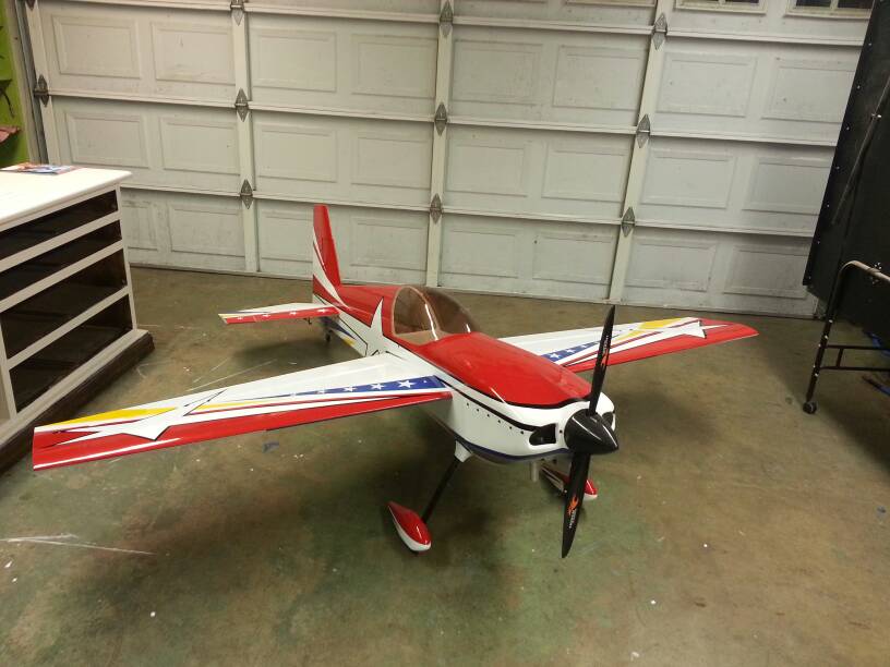

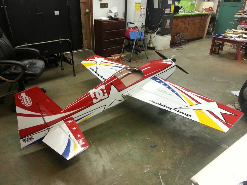

uploadfromtaptalk1396923559778.jpguploadfromtaptalk1396923612327.jpg ok here she is have to wait till next weekend for a maiden very excited next time I work on it I'll give you some final layout pics from inside
