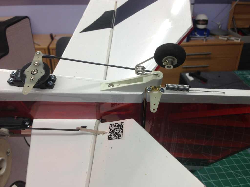

Tailwheel fixed with Sullivan. I considered using a spare 30cc 3DHS one, but this was 8 grams lighter.

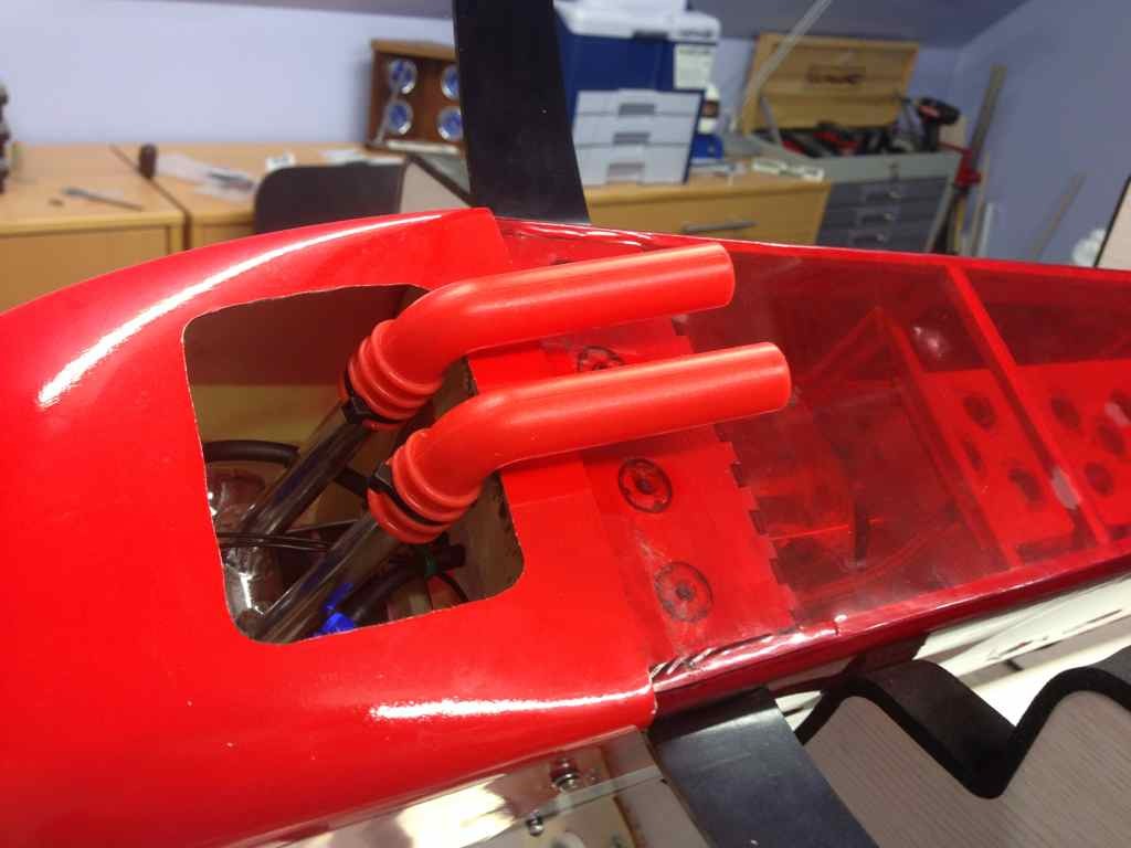

Exhaust extension to get the exhaust out of the cowl. These are car ones from Dynamite.
