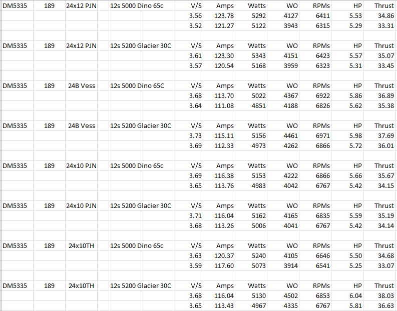

We would need at least 60 seconds of WOT data in order to compare apples to apples, but I'll take anything you can give me other that peak readings. I guess I can compare all peak readings too but this may end up being nothing more than comparing electrical anomalies.
Getting back to the Mejzlik data issue, I think I know what the problem is here. I sent out three props that are making their way around the country, and Tim was testing these first along with some of his own. He's been sending results as he gets them, and perhaps he mislabeled the 22x10E Mejzlik that I sent him. I thought it may be his own TH. I just emailed him to see if this is the case, so I should know soon. I would have to change the load constant to make that data viable, so anyone thinking that the motor can swing a 24x10TH Mejzlik to 6800 RPMs may be disappointed. I'll edit the post as soon as I know.
Probably not it either since the Amps are much too higher, and should be around 85A if it were the 22x10E.
The 24x10TH data is what I am most interested in as I ran that on my Q80 and all my 60cc gassers as well as Hoffman's.
