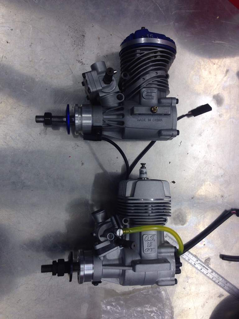

Got the GT15 in. Pulled the evo. Here is the weight comparison.
15GX 603 grams with plug
GT15 630 grams with CM6 plug
The perry pump and hardware was 30 grams so we are almost dead even in the swap. Just that the OS will put more weight foreword.
Since the OS ignition does not have the RPM lead I pulled the TM1000 and that was 17 grams plus the sensor plus the wiring. I will just have to use the tach. The boxes are the same, just they did not add that third wire.

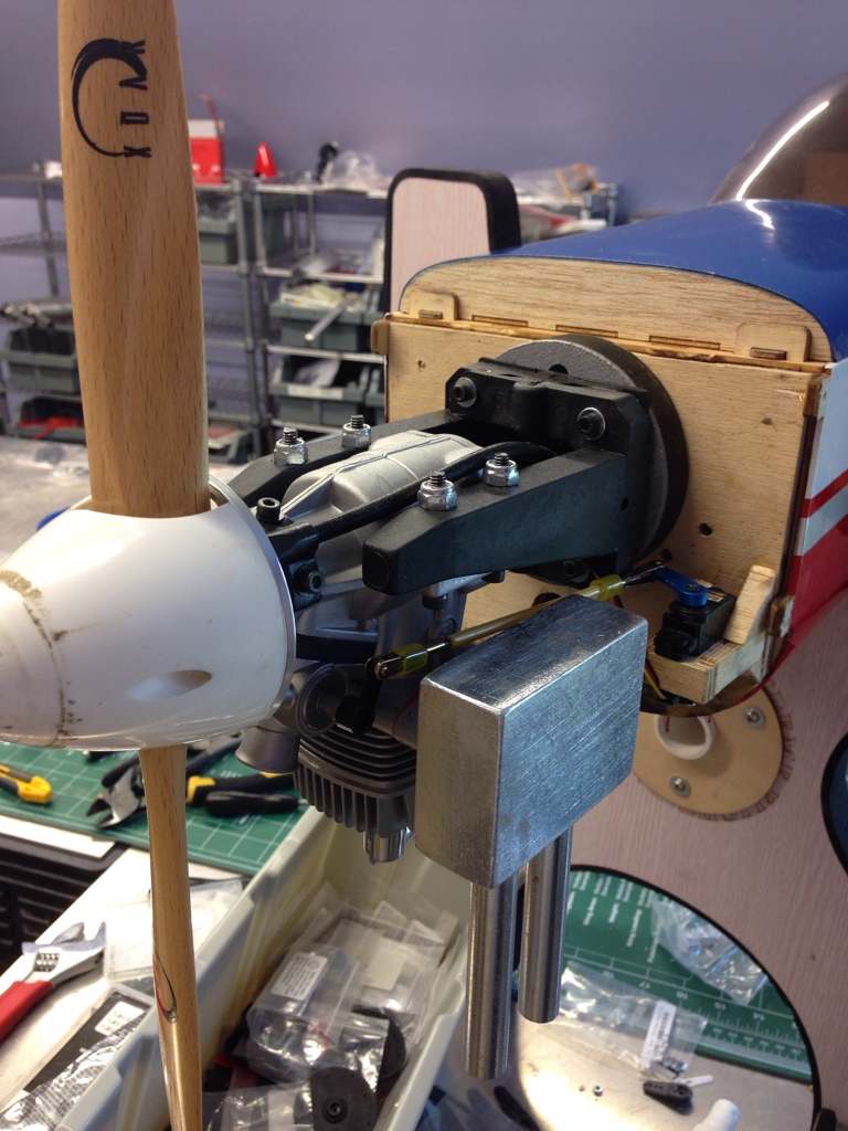

This will be an almost dead even swap in dimensions and arrangement so this should go quick.
I will make a platform to mount the gas tank aft to hopefully solve the balance issue.
