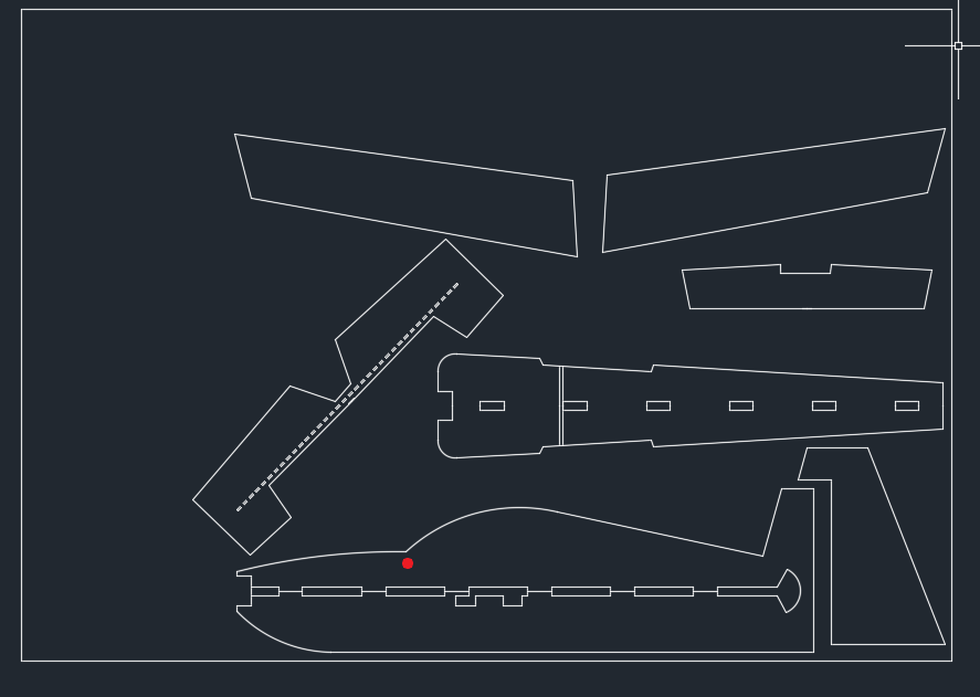

Hey snoop, have you maddened the 20cc yet? I'd like to know where your CG ended up. Thanks.
The plane is ready but no it has not been flown. Still have to clean up a few things first. But it will be flown soon. Have three planes waiting for maiden flights, the weather for last month has been rain and wind.
BalsaDust
Basically where I drew the red dot on my layout for the foamy version of this plane.
