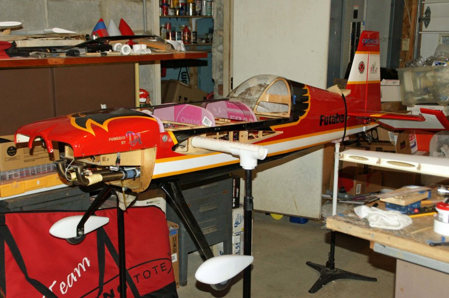

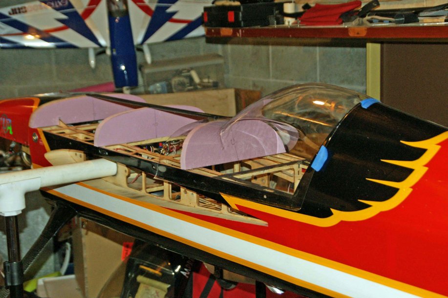

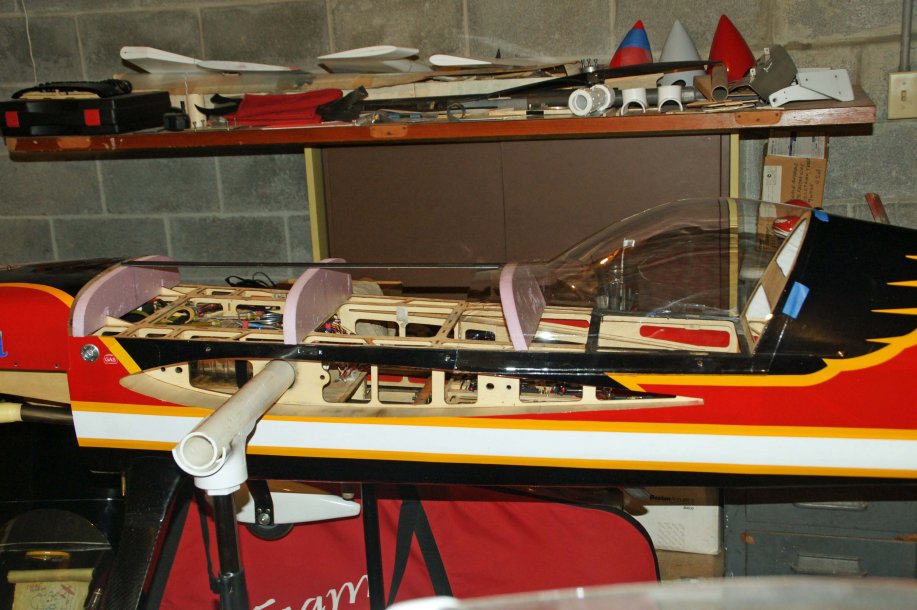

OK...since I put painting my Krill on hold (again), awaiting our move and my new heated shop (YAY) I thought I'd highjack my own thread for a little experiment on Cap't. Jack's Raven. So...here 'tis...
I really don't like the look of 2-place canopies on aerobatic planes, whether they are scale to the original or not. With the help of Rick (FiberTech) and Terry (Terry's Custom) I decided to make a new single place canopy for the 42% Raven. Rick had a nice canopy that will work perfectly and Terry gave me the inspiration after looking at his builds, photos and videos.
I'm just in the initial stages...canopy rough cut and some foam bulkheads cut. I plan on doing a combo of 1/8 lite ply and pink for the formers, plus a ply stringer/spine running along the deck center-line back to the canopy (where the ruler is). I'll use pink foam stringers inletted into the foam bulkheads for additional support for the balsa sheeting. Then light glassing over the balsa, fill and paint.
The pics just show some of the foam formers mocked up. Should be cutting some ply soon. In mt opinion the single place really changes the look of the Raven...for the better! Cheers
