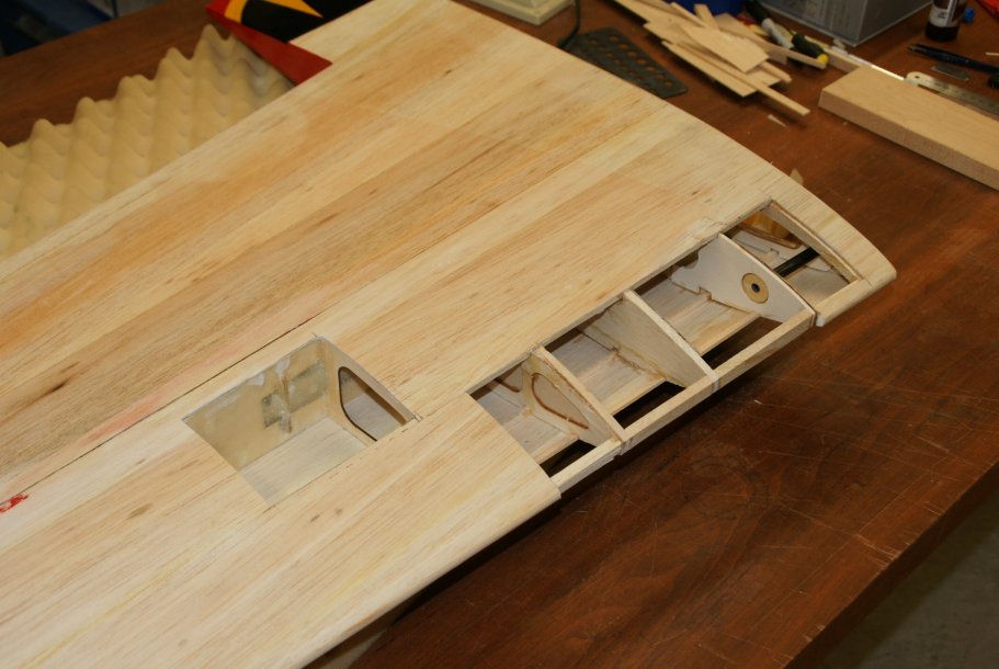

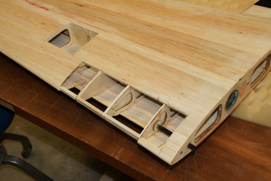

Mike...straight edges, rulers and eyeball! Seriously....that's how I do it, and make patterns on card stock (old cereal boxes work great). The main spar is carbon tubing top and bottom with shear webbing between. The CF tubes extend into the box structure holding the large CF tube. Interestingly that was all glassed in place at the factory!what do you use to pattern the replacement ribs, especially out near the end where each rib is a different size?

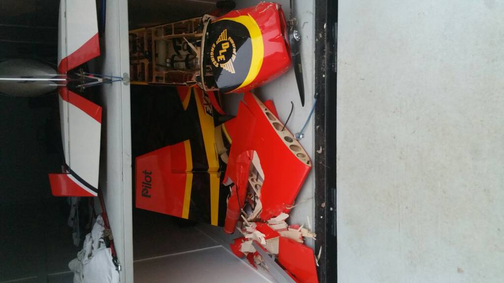

HAHAHA!!!! you funny man Dave...or Ken? Was that from your Aurora Tx issue?????U want another one to doView attachment 47743
Kenny, yep sure was, but i got two replacements for this year so im good.HAHAHA!!!! you funny man Dave...or Ken? Was that from your Aurora Tx issue?????
